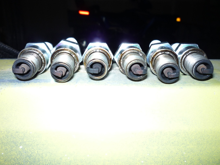

April 10, 201410 yr Author comment_445543 Here is a pic of the plugs I just took out after 50 mi. trip. They had been removed and cleaned up with a brass brush prior to the trip. So along with everything else being considered I am beginning to believe Fastwoman is right this thing is running very lean, next up I'll put in a pot to see what happens. #'s 1,2 and 4 look almost about right. Mike Edited April 10, 201410 yr by mjr45 Link to comment https://www.classiczcars.com/forums/topic/48980-efi-fuel-pump/?&page=3#findComment-445543 Share on other sites More sharing options...
April 11, 201410 yr comment_445549 Hmmm...those don't look lean to me. 3rd from right looks extra rich. You should see mine! Mine are too lean, according to the plugs. Nearly white like new! Link to comment https://www.classiczcars.com/forums/topic/48980-efi-fuel-pump/?&page=3#findComment-445549 Share on other sites More sharing options...
