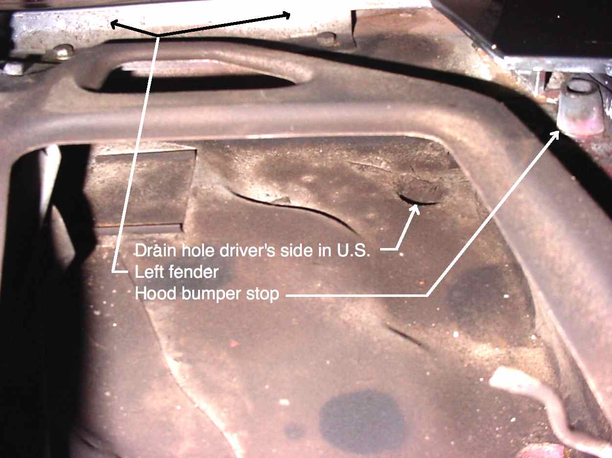

May 21, 201410 yr comment_448234 You mentioned that the only rust issue you've found are in the floor board areas. It's very likely that you have a leak in the cowl area and the water found it's way down the inside of the firewall and under the sound deadening material. This is a very common problem. The cowl drains clog and water stands in the cowl area and gets into the passenger compartment via some areas inside the cowl that didn't get sealed well from the factory. I would check this soon if I were you. You could have some serious rust issues in the floor board/foot well area that have only just begun to present themselves. Great car. Good luck.Where are those troublesome cowl drains? Like under the grille in the exterior cowl? Link to comment https://www.classiczcars.com/forums/topic/49023-new-owner-of-a-very-early-240z/?&page=3#findComment-448234 Share on other sites More sharing options...
May 22, 201410 yr Author comment_448274 Where are those troublesome cowl drains? Like under the grille in the exterior cowl? If it's anything like my 210 I had, they would exit down in the fenders. The water would drain down the cowl out of the drivers side and passenger side inner fenders, but they clog with dirt and trash, so the water would collect in the cowl. I got the car home last night! We wrestled the glass into the hatch for about 3 hours until we were able to make it fit. I drove the car this morning to work and it presented a few issues. I have a clunk accelerating that needs to be addressed. We just put good axle shafts in, and the driveshaft joints felt tight when i was under it so I'll have to look at the rear end tomorrow. The car was running pig rich, so bad it would hurt your eyes and at 4000RPM or under heavy loads (up hill at heavy throttle) it would cut up and billow black smoke from the pipes. I balanced the carbs out by ear and with my hands for the time being, and set the timing and she runs like a top!! First picture after her bath for now. Link to comment https://www.classiczcars.com/forums/topic/49023-new-owner-of-a-very-early-240z/?&page=3#findComment-448274 Share on other sites More sharing options...

May 22, 201410 yr comment_448295 This picture of a drain hole on the left side of the car was taken with the cowl removed. I think this is my car before I did any anti rust in this area. Edited May 22, 201410 yr by Mikes Z car Link to comment https://www.classiczcars.com/forums/topic/49023-new-owner-of-a-very-early-240z/?&page=3#findComment-448295 Share on other sites More sharing options...
