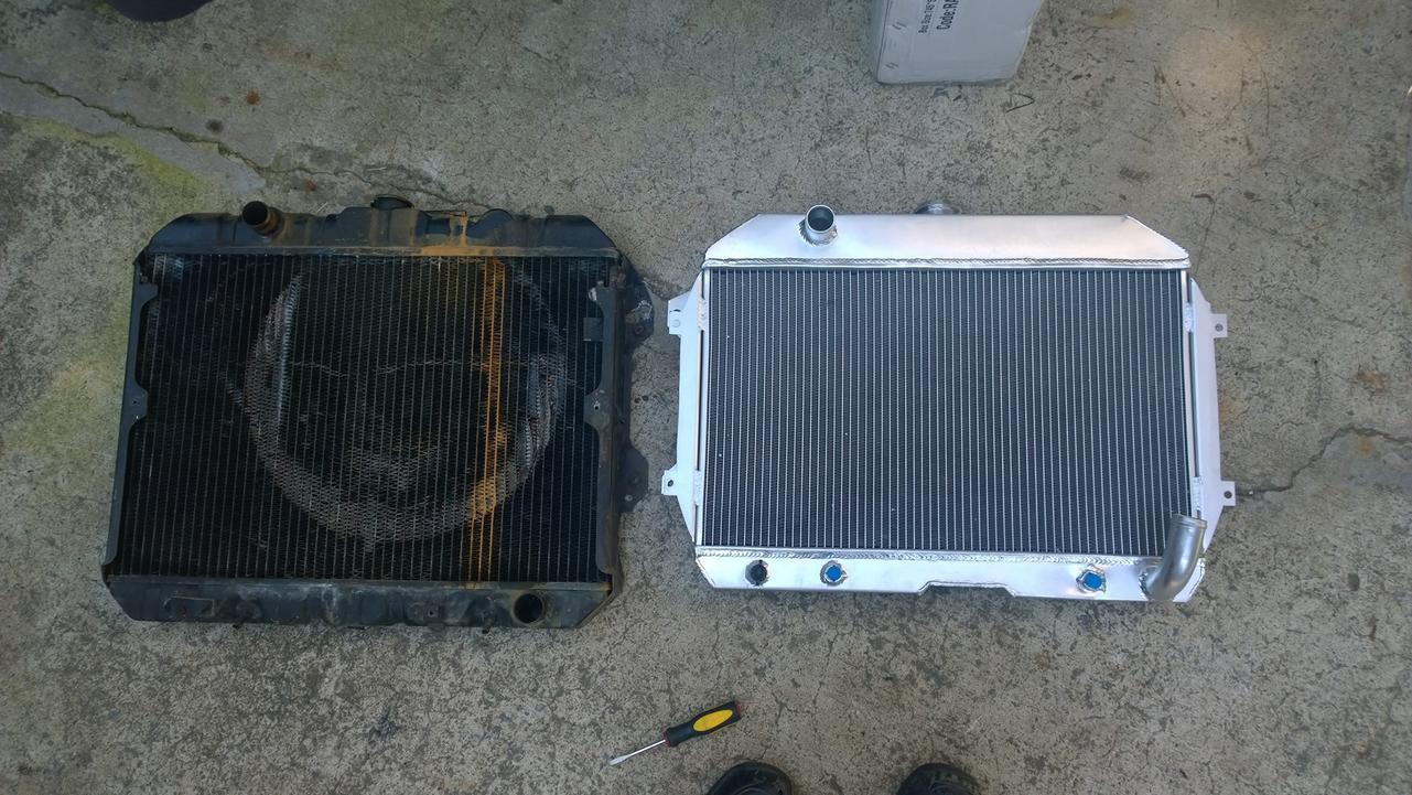

June 24, 201410 yr Author comment_450363 Not sure if you checked, but the dimmer for the lights is on the right side of the steering column. Mine was hidden by the aftermarket A/C control so I thought the same thing. I just bought it, so rookie mistake and put a smile on my face when I rotated it and tada, dash lights worked. The knob on the other side is the mileage reset knob. Pretty cool. I'll try and get mine posted soon as well. '71 as well. I literally had NO idea what either one of the knobs did under the dash until Ir read that, WOW! Alas, it didn't fix the issue, but damn did it make me feel a little less stupid. Matt, bring it by my house. If the wiring was messed up too bad by IPOs, I can help you with the gremlins quickly. I will surely take you up on that offer once I get this thing running better. I thought i'd share a little update. I'll be back with many more pictures, but man I love cheap radiators. $131 on Egay, not the best quality but by far better then the busted one I had. Link to comment https://www.classiczcars.com/forums/topic/49023-new-owner-of-a-very-early-240z/?&page=4#findComment-450363 Share on other sites More sharing options...

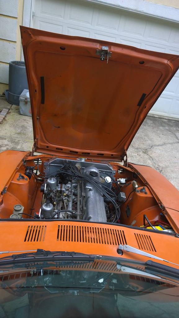

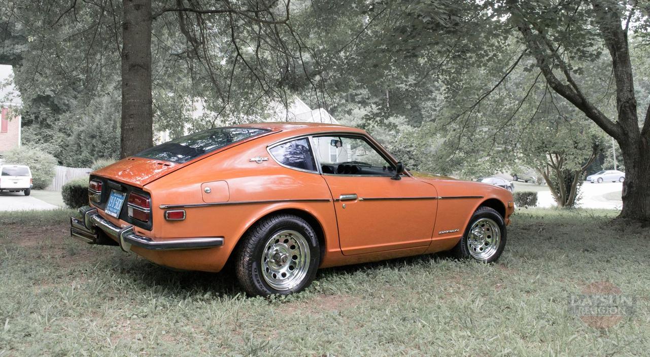

July 20, 201410 yr Author comment_451895 Just wanted to share some pictures of my recent progress Hope you guys enjoy! _DSC0521 by metalmonkey47, on Flickr Lucy by metalmonkey47, on Flickr Lucy by metalmonkey47, on Flickr Lucy by metalmonkey47, on Flickr Link to comment https://www.classiczcars.com/forums/topic/49023-new-owner-of-a-very-early-240z/?&page=4#findComment-451895 Share on other sites More sharing options...
July 20, 201410 yr comment_451896 Lookin better all the time ..... great progress! Link to comment https://www.classiczcars.com/forums/topic/49023-new-owner-of-a-very-early-240z/?&page=4#findComment-451896 Share on other sites More sharing options...

July 20, 201410 yr comment_451909 great progress ! I would use a bottle of mequairs ultimate compound and some towels, spent an afternoon polishing it up, and that paint will look way better , worked great on mine. Link to comment https://www.classiczcars.com/forums/topic/49023-new-owner-of-a-very-early-240z/?&page=4#findComment-451909 Share on other sites More sharing options...

July 20, 201410 yr Author comment_451916 You are going to be at C&O in two weeks, right? Yessir! Unless something at work comes up I'll be there! great progress ! I would use a bottle of mequairs ultimate compound and some towels, spent an afternoon polishing it up, and that paint will look way better , worked great on mine. Actually, I've used the Meguires Ultimate Compound and Polish, then Waxed with the same stuff. Turned out great! Only issue is that It tends to fade quickly and water-spot easily. I don't know if it's Georgia's acidic rain, or an issue with the pain but unless you polish often it tends to look like crap after a wash. Link to comment https://www.classiczcars.com/forums/topic/49023-new-owner-of-a-very-early-240z/?&page=4#findComment-451916 Share on other sites More sharing options...
July 20, 201410 yr comment_451926 metalmonkey47 - - you are seeing / experiencing the effects that happen, when the top layer of an older formula enamel has been polished off. While you still have a color coat below that top layer of paint - you no longer have the density of paint solids that originally formed in that shinny top skin layer. Time for a new paint job..Carl B. Link to comment https://www.classiczcars.com/forums/topic/49023-new-owner-of-a-very-early-240z/?&page=4#findComment-451926 Share on other sites More sharing options...
