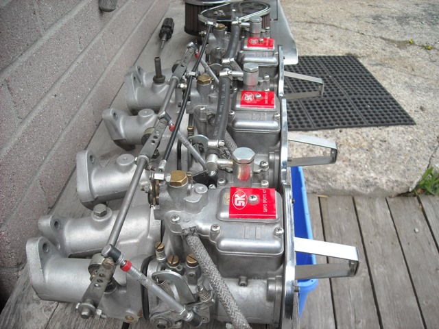

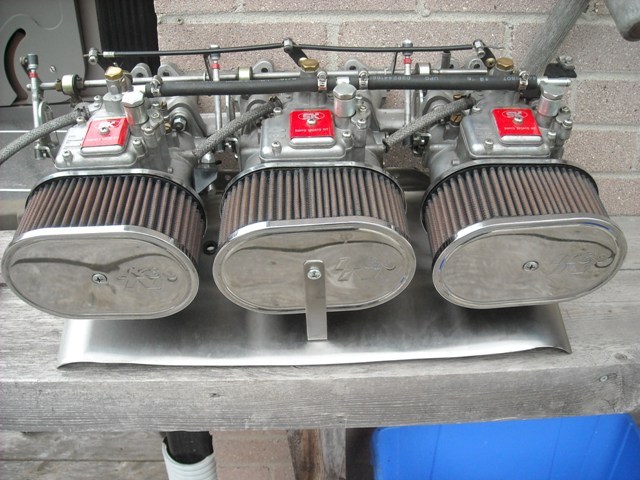

Spent some more Juan-On-Juan time with the Carbs, with the help of a local carb shop. Turns out 5/6 of the Accelerator pumps were in bad condition. Yikes!
I had measured the float height and adjusted them accordingly. Car actually runs much, much nicer now, but doesn't like anything past smooth throttle. Now I know why.
These carbs aren't mine. I'm just the temporary custodian of them. A friend of mine owns them, hence their wonderful condition. I wanted to buy my own carbs, but I'm really interested in the OER/SK Japanese ones. My engine's builder, Eiji Hosomi, spent a good 15-20min with me over the phone explaining some of the reasons why he absolutely dislikes Weber Carbs - and he made some great points.
The Japanese carbs don't seem to work much differently, and when they do it's for the better. No emulsion tubes to deal with, the mixture of the accelerator is adjustable externally and so are the floats. Sounds a lot more practical to me...
Anyone have any experience with these? I'm seriously considering picking up a set to keep the engine "Japanese" entirely.
I had a set of SK/OER 40's for a few years, I really liked them. The externally adjustable float level and accelerator pump are a nice feature while you are setting them up and for tweaking. Much better then pulling everything off and removing the top cover like Webers, but they most certainly do have emulsion tubes, in fact they accept Weber e tubes and jets. Maybe you just mis heard what he said. They are a good set up and if you are starting fresh then SK's or Mikunis would be the way to go.
