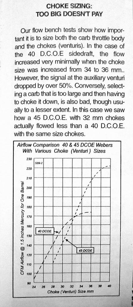

April 20, 201411 yr comment_446203 45's would be better for 2.8litre because you can expand air flow easier if you bore the block in the future. Chokes (venturi) from 32 - 34mm are recommended for l28 and 45dcoe. 32 gives more lower end torque. 34mm is recommended limit for 40dcoe. see chart below 33mm choke is crossover point where 45 starts to outperform 40 with same choke size Link to comment https://www.classiczcars.com/forums/topic/49068-triple-weber-40-or-45/#findComment-446203 Share on other sites More sharing options...
