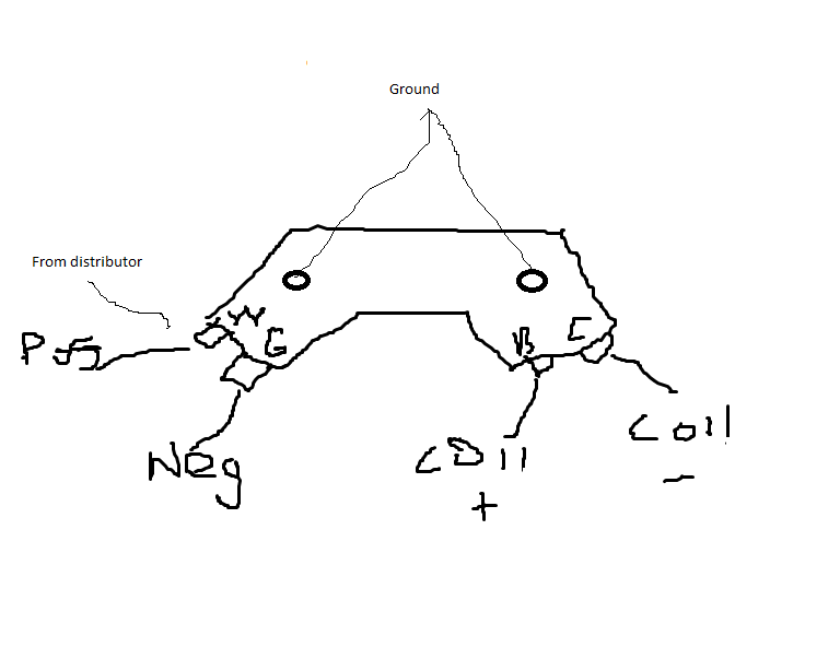

April 25, 201411 yr comment_446607 Considering the time, effort and aggravation you've spent so far, maybe a trial of a GM HEI module would be worthwhile. $25 and some wiring versus $75 for a new ZX module. High RPM weirdness is a typical failing module sign. It could also be the distributor though. Have you checked the gap between the iron rotor and the pickup points? Described n the 79 FSM. The rotor needs to be perfectly centered. The pickup coil magnet tends to break on the ZX distributors also. I've seen it but don't know if they still work when broken.If you're not in to wiring or electronics, maybe $100 for a spare distributor would be worth the money. Or, maybe you could borrow a spare from somebody. Link to comment https://www.classiczcars.com/forums/topic/49115-still-having-issues/#findComment-446607 Share on other sites More sharing options...

April 25, 201411 yr comment_446613 The old 75 distributor will work great with the GM module. Here's a diagram that I spent a few days putting together. Connect the red wire to W, the green wire to G, and B and C as shown. Make sure that the mounting grommets are electrically grounded. Missed the internal part. There's not enough room inside for the GM module. But, if I was going to do another one I might mount it in the cabin where the old ignition module was. The red and green wires from the distributor run all the way there, along with the old coil positive and negative wires. You might need to fabricate a mounting plate. It would take some time with the wiring diagram. For a test though, it might be simpler to just run jumpers from your ZX distributor. You can take the ZX module off of the side and the two wires you need will be right there. Choices. Edited April 25, 201411 yr by Zed Head Link to comment https://www.classiczcars.com/forums/topic/49115-still-having-issues/#findComment-446613 Share on other sites More sharing options...
April 25, 201411 yr Author comment_446614 Thanks Zed. I'll have to dig thru my boxes of Z stuff and find the old dizzy. What can I use for a heat sink and being real electrical savvy, how much of the module has to be covered by it?Mike Edited April 25, 201411 yr by mjr45 Link to comment https://www.classiczcars.com/forums/topic/49115-still-having-issues/#findComment-446614 Share on other sites More sharing options...
