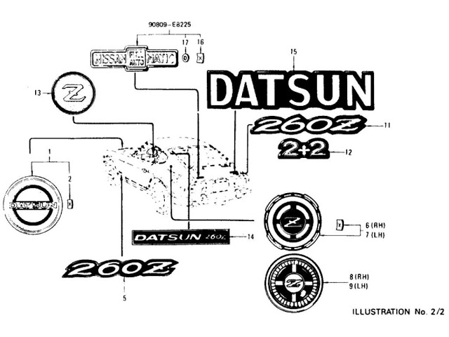

My badges are pretty beat up and are still removed except for the side roof pillar badges which are the top example on that illustration. Are you having trouble determining which badge goes where?
heres an accurate picture of how the emblems look.

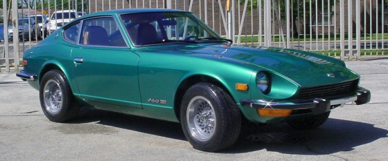

1. Fender emblem with yellow backed Z behind front wheel

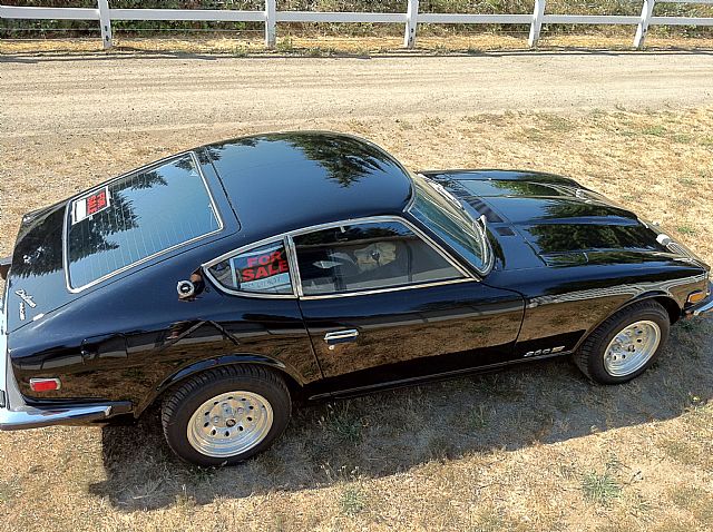

2. Round Z emblem on rear roof pillar, just behind side window
3. rear hatch facing sky has the diagonal Datsun emblem, with 260z emblem underneath parallel
4. The hood emblem is centered on the front of the hood (2nd image)
5. The round Z logo goes on the center of the steering wheel
5. The rectangular datsun logo goes above the glovebox on the dash
