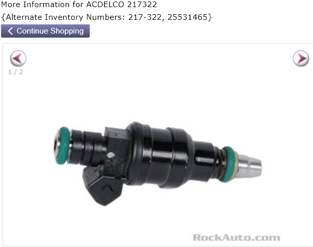

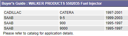

I did a search on RockAuto for the part number @HusseinHolland provided. A Walker fuel injector crossed with that part number. Here is the applications list they had for the Walker part.
Now given that the Catera was developed from an Opel, I don't know how much carried over from the Opel powertrain.

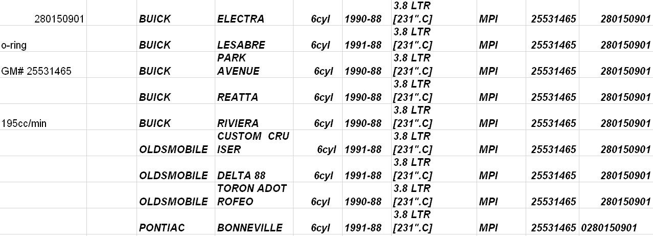

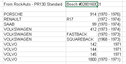

Here is a GM injector I ID'ed in the past as possible.  I pulled the data from various sources and stuck it in a spreadsheet.  I got a new computer and Microsoft is holding the spreadsheet functions hostage so all I can do is an image for now.
A person really needs an adjustable regulator to get things dialed in.  Since you have to lean things out.

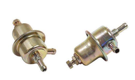

I've mentioned this before also, somewhere.  You can take an old Bosch/VW/Porsche adjustable regulator and drill a hole through the center of the adjusting screw to add a vacuum reference hose.  There was an old VW dune buggy article about it on the web.
Notice the 001 number.  Might be the first adjustable from Bosch as they got in to L-Jet.  Still available.  Spendy, unless eBay.  It holds pressure too.
https://www.pelicanparts.com/More_Info/0280160001.htm?pn=0-280-160-001-INT

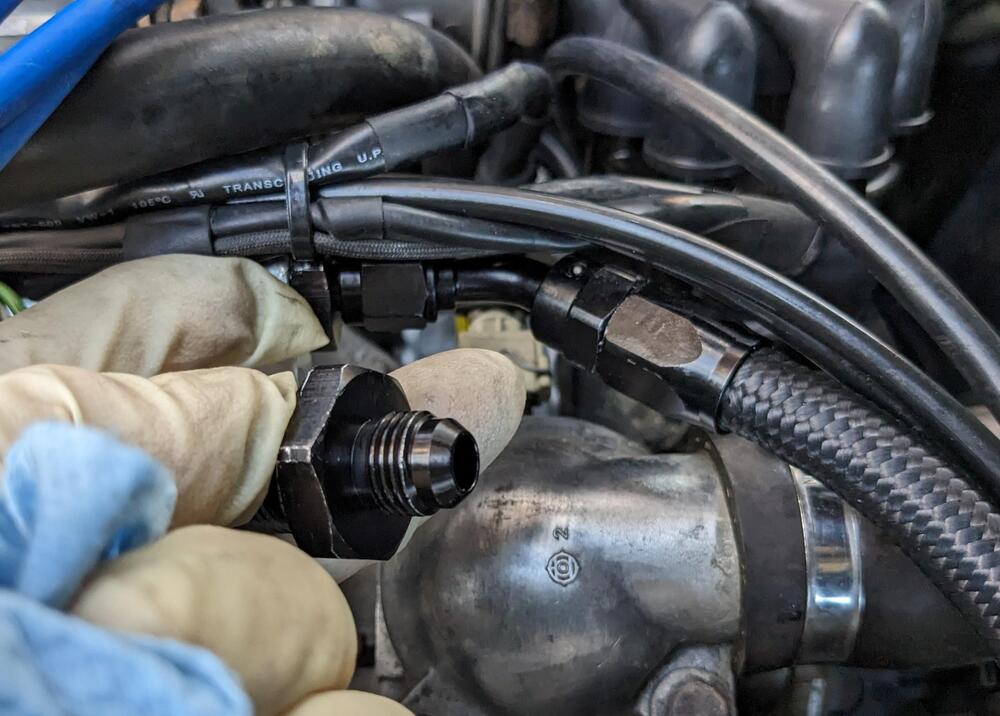

One of the ORB-8 to 6AN adaptors provided with the rail wouldn't seal in the AN line fitting, I had gas seepage. Swapped it out for the other one they provided & it's all good

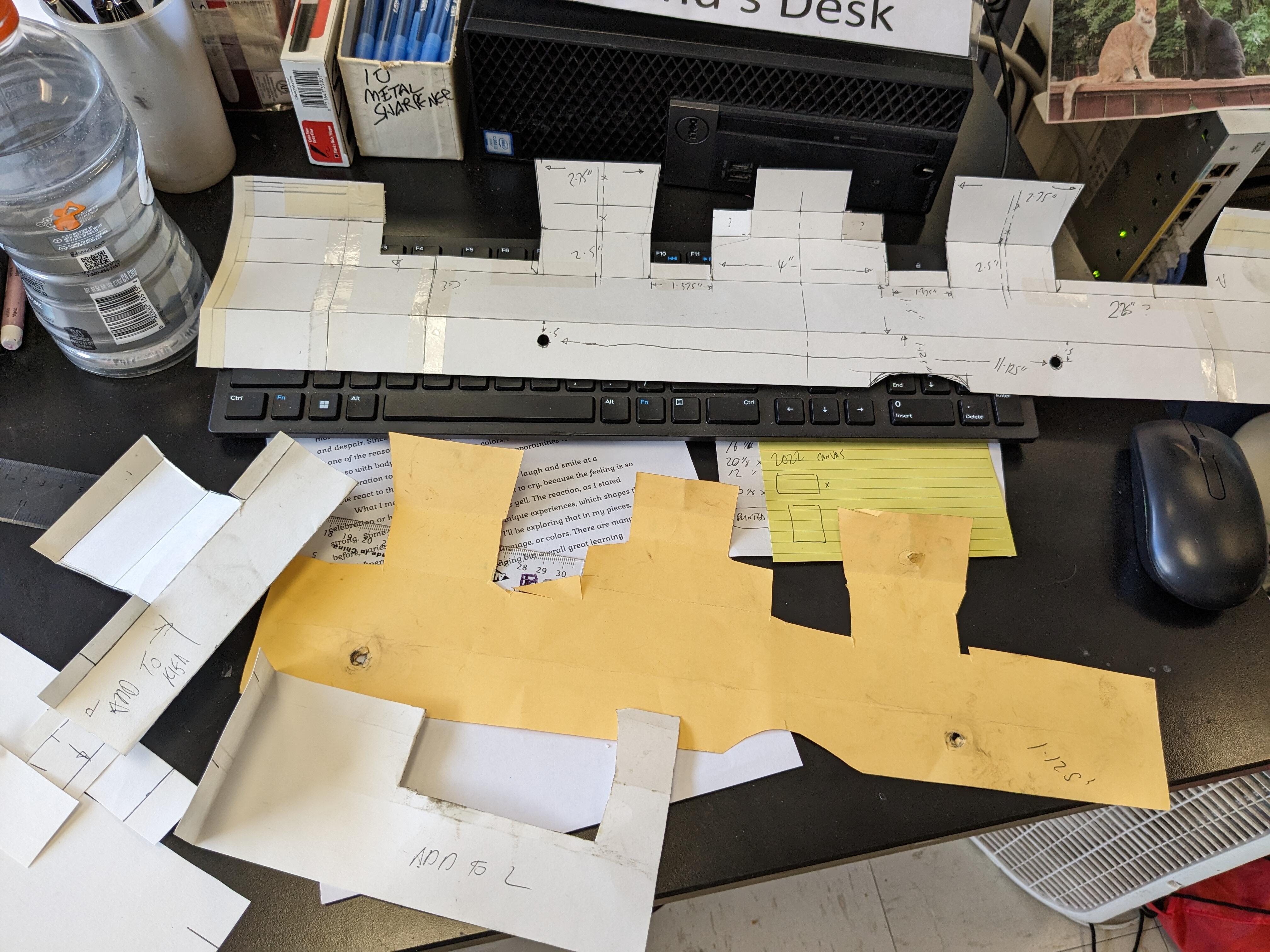

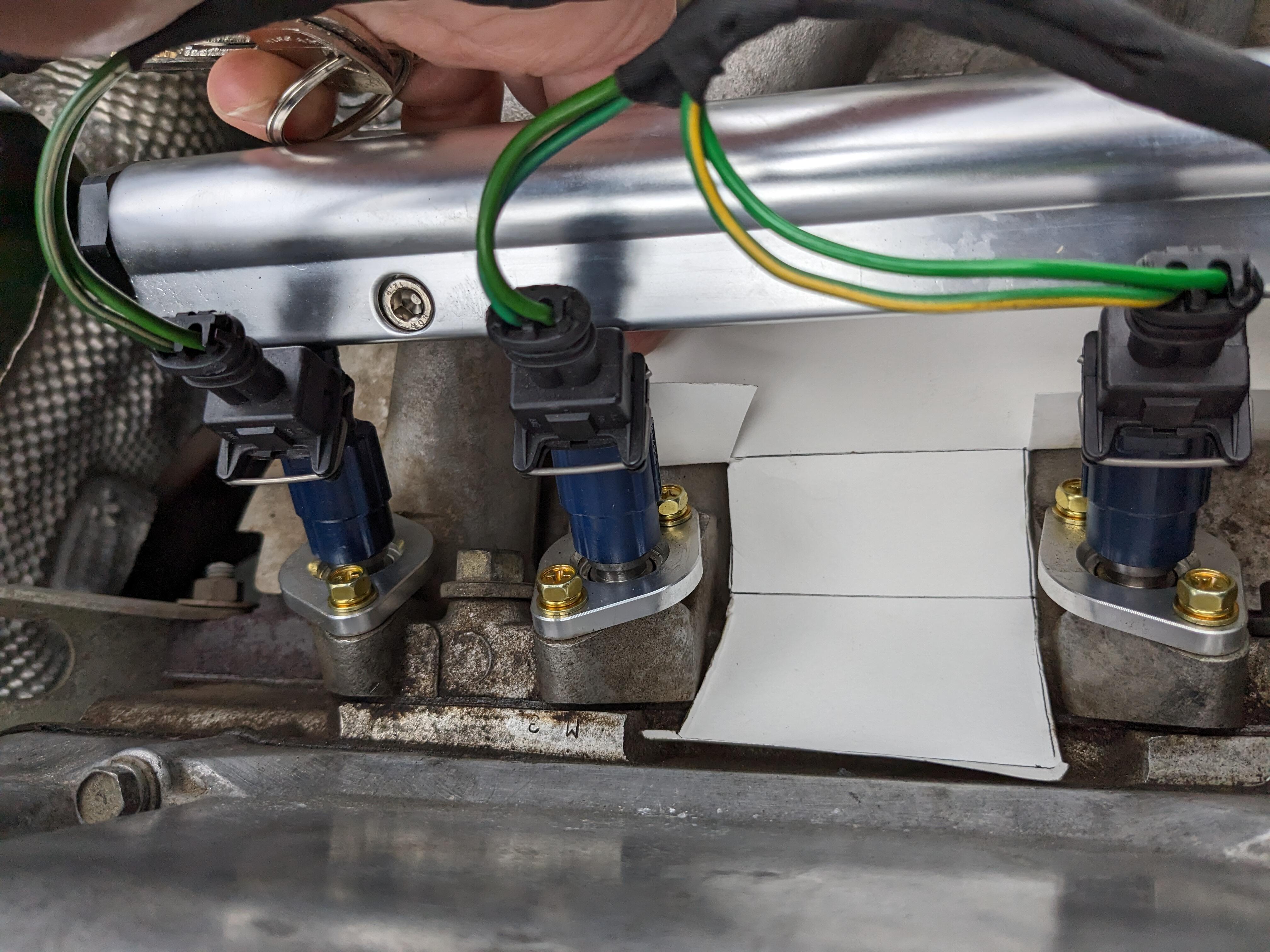

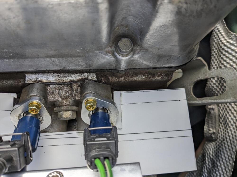

Working on the heat shield template

Yes - I haven't experienced it today, but I didn't drive it under the conditions that previously instigated the heat soak. See what happens over the next couple days. I'm going to make the additional heat shield anyway.
