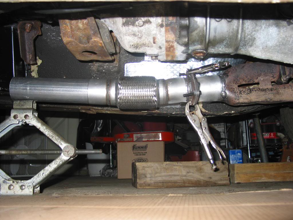

The rear stud usually breaks after the transmission exhaust hanger is removed during exhaust replacement. The exhaust was designed to be rigid back to the rear hangers so that engine roll doesn't put load into the manifold studs. Once that trans hanger comes loose or is removed, the stud will regularly break. The best bet is to make sure that hanger is in place and install a flex pipe in the system to help reduce stress into the system.
Here is a picture of my flex pipe while I was mocking it up. You can see the trans hanger at the left side of the picture. It was in terrible shape, so I fabricated a new section to fit with my exhaust. I installed the flex pipe to ease the stress on my race motor and mate the MSA exhaust to my freebie header.
