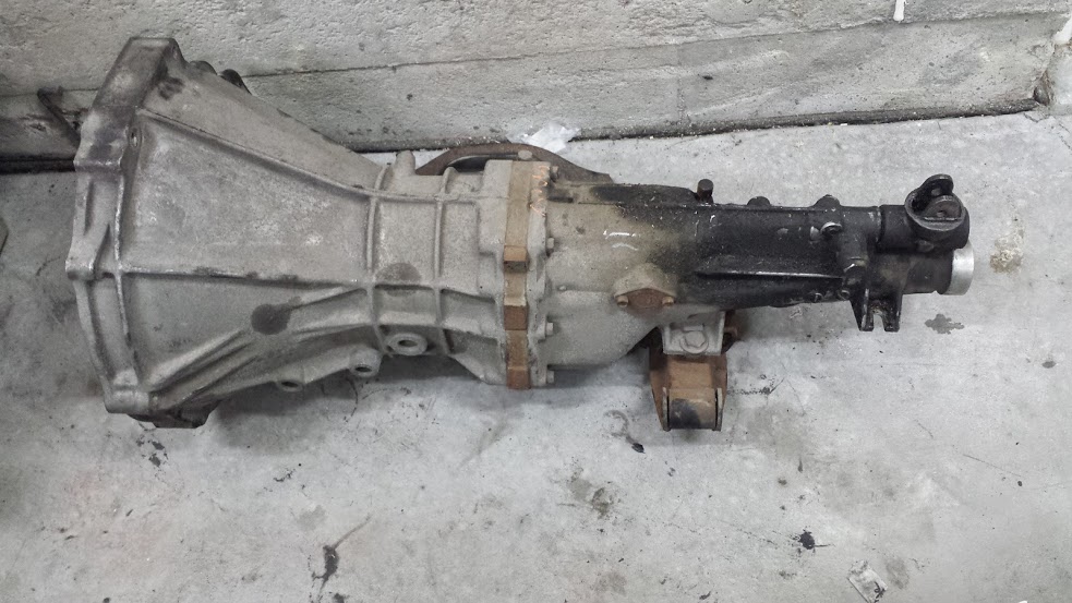

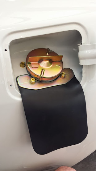

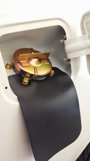

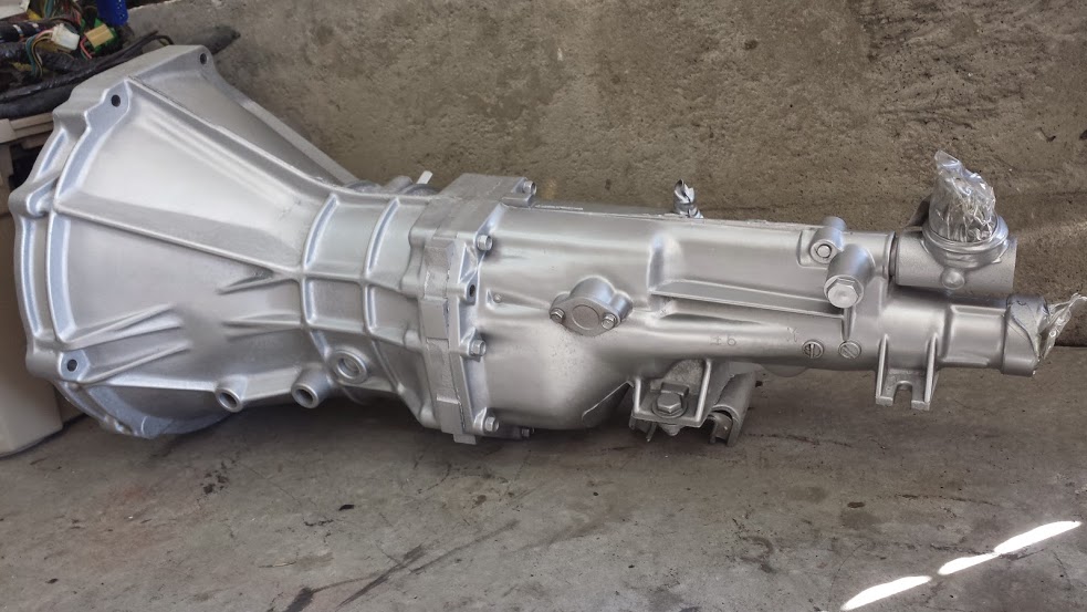

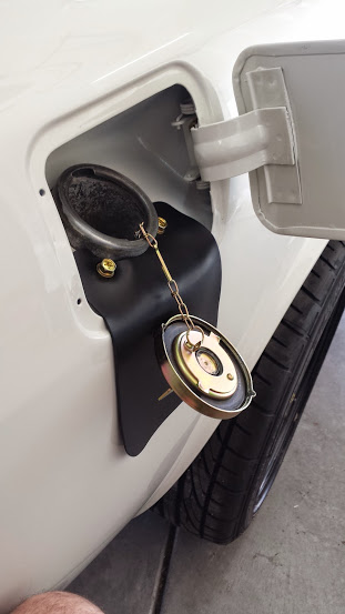

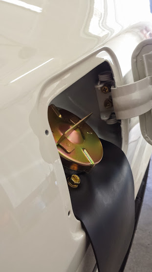

August 9, 201410 yr Author comment_453039 Cleaned up and painted the 5 speed today. Looks brand new again! Installed filler tube and replated gas cap and chain. Also put in a new rubber flap. Edited August 9, 201410 yr by HaZmatt Link to comment https://www.classiczcars.com/forums/topic/49193-my-datsun-280z-rustoration/?&page=12#findComment-453039 Share on other sites More sharing options...
