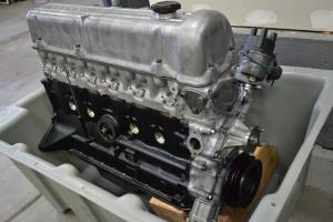

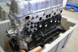

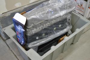

Well....my motor showed up today. Not sure if I should be excited or pissed off. I guess a little of both. My entire interaction with Rebello Racing has been absolutely awful.
 First off, this isnt even my block. Different numbers. I told him in the beginning that I wanted it to remain a "numbers matching" car so I would like to use my block. Which I know this isnt a huge deal, its not like its a concourse car but still, I have no idea why he switched blocks on me.
Second. Absolutely ZERO communication! The only time I talked to him is when I would call him and ask how things are going. I didnt even get a call from him to tell me that it was done! The shipping company called me.
Third. Absolutely ZERO paperwork. No dyno sheet (even after I asked him for one), No receipt, no invoice, no spec sheet, no anything! Ridiculous!

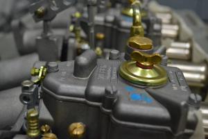

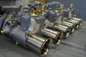

I can go on and on......valve cover is leaking, missing parts (engine hoist brackets, intake manifold studs, etc). And all of the bolts on the carbs are barely finger tight. So I know these carbs weren't used on a dyno or tuned for this motor like he said. I doubt the motor was even dyno'd. I paid nearly a $1000 to have him dyno and tune the motor!
Also he told me 6-8 weeks, hahaha. 8 months it took. And he charged me well over the original quoted price!
Im not sure what to do, I guess i'll just put it in and get it tuned somewhere local. Its just frustrating that I waited so long and paid big $$$ and feel like Ive been ripped off. I just hope the motor runs as good as his reputation is.
Ayways heres some pics.

I can imagine you not being very happy (borderline freaking out) after reading all that you have gone through.
Just wondering what preperation work is done to the head. Doesn't look chemical cleaned with the rust colourin the water jacket. For all the time and money, you would expect a complete package.

Thank you everyone for your concern. Okay, after taking some time to calm down and having a few drinks...I called Dave at Rebello.
 Apparently my block that I sent to him wasn't usable due to the cylinders needing to be bored to far. After being bored out the cylinder walls still had pits in them. So he made the decision to replace the block. Which I am ok with, I just wish he would've called and told me.
 He also emailed me my receipt and dyno sheet. He assured me that these carbs were used during the dyno, just with a different intake manifold. That would explain the loose nuts. I can also smell fuel in the carbs.
 So I may have over reacted a little, he was and has been friendly on the phone he just seems like hes always in a hurry. This is also the first motor I've sent out to get rebuilt so I didn't really know what to expect. I guess all I would complain about would be the lack of communication and the time it took but as long as its a good product in the end.....I will be happy.
Here are the specs.
L28 with N42 head
3.0L Stroker
89mm Cast Pistons
L24 rods with ARP bolts
Turbo oil pump
63DI 109 Hot B Cam
Triple 45 DCOE Weber Carbs
Port & Polished head
Port matched intake
11:1 compression

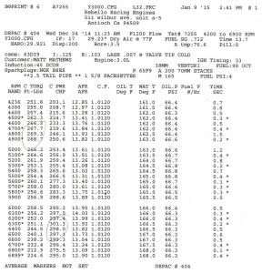

Dyno Sheet:
post-28616-0-02485600-1420864378_thumb.j
So...... nice solid torque from 4200 to 6500 and a peak HP of over 300. I'm beginning to get excited again!   :D  :D
