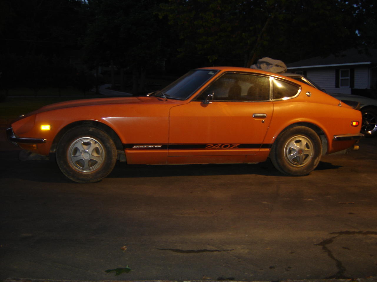

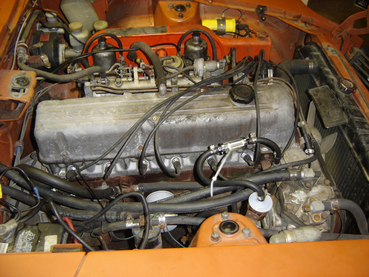

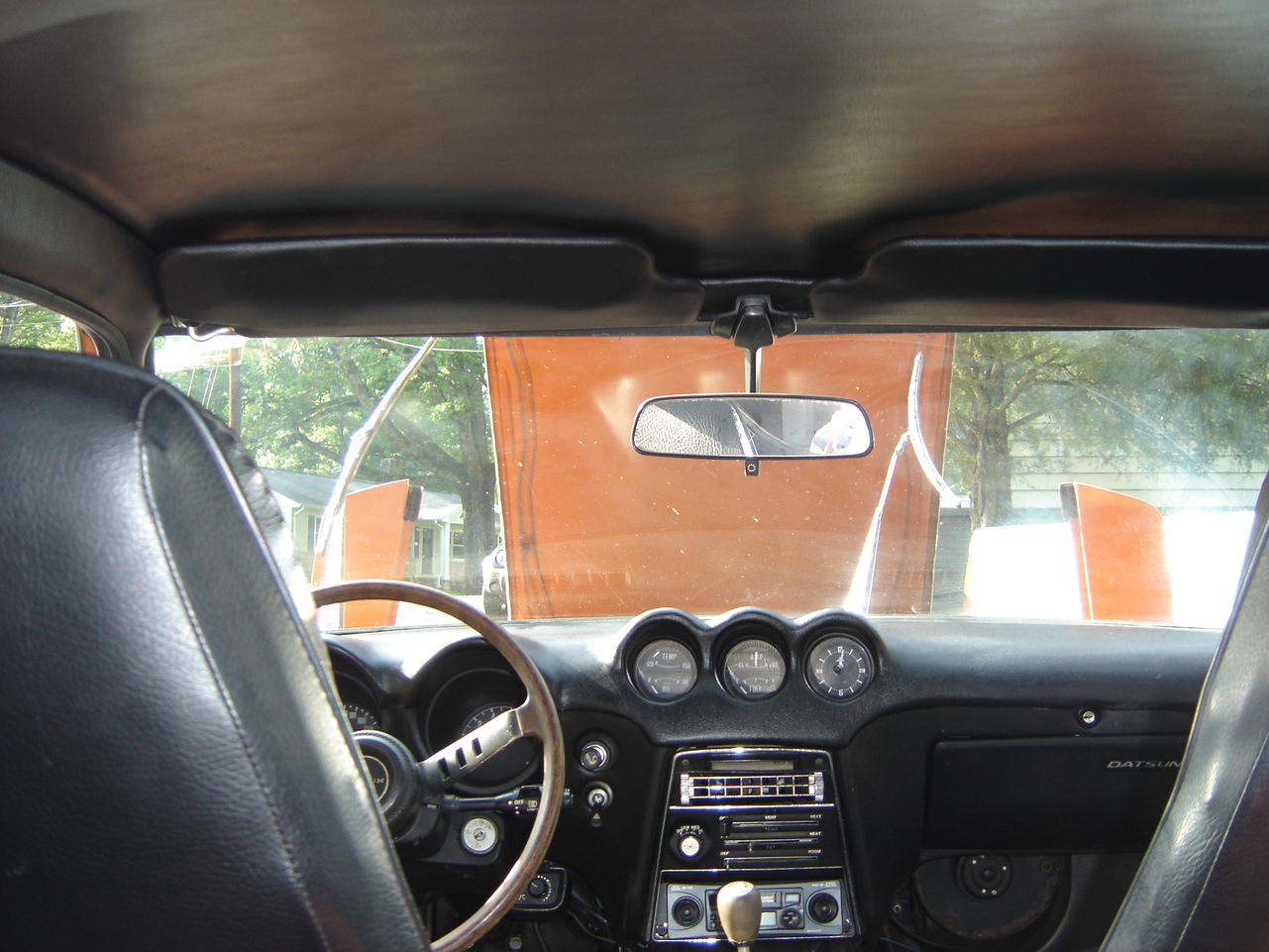

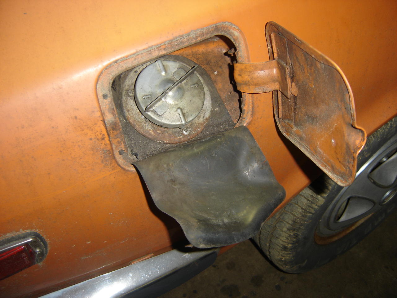

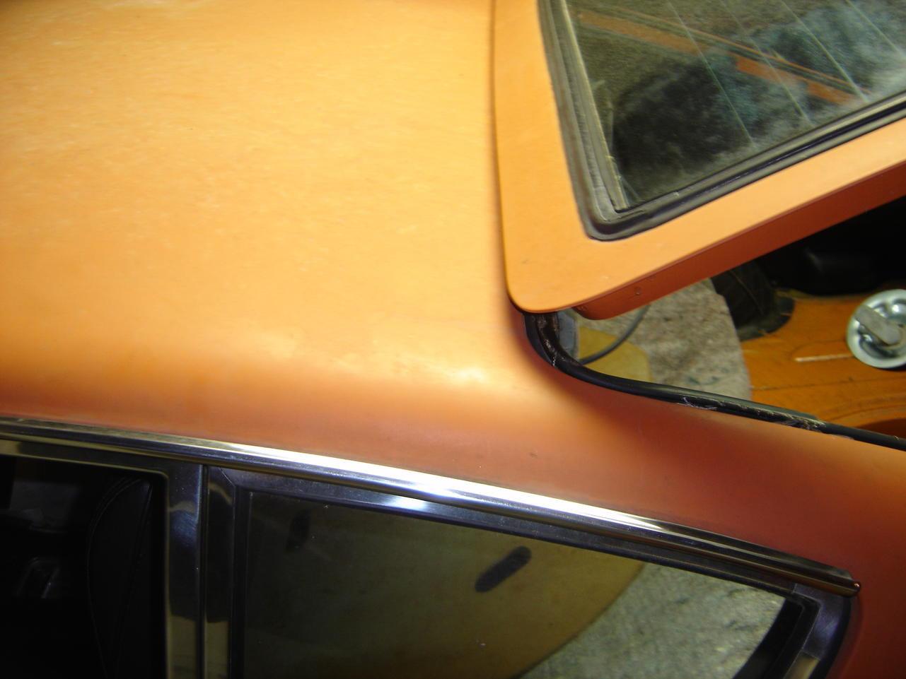

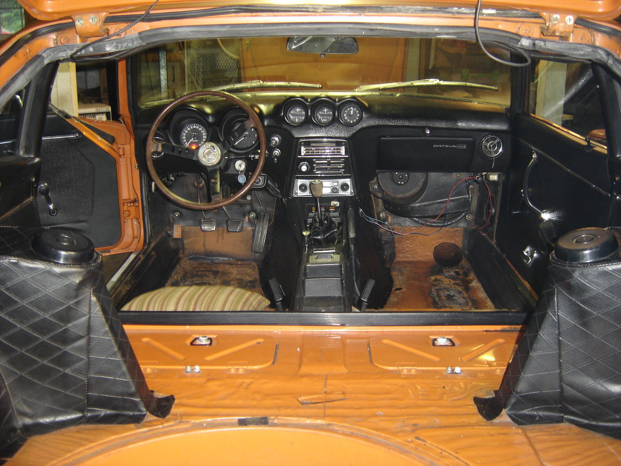

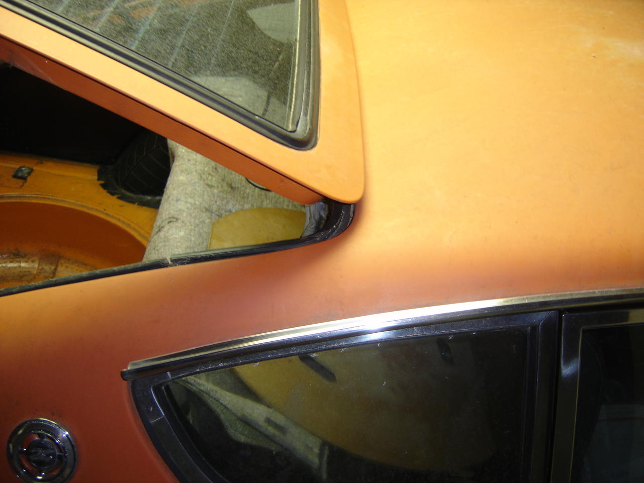

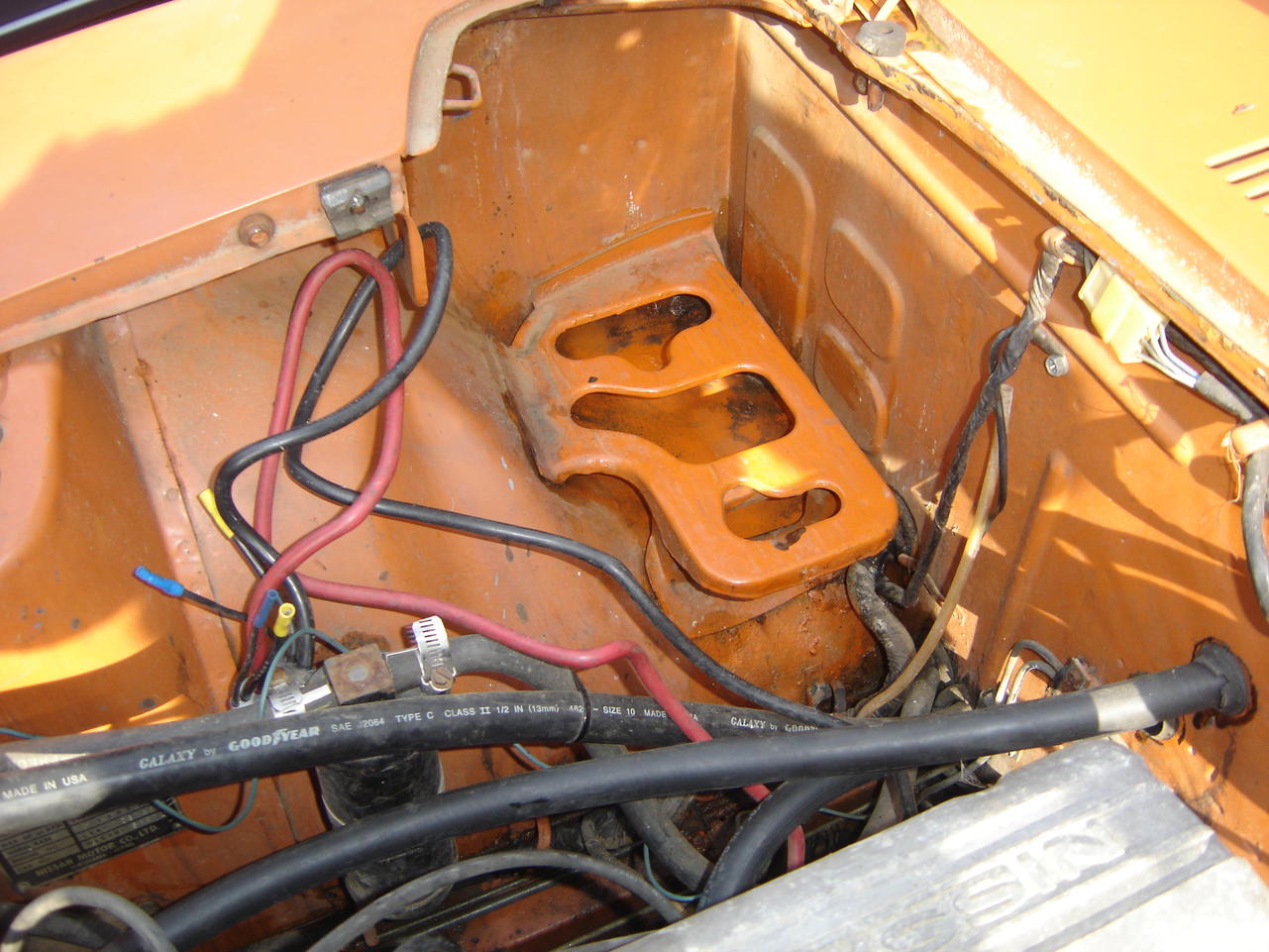

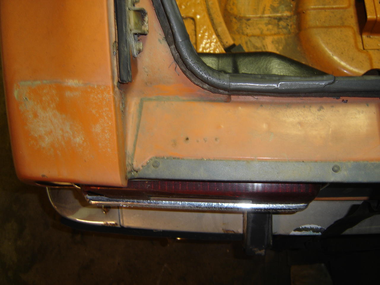

May 16, 201410 yr Author comment_447946 Got it home last night! Too tired to do much else but take some pictures. Link to comment https://www.classiczcars.com/forums/topic/49218-decent-240-close-to-me/?&page=2#findComment-447946 Share on other sites More sharing options...
May 16, 201410 yr comment_447949 Nice! Link to comment https://www.classiczcars.com/forums/topic/49218-decent-240-close-to-me/?&page=2#findComment-447949 Share on other sites More sharing options...

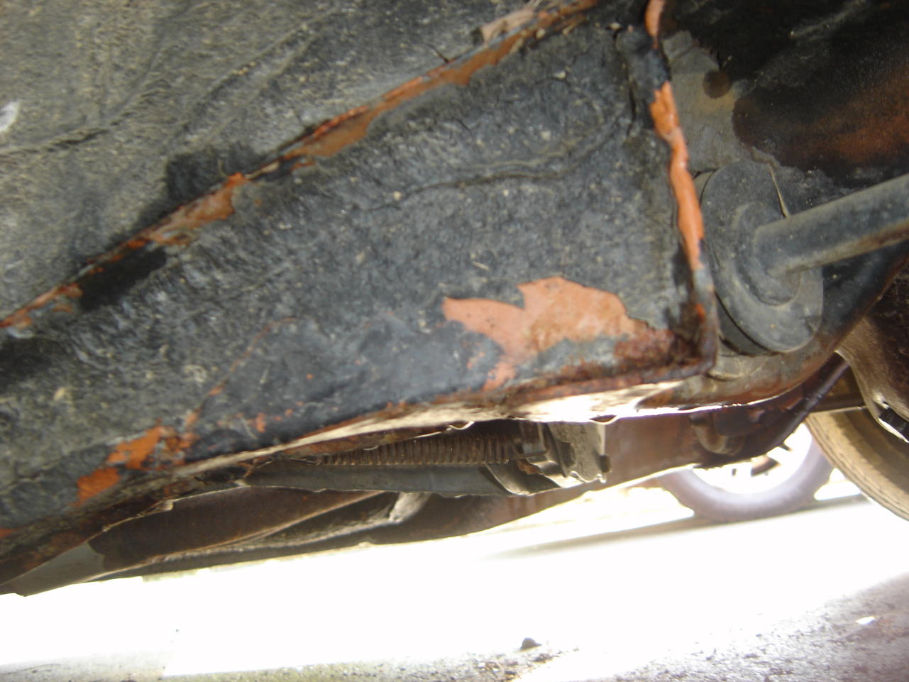

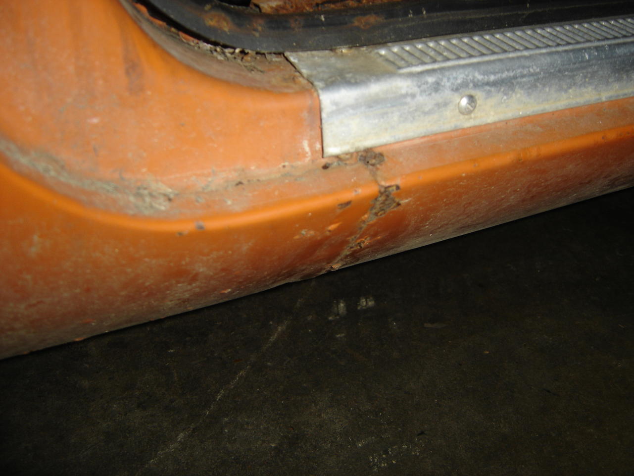

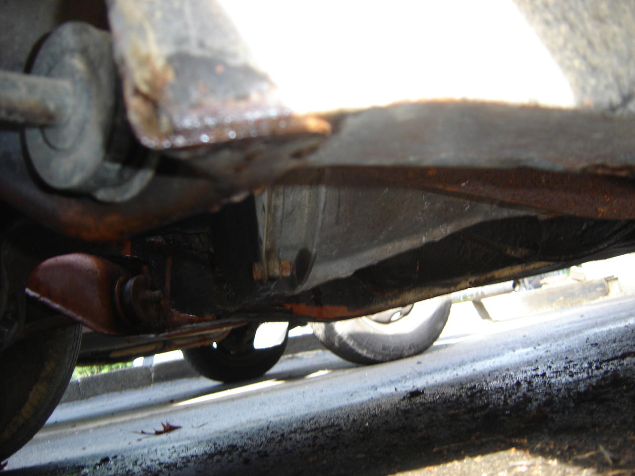

May 16, 201410 yr comment_447952 It looks like a great starting point. How do the rails near the TC mounts look Cliff? Link to comment https://www.classiczcars.com/forums/topic/49218-decent-240-close-to-me/?&page=2#findComment-447952 Share on other sites More sharing options...
May 18, 201410 yr Author comment_448032 It looks OK to me under there but I'll find something that's unsettling once I get it up on a lift, I'm sure. Link to comment https://www.classiczcars.com/forums/topic/49218-decent-240-close-to-me/?&page=2#findComment-448032 Share on other sites More sharing options...
May 18, 201410 yr Author comment_448035 Seems to have been taken care of. Link to comment https://www.classiczcars.com/forums/topic/49218-decent-240-close-to-me/?&page=2#findComment-448035 Share on other sites More sharing options...

May 20, 201410 yr Author comment_448148 Good day, I got it started and drove around the block! If I hadn't taken the seats out I'd still be driving it. Some carb gaskets were leaking, the firing order was 180 backwards and the valves were all too tight especially the intake valves. 1st I used a gas can as Jeff said then I put filters everywhere and put 5 gallons in the tank. Has a cool sound, the 2 pipes coming off the exhaust manifold go into a straight shot 2.5" exhaust. It has an "A" stamped cam that looks good, the spray bar works really good too. Oh and the York A/C works! Z karma at it's best! Link to comment https://www.classiczcars.com/forums/topic/49218-decent-240-close-to-me/?&page=2#findComment-448148 Share on other sites More sharing options...
