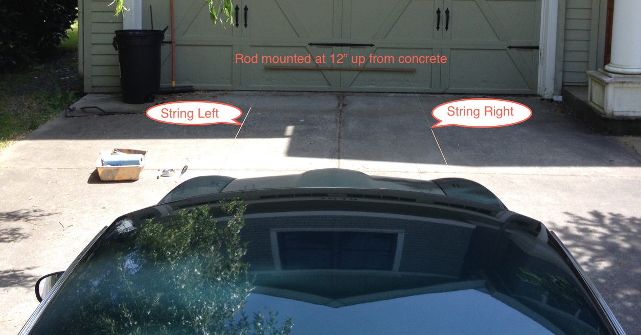

after replacing the front steering rack bushings and upgrading the suspension i noticed the steering wheel was a few degrees off and figured it was time to check alignment. the z is amazingly simple to align, with the only adjustment necessary on the end of the tie rods. there may be other ways to get the toe angle correct (some folks use a rod or wire to measure the tires inside-inside at different locations) but i've always used a simple old-school setup that just requires some string and a ro
