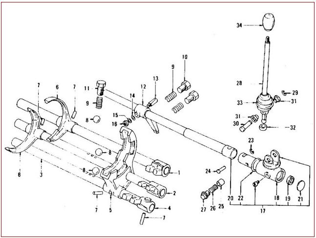

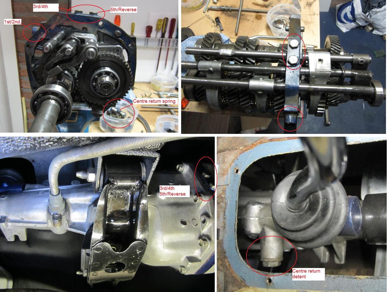

June 12, 201410 yr comment_449722 Your problem is caused by a worn, broken or missing detent spring on the bottom selector. Its POS#9 in the attachment. You should feel the detent working when it centers in the neutral section of the gate. Its easy to check it with the transmission still in the car. There are two plugs on the side of the metal centre section. The bottom one is for reverse/5th. Check the spring and ball are in good condition. You can also compare it with the one in 3rd/4th which is the top plug on the side. 1st/2nd is on top and hard to get out while transmission is in the car without a magnet. If the gear shift doesn't pop over and line up with 3rd - 4th then it will be the centre return spring POS#26 in the attachment. Chas Link to comment https://www.classiczcars.com/forums/topic/49433-5-speed-transmission-grinds-on-reverse-when-i-pull-it-out-of-5th-gear-why/#findComment-449722 Share on other sites More sharing options...
