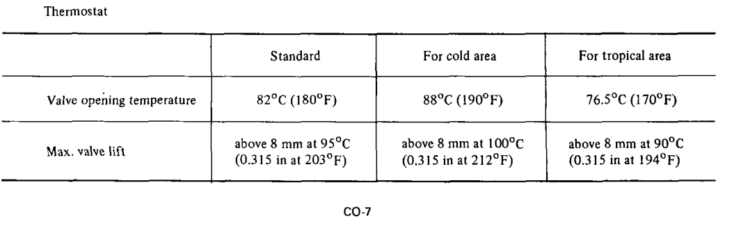

Nissan got more specific on thermostat temperature choice after 1972. Here's the 1976 chart. You still have to figure out Tropical and Cold. There's probably some general world-based definitions out there somewhere.

I suggest that the OP refer to the FSM picture in Zed Head's post above to select the correct thermostat temperature.
