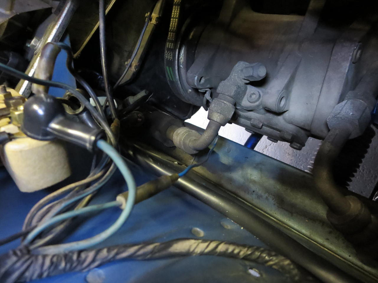

I think that the mystery blue wire connects to the condenser/capacitor. It's a small silver can-shaped thing that usually bolts to the coil bracket, I think. It's not necessary and having it disconnected takes it out of the picture as a problem source.
That mistery blue wire is for the AC compressor clutch. If your car has factory airco it should be connected to a black wire that comes from the compressor just behind the pulley. Its not causing the problem the way it is now.
Its shown in the 77 FSM in section AC37 and AC38.

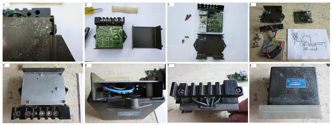

I had a lot of problems with my TIU when it was warm and i did a crude HEI Module swap to see if it would help. Here is a photo of it now. I made it completly reversable so I could return it to original if it didn't solve the problem.
I am planning to build the HEI module into the old TIU casing and get it back to stock looking.
Not saying you should now change to the HEI module. There is still some checking you should do before you make that move. I just wanted to give you an idea what it is.
