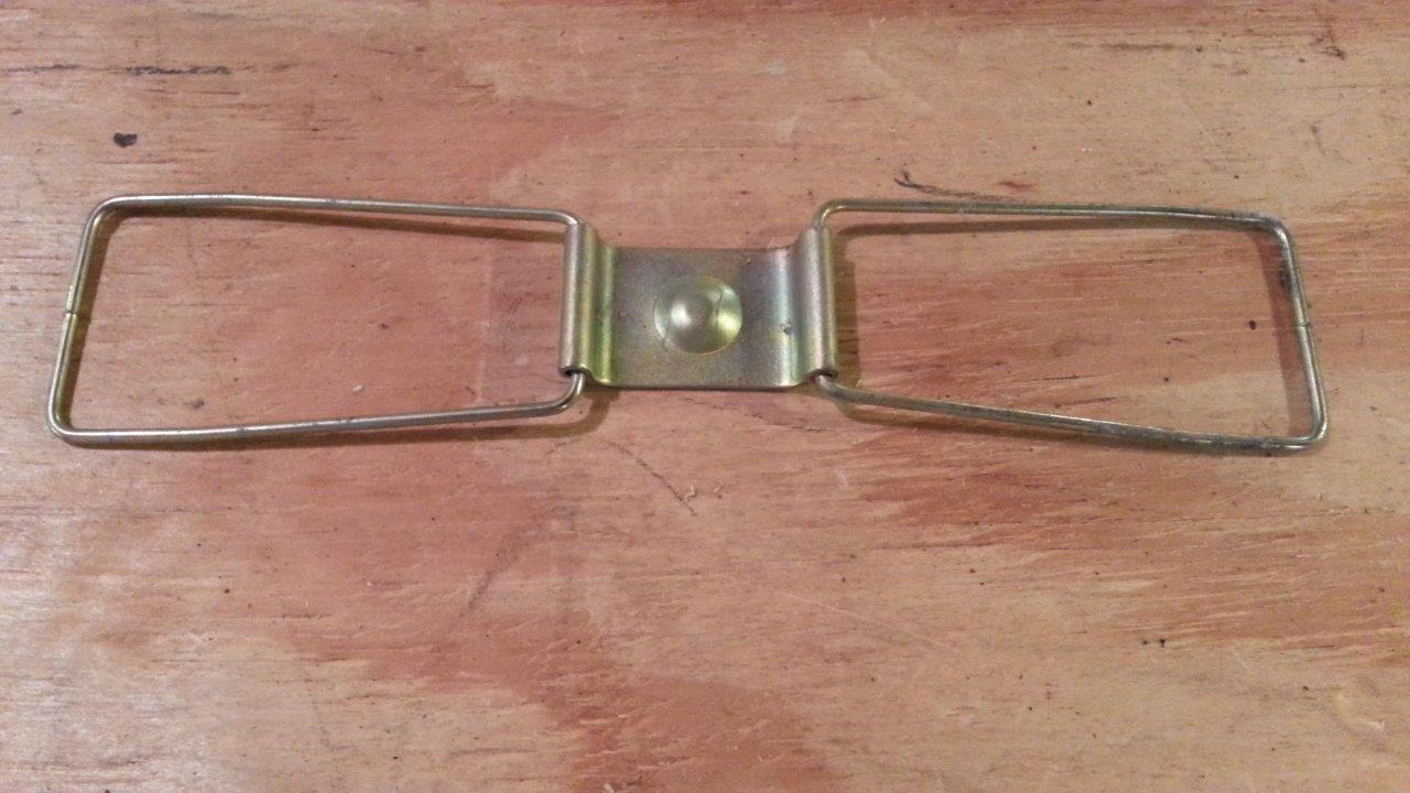

Posted July 4, 201410 yr comment_450915 Please help me identify the part I have attached a picture of. I am listing a bunch of 240Z parts for sale, but I am not sure what this is or where it came from on the car. It should be from a 1970-72. I assume it held something, but I am not sure. Thanks! Link to comment https://www.classiczcars.com/forums/topic/49566-what-is-this-part/ Share on other sites More sharing options...
July 4, 201410 yr comment_450922 I seem to recall that part being the gizmo that holds the jack in place. Maybe Link to comment https://www.classiczcars.com/forums/topic/49566-what-is-this-part/#findComment-450922 Share on other sites More sharing options...
July 4, 201410 yr comment_450928 Mark is correct. It is used on a Series I to hold the jack in place. The ends of the wire loops hook on to mating parts on the floor. Slip the jack under the center part and raise the jack to secure it. Link to comment https://www.classiczcars.com/forums/topic/49566-what-is-this-part/#findComment-450928 Share on other sites More sharing options...

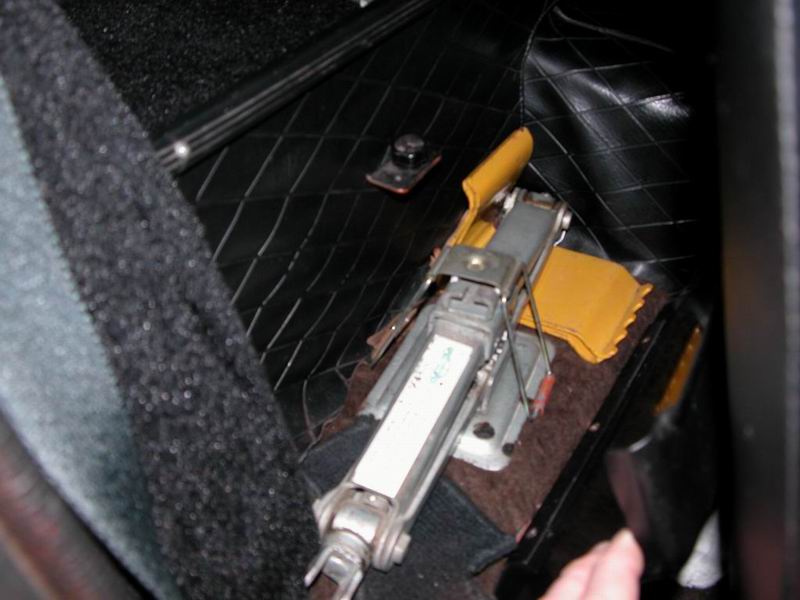

July 4, 201410 yr comment_450951 Here's a Pic showing the installation. Mike Link to comment https://www.classiczcars.com/forums/topic/49566-what-is-this-part/#findComment-450951 Share on other sites More sharing options...
