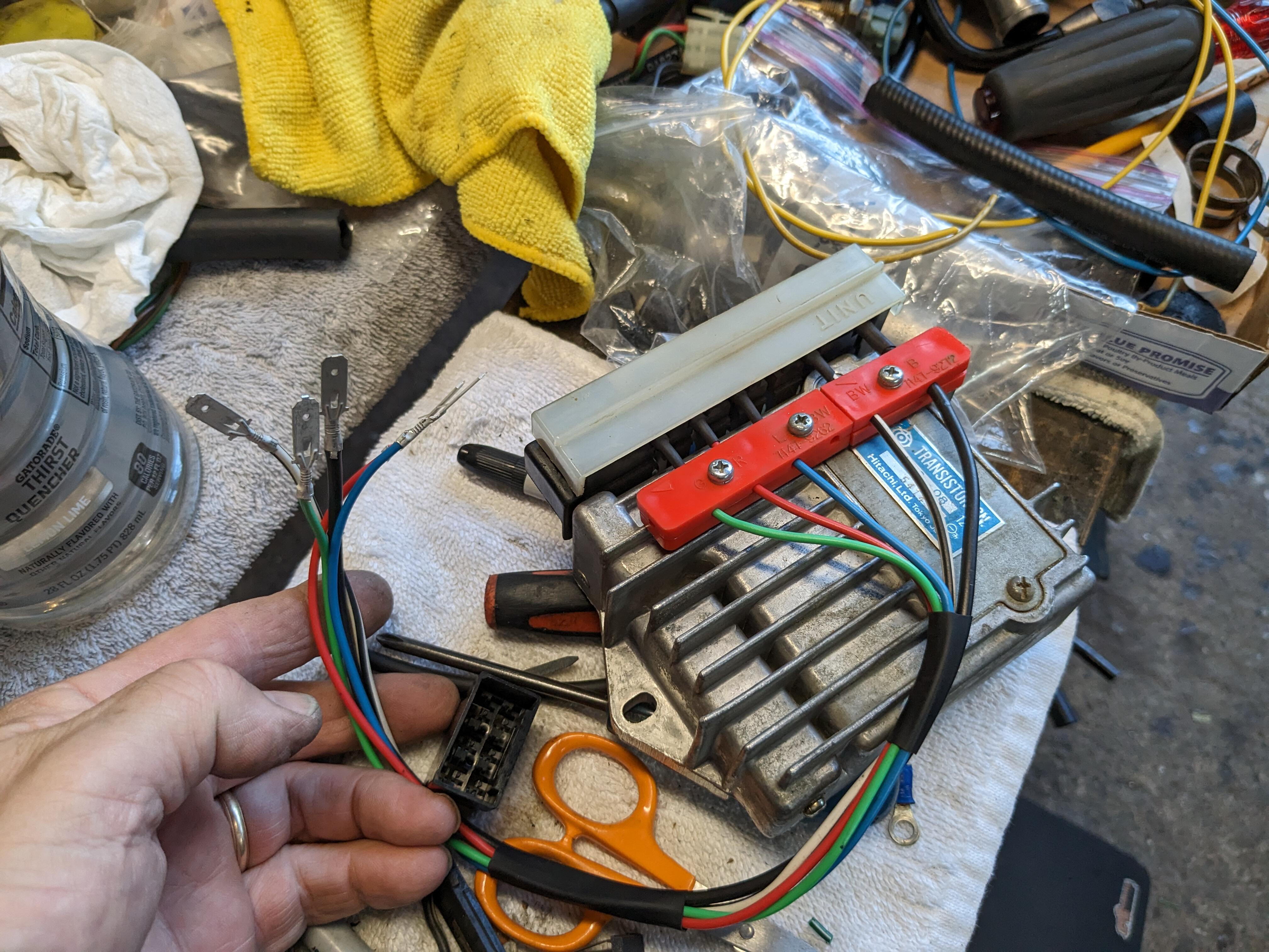

Fitting a HEI Module in Transistor Ignition Unit 1977 280Z

On 10/3/2023 at 2:56 AM, HusseinHolland said:
I ran the motor & used the timing light, leaned over & revved the motor. Timing advances as expected when revved, and sits at approx 8º BTDC at idle.
The motor goes completely flat when revved & held at around 2500-3K. Fuel pressure does not falter, I have a line gauge after the filter.
I tried reversing the wires from the reluctor, and that had very bad results. It cranked normally for a few revolutions, then turned over very slowly, then not at all. After that, it was completely dead. I thought the battery was drained - I found that cranking like that blew the 125 Amp fuse breaker on the starter cable from the battery. I replaced that, put the wires back & it started again normally.
I don't understand why the ignition system is creating such an extreme current draw when the reluctor wires are switched.  No one has previously mentioned any issues with reversing the reluctor wires.
I tried another coil, in case that was an issue.
I'm going to put the stock module and coil  back in & confirm whether the issue is with the HEI conversion or not.
re-wired to plug into the modded harness
It's hard to believe a 125amp fuse blows by swapping the reluctor wires, but there must be some relation if that is the only change you made before the fuse blow.
I had similar problems with not revving past 2500rpm. Mine would rev cleanly to 2500rpm and then sputter around 2500rpm. It wasn't a hunt, more erratic running. I'm doing this from memory, since it is some years back.
Like you noticed, I accidently swapped the green and red wires on the HEI terminals when I quickly fittrd it for testing. When I changed them back, the promlem was gone.
