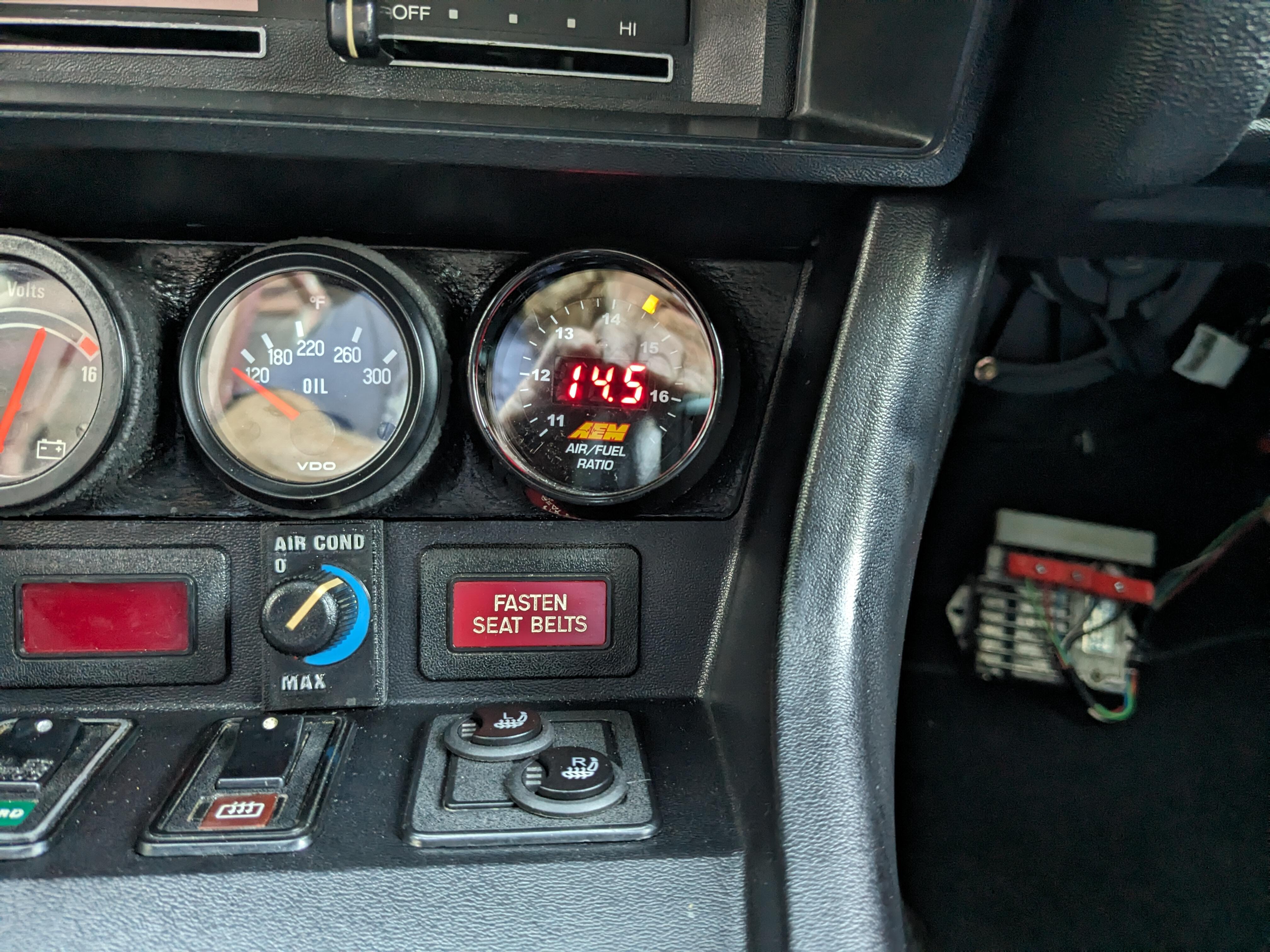

AFR's are way WAY to lean, even when stone cold, it started around 14 & went leaner from there. Normal op temp idle AFR's were 16.5-16.7 range.

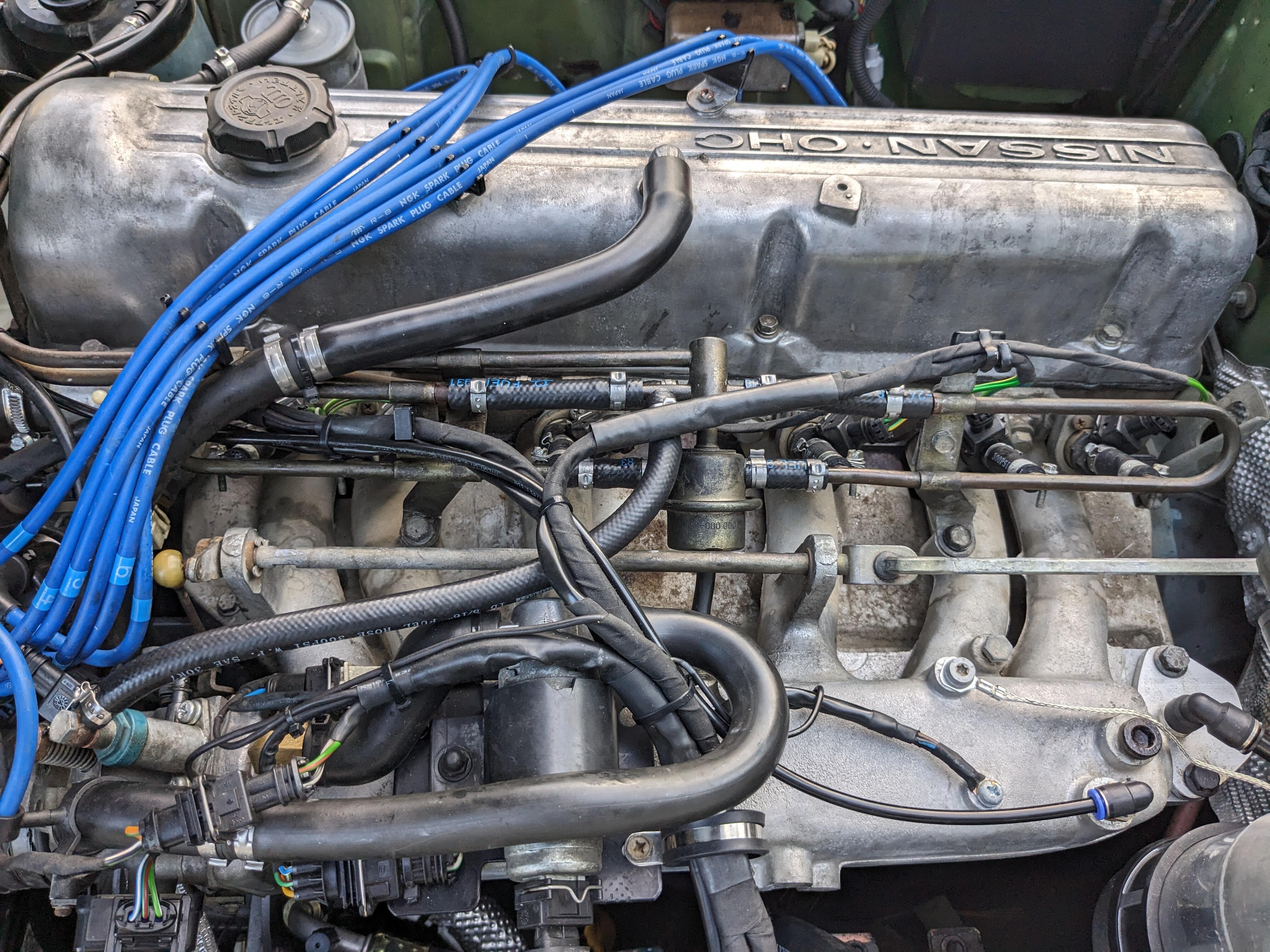

Regulated fuel pressure is steady @ 36psi, and gets higher as vacuum decreases (when revving the motor off idle). Unplugging each injector in turn, affects the running.
 I'm going to pull the rail & check for any restrictions.

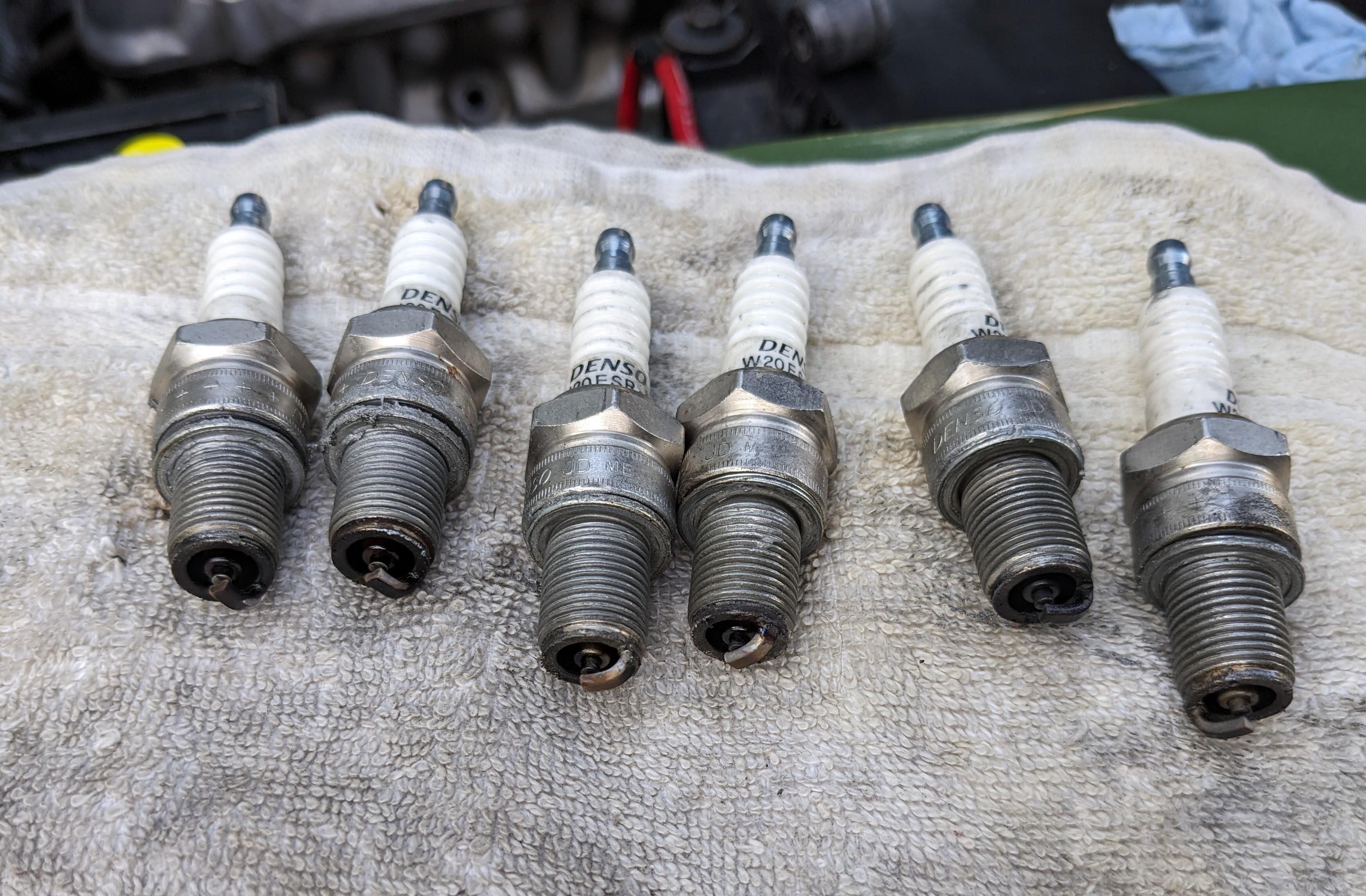

Also pulled the plugs & checked that. They're not old, and they look pretty even

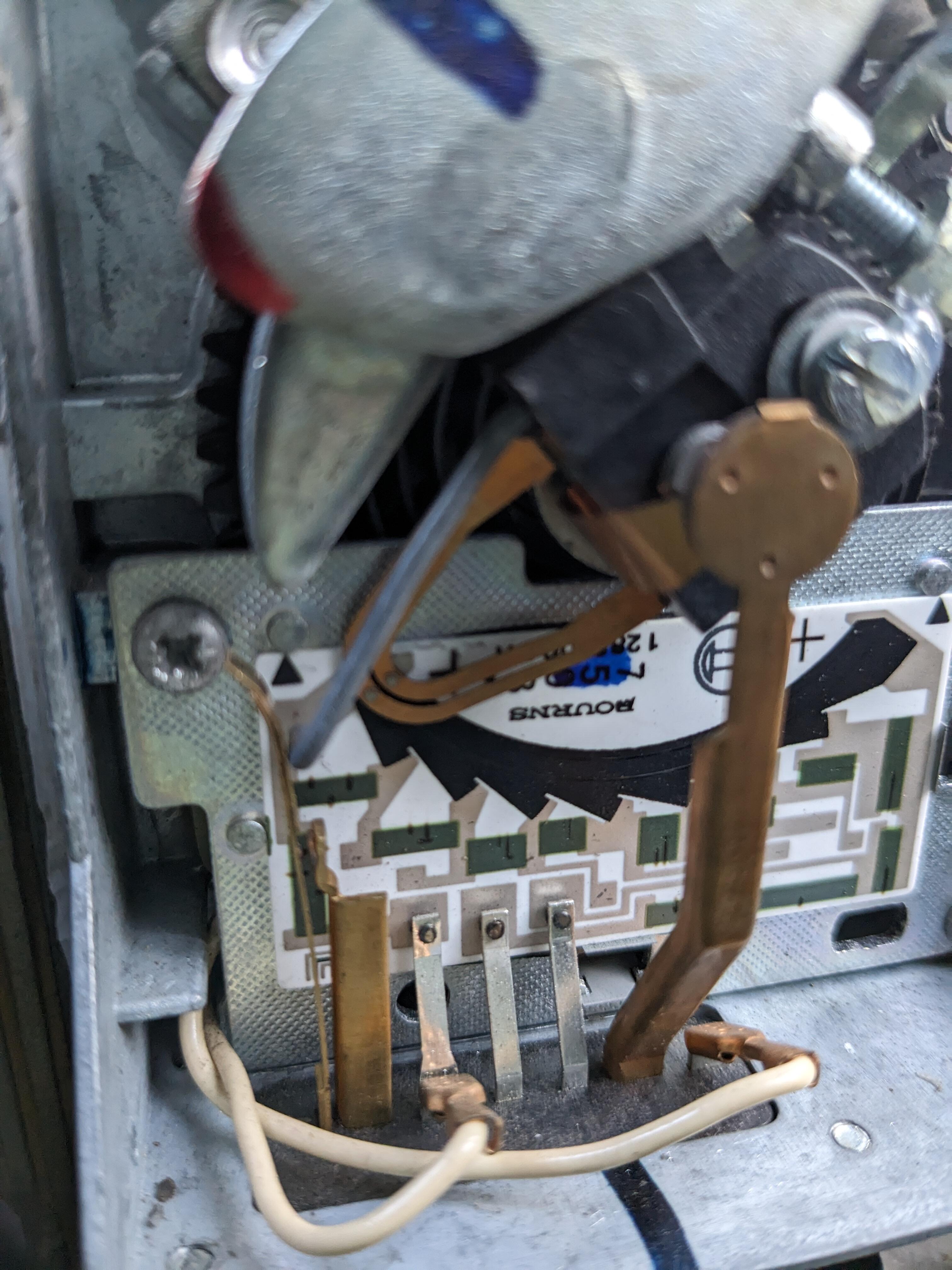

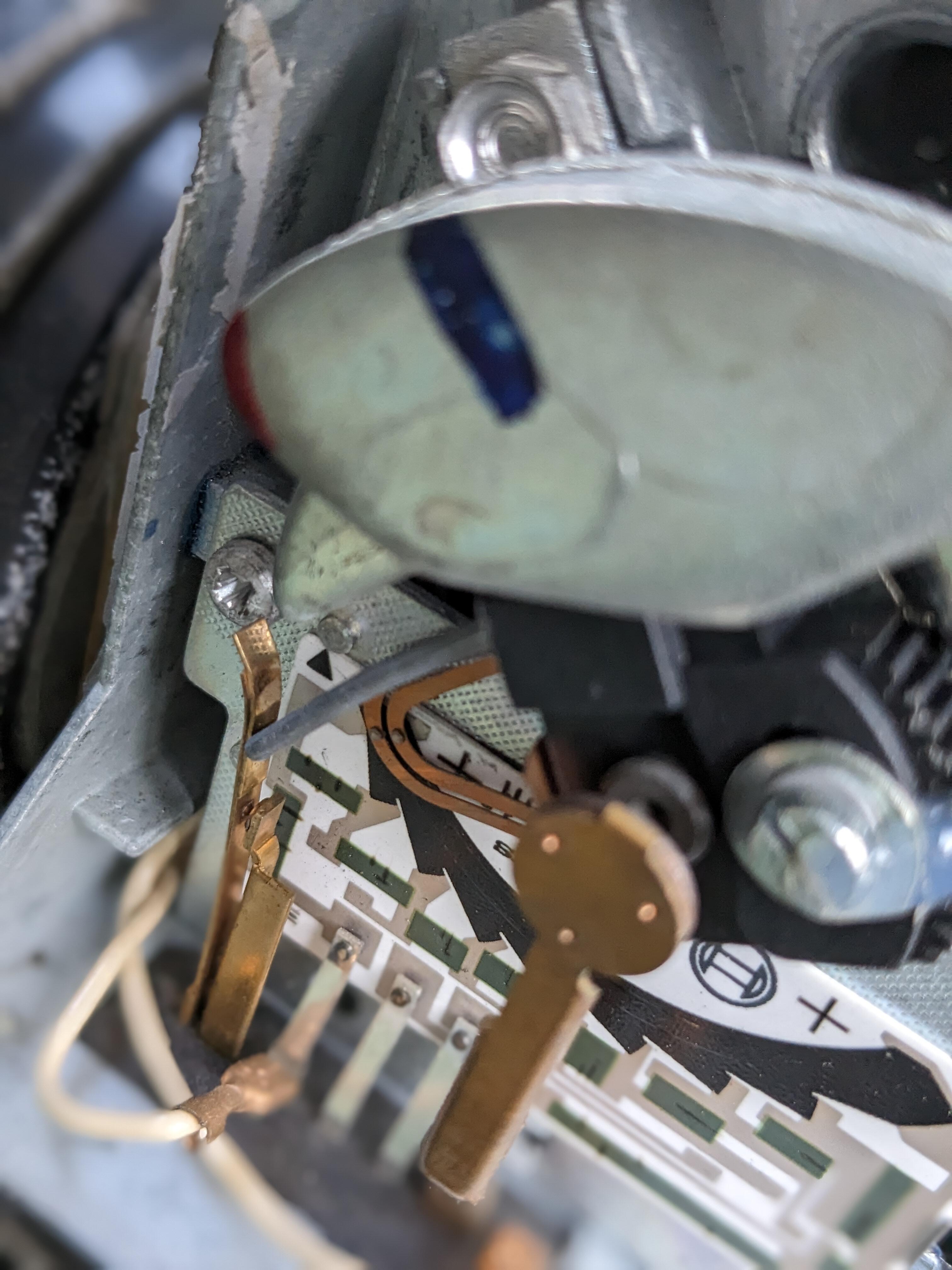

The only other thing I'm wondering about, is the AFM - the cover is not fixed, and I've knocked it off several times. I'm wondering if I somehow messed up the sweep. Can't tell if it's actually making contact with the board. Does seem like a stretch, though.
EDIT - looking closely at this pic on the large screen at work, I can see two track marks on the circuit.

So, I decided that instead of futzing with the AFM to try & tweak the AFR's 2 whole points richer, I decided to just raise the regulated pressure to 3bar - using a Volvo regulator of course image.gif As you can see form the video above, that brought the AFR's right where they need to be.
new regulated fuel pressure under vacuum. Rises to 3bar with vacuum removed.
Having confirmed the pressure is consistent & vacuum works I installed a nylon feed line & quick connect in the intake. Old FPR location is bridged with new hose above it.
Bay
Now I know the system is fully operational, I will revise the return setup, it is overly long - didn't want to cut down the hose that had to connect to the rail return until I knew it would work.

I tried plugging in a Volvo ECT, and with it pressed against the t/stat housing the AFR's were where I wanted them to be - 14.5-7 range at idle, so I swapped it out after the engine cooled. With it installed in the cooling system,  the AFR's went even leaner. I'll order a new ECT, just to safe. I'm going to have to investigate a thorough functional test of the AFM also.
