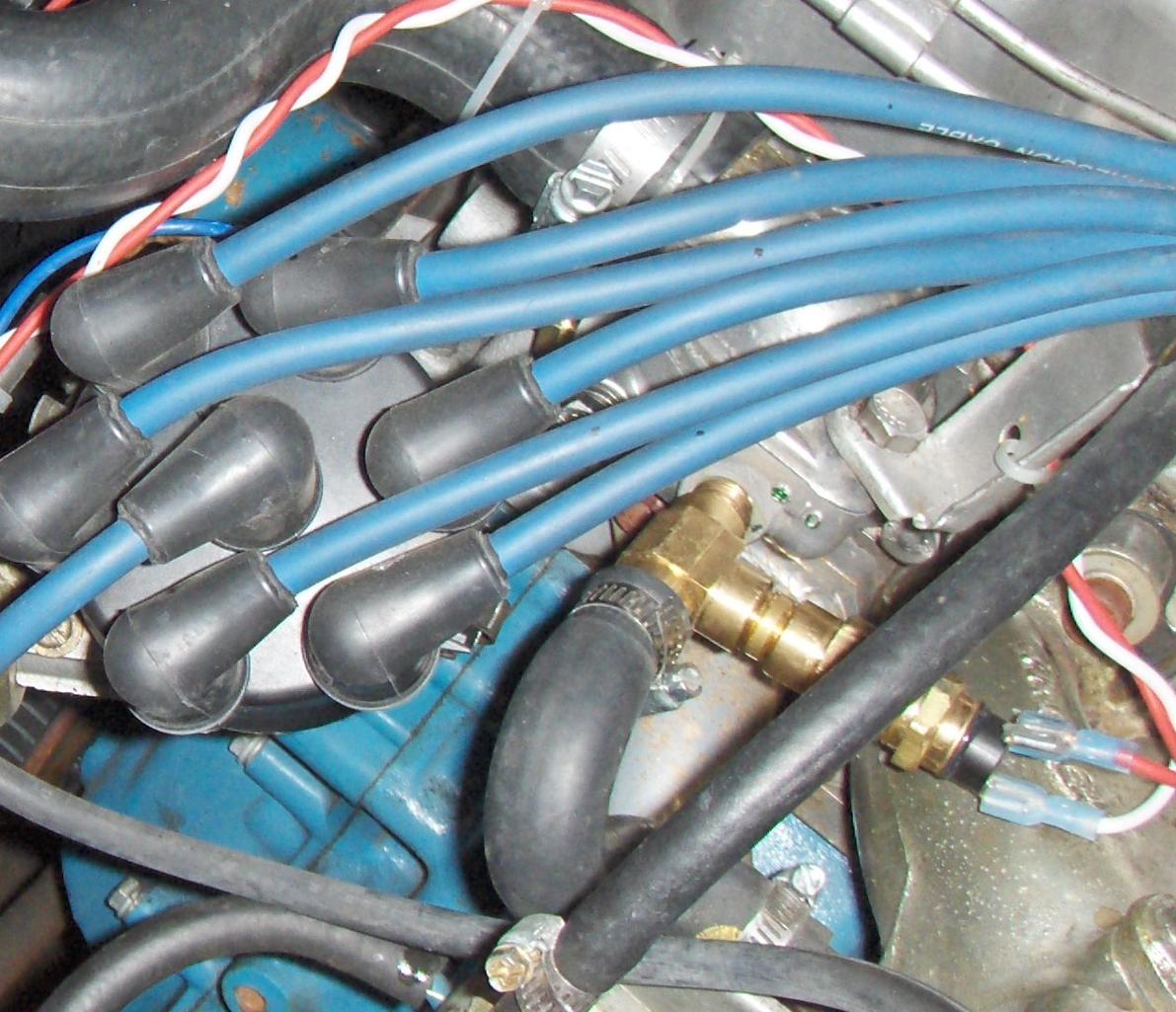

I mounted a temperature switch in the heater line for the SUs. You have to buy a BSPT to NPT adapter nipple, and a T for the switch.post-3035-14150829299713_thumb.jpg
But it seems to work well. I know that I bought the temperature switch from Summit Racing, but it was 3 years ago and I don't remember the part number.
