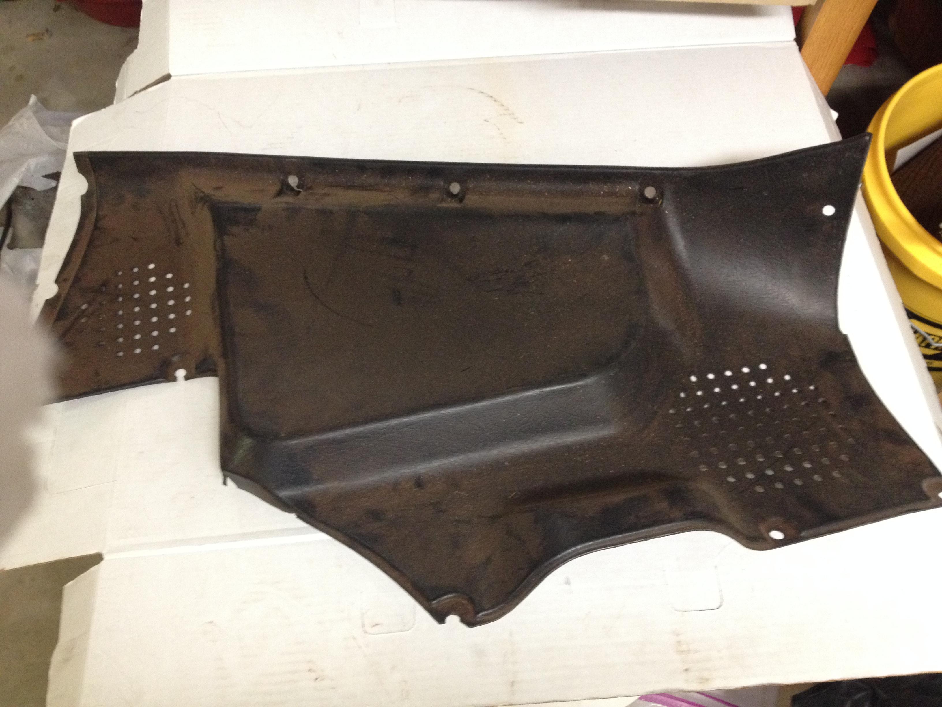

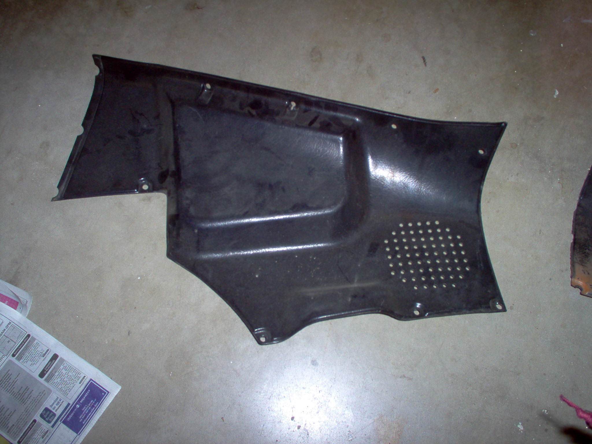

So getting to the details of your question... For a 77, you definitely need something that has the high notch. If you're planning to use speakers in the stock locations, then you'll want a pair from 77-78. If you're not going to run speakers in the stock spots, then maybe you want a pair from an earlier year without the holes. But be aware that if you go too far back in the chronology, you'll start getting into versions that have the seat belt hole (which you don't need). If you can't find anything without the seat belt hole, you could patch it and paint it, but just be aware that you'll need to do that. If you get really desperate, I believe you could use an even earlier version and extend the height of the strut notch with a hacksaw. Doesn't have to be perfect because that edge is mostly hidden by your seat belt mount cover on top of the strut tower.
Here's a pic of the last two designs highlighting some of the features. 77-78 on left, 76 (and maybe 75?) on right:
