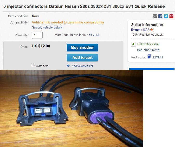

July 13, 201410 yr comment_451556 I ended up buying this connector kit for my 280Z. Quick release is handy for testing. He also has a complete kit available Injector Connector 6pc Kit Quick Release EV1 Datsun Nissan 280z 280ZX 300zx Z31 | eBay for $19.00 Chas Link to comment https://www.classiczcars.com/forums/topic/49622-fuel-injector-replacements/?&page=2#findComment-451556 Share on other sites More sharing options...
