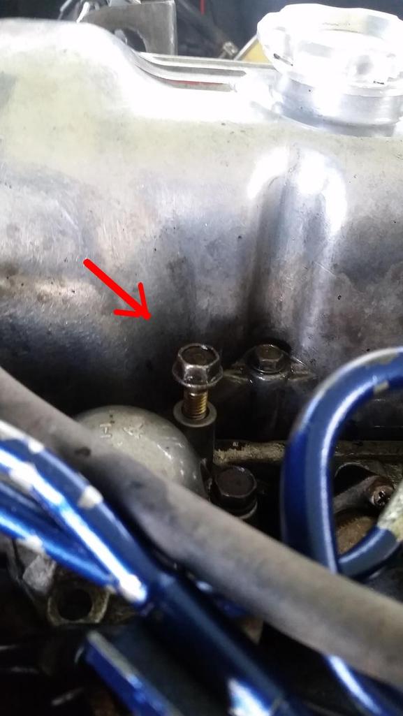

Zed Head Posted July 12, 2014 Share #13 Posted July 12, 2014 The screw on the side of the cover in the s first picture is the one I meant he tightened to alter the idle...All I see is a loose bolt on the thermostat housing. ??? Link to comment Share on other sites More sharing options...

NoLeafClover Posted July 12, 2014 Author Share #16 Posted July 12, 2014 (edited) The bolt that's higher than the other one next to it is the one the guy had out more while he drove it and turned it in more and told me that'd make it idle better but I'd lose power. Edited July 12, 2014 by NoLeafClover Link to comment Share on other sites More sharing options...

Zed Head Posted July 12, 2014 Share #18 Posted July 12, 2014 The bolt that's higher than the other one next to it is the one the guy had out more while he drove it and turned it in more and told me that'd make it idle better but I'd lose power. I put an arrow on your picture. That bolt has nothing to do with any of that. Maybe he was pointing at another? But, there is no adjustment that will, normally, make the engine idle better, but cause a power loss. That would only be the case if things were messed up. Your best bet is to assume the guy you bought it from was a BS'er or didn't know what he was doing. The taped up intake hose, the shiny new oil filler cap, red plug wires, painted air box, 4" exhaust tip - all things that cause pause. Describe one problem at a time and people here can walk you through some of them. I would focus on over-heating first. One overheat can blow your head-gasket and/or warp the head. That's a major expense, and a fairly difficult DIY job. Back to watching Holland beat up on Brazil.... Link to comment Share on other sites More sharing options...

NoLeafClover Posted July 12, 2014 Author Share #20 Posted July 12, 2014 The number one problem I have that scares me is the high revving, that's the correct screw with the arrow and I watched him tighten it as he said it was going to change things. Link to comment Share on other sites More sharing options...

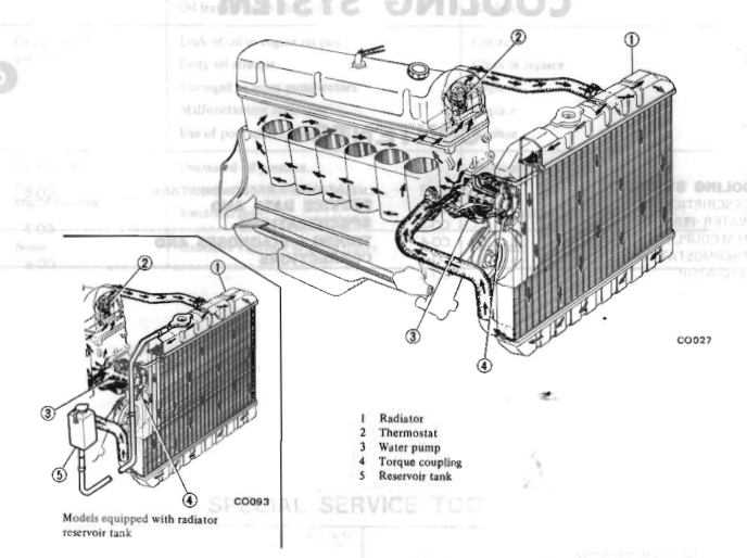

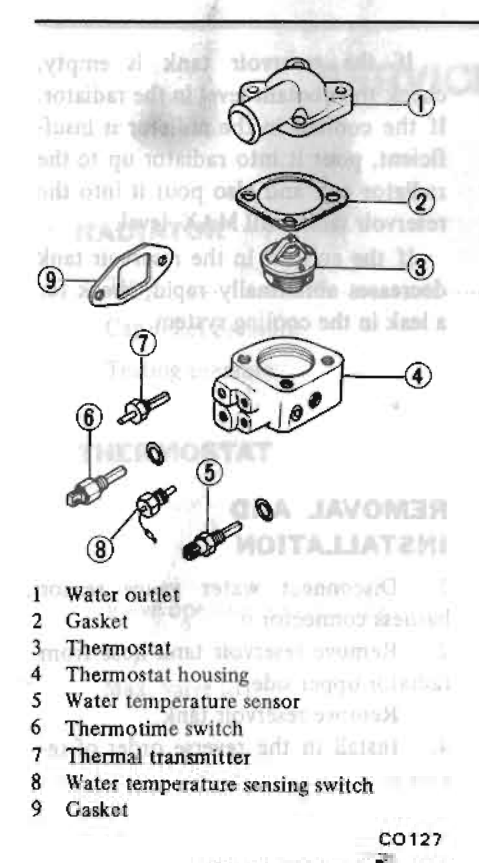

Zed Head Posted July 12, 2014 Share #22 Posted July 12, 2014 (edited) As I said, he was either BS'ing you by grabbing a loose screw and turning it or you mistook the one he actually turned for that one. Attached a picture showing the screw position that I think we're talking about. Also noticed that your radiator does not appear to be stock. Could be too small for the engine but certainly a sign of a past cooling problem. These pictures are from the Cooling chapter. An example of what you'll find in the books. The digital FSM's are one of the great benefits of owning these cars. You don't have to try to communicate with the parts store guys. Looks like you have a challenge. Keep posting, everybody loves a good puzzle. Edit - just noticed that you seem to have an electric fan, guessing by the shroud. Another not really necessary "performance" item. If the fan isn't coming on you'll have over-heating problems at slow or no speed. Edited July 12, 2014 by Zed Head Link to comment Share on other sites More sharing options...
