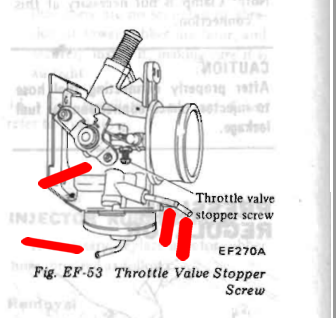

I checked under the throttle body and I have no spring. Is there a certain type I can purchase at the parts store or is it something I'll have to put on order?
Here's a picture of where the spring would attach to pull the throttle closed. I bought several at a hardware store and tried a few until one felt right.
Also added a line to show where you might have hidden vacuum leaks. each one of those tubes will leak when the throttle is opened but wil be closed when the throttle is closed. They should all have a hose attached (ideal stock configuration) or be sealed (in the meantime).
