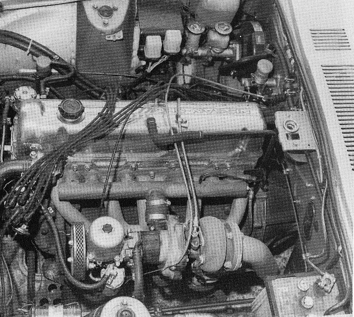

March 4, 200322 yr comment_28560 That sounds like a "JANSPEED" conversion from the late Seventies / early Eighties. JANSPEED were ( still are ) a UK-based company run by ex-racer Mr Jan Odor. As far as I remember, Mr Odor was born in Holland and came to the UK in the 1960's to work at famed Mini tuners Downton Engineering. He set up his own company in the early Seventies and became very successful - providing hard race parts and tuning gear for BMC products. He very soon moved onto Nissan / Datsun parts as he reckoned they offered more potential for cost-effective tuning. They used to have a very large inventory of Nissan / Datsun related tuning parts, but not so much now. They had a fairly close relationship with Datsun UK in the old days, and I have to say that the quality of their parts was very good for the time. The Janspeed turbo conversion used a Rotomaster turbine sucking through a single 2 inch SU carburettor, and they left the engine internals alone - so boost was limited to just 5psi. The kit also included an oil-cooler setup. Figures of 0-60mph in 6.6 secs. and 15.3 for the standing quarter-mile were quoted for an otherwise-stock UK-spec. RS30 260Z. Above figures and the photo below are from "The Z Series Datsuns" by Ray Hutton ( published by MRP in 1982 - ISBN no. 0 947981 02 0 ) which is actually quite a good little book. If you want to get in touch with JANSPEED I'm sure they can give you any data that you might need. Let me know if you want me to track down their contact numbers. Alan T. Link to comment https://www.classiczcars.com/forums/topic/4963-260z-with-turbo-kit/#findComment-28560 Share on other sites More sharing options...
March 5, 200322 yr comment_28661 Good to hear from you Alan, I was trying to remenber the other turbo that was common back then RAJAY. I must admit I can definately help with the general data about what Ben has found, as the Kit you showed is identical to what we in Australia where fitting in the early 80's too. I am glad you now about Janspeed. That should really help Ben.Cheers Steve:classic: Link to comment https://www.classiczcars.com/forums/topic/4963-260z-with-turbo-kit/#findComment-28661 Share on other sites More sharing options...
March 5, 200322 yr comment_28671 The turbo kit that I bought for my 240Z was a copy of the Janspeed kit. I modified the intake section & made a proper long-runner & plenum setup for multipoint EFI. (At first we just put injectors in the original setup, but there was just no volume....). At the end of the day, it ran very well, but with draw-through & intercooling the throttle response was a bit soggy. And the O-trim TO4 was far too large.... Link to comment https://www.classiczcars.com/forums/topic/4963-260z-with-turbo-kit/#findComment-28671 Share on other sites More sharing options...

March 5, 200322 yr comment_28723 Hi to Ben ( Bpaccaud ), sjcurtis and the other Ben, The points-type ignition on the GRLS30 would be correct for that year and model. As it obviously started out life as an LHD-market car I will leave it up to the LHD-spec. experts to comment on what year the electronic distributors started to be fitted from the Factory.Bpaccaud, I would imagine that the symptoms you describe could be linked to almost any fault and not just something on the turbo conversion. However, if its running hot and likes the choke then I would be tempted to investigate that its not running much too lean. Has anybody been messing with the carburettor settings? By all accounts the Janspeed conversion is pretty simple - so not too much to go wrong. Don't quote me on that though.............I don't believe the Janspeed kit came with water injection, and I'm not sure what you mean about pressure regulation - but the Janspeed kit was a fixed boost system if that's what you mean.Steve ( sjcurtis ) - glad that you have practical expertise on this kind of thing as I certainly don't! I too remember the old RAJAY turbines, and do you remember brands such as HOLSET? I used to spy things like that on old diesel trucks and wonder what the hell they were.............Ben, Janspeed made a different and probably more sophisticated kit when the injected cars made it to the UK ( the S130 series ). Was a copy / similar design to that system also used in Australia? Maybe they licensed the design or something. I did Janspeed a dis-service by saying in my previous post that they were founded in the early Seventies. In fact, Jan Odor started the company back in 1962. Here's the latest information that I have if you want to contact them to ask for any data that they might still have:JANSPEED ENGINEERING LTD.CASTLE ROAD, SALISBURY, WILTSHIRE SP1 3SQtel: 01722 321833fax: 01722 412308Good luck,Alan T. Link to comment https://www.classiczcars.com/forums/topic/4963-260z-with-turbo-kit/#findComment-28723 Share on other sites More sharing options...

March 5, 200322 yr comment_28743 You are most welcome.I should imagine that the numbered plaque would indicate that JANSPEED themselves fitted the kit to the car. I can't think that they would want to endorse it in this way unless they had ensured the quality of the installation. It might be a good idea to try contacting them for their advice.As the kit was so simple I do not believe that it had any adjustment or external control, and that the distributor advance was pretty much the same as a stock engine. Best to confirm this with JANSPEED themselves or with sjcurtis and Ben, as I profess no in-depth knowledge of turbo installations that would be of any help to you. I've seen these kits on some UK cars and it does indeed look very basic. Owners report very good peformance considering its a bolt-on.............With regard to the JANSPEED kit and the numbered plaque, I have to be honest and tell you that I don't think it would increase its value significantly. Bear in mind its fitted to a 2+2 model, which generally speaking attain lower prices than 2 seaters do. I guess its worth whatever the most enthusiastic buyer is willing to pay for it.Alan T. Link to comment https://www.classiczcars.com/forums/topic/4963-260z-with-turbo-kit/#findComment-28743 Share on other sites More sharing options...
