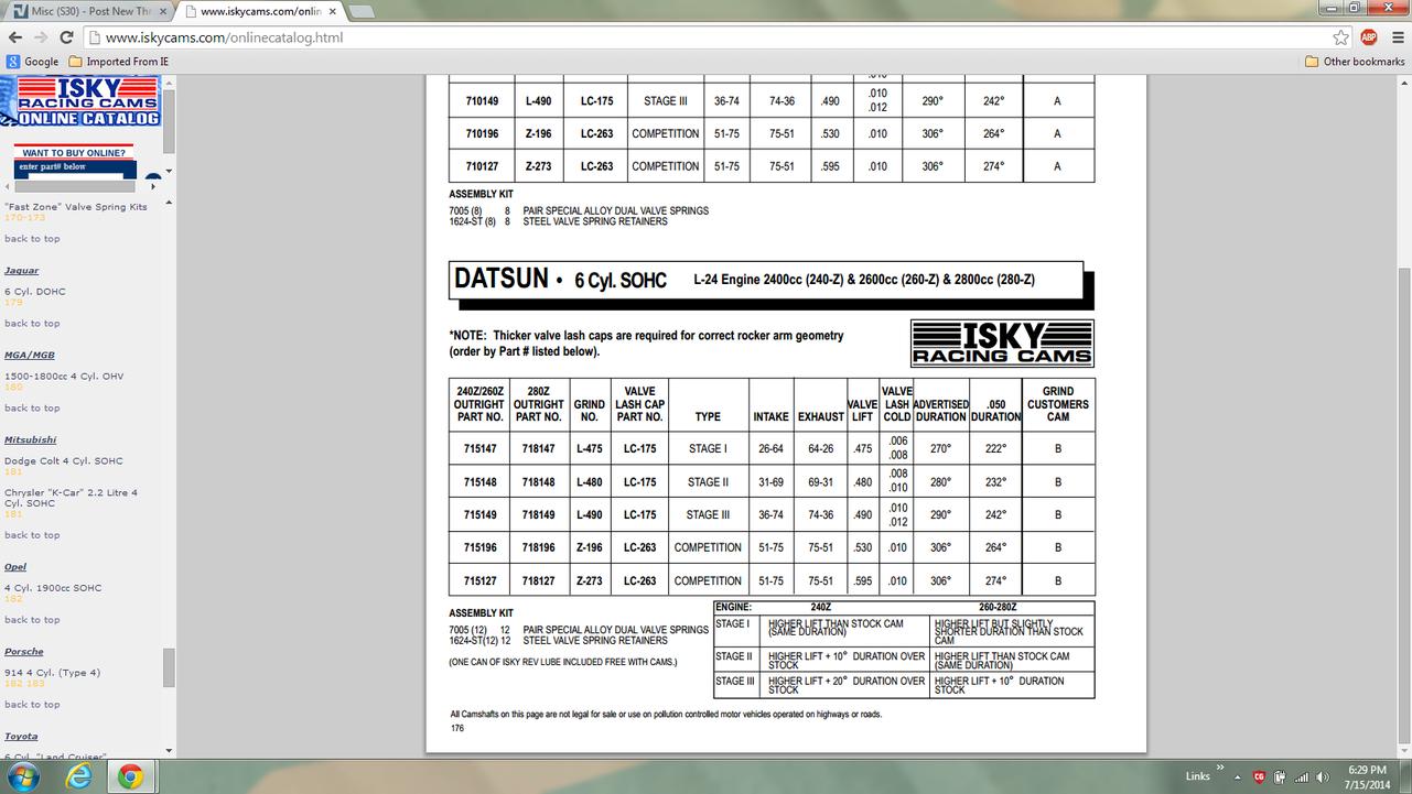

Posted July 15, 201410 yr comment_451666 I have a 9/'76 N47 cylinder head with a "B" internal oil cam with spray bar. I would like to know, before I call, if my thinking is correct. I want the Stage III grind on my cam using my rockers and lash pads as well as the cam towers to be installed on an E31 head. Is this the way to do it or am I wrong? Will I send them my rockers or should I get their's? lash pads? Thanks to anybody that can steer me the right way, Cliff Link to comment https://www.classiczcars.com/forums/topic/49640-before-i-call-isky-please-advise/ Share on other sites More sharing options...

July 17, 201410 yr Author comment_451771 That chart I posted in #1 says "Grind customers cam B". My internal oiler cam is a B stamped one, on the N47, it also has a spray bar. The E31 cam is stamped "A" without oil holes, just the spray bar. I would rather have both, oiler cam and spray bar with the automatic turbo's oil pump, flood the cam. Is there a L motor specialist at Isky that you deal with? I hate to keep bothering you with my questions and my local machinist is not very familiar with our cars. He said he could access all the details with a computer program he has. I thought about Eddie Radatz in Kennesaw, GA. I know Rebello is the most recommended but I'd like to keep it on the east side of the Mississippi. Who do you use? Thank you for all your insight, it's priceless...literally. Link to comment https://www.classiczcars.com/forums/topic/49640-before-i-call-isky-please-advise/#findComment-451771 Share on other sites More sharing options...
July 17, 201410 yr comment_451786 A is 4 cylinder, B is 6 cylinder......they grind solid and hollow cams the same. I've never seen an N47 cam on a spray bar head. Does it have holes drilled in the lobes for internal oiling? It strange to me that they would have a spray bar and internally oiled cam, but have never worked on the early N47 head. Not sure who to recommend, but if you've never done one before, it might pay to ship it off. Z Doctor builds all of my heads, but he has slowed his ops to a minimum. I'm sure Dave Rebello will build you a nice head. My guess with cam, springs valves etc., you're looking at $2,000.00, but only a guess. Link to comment https://www.classiczcars.com/forums/topic/49640-before-i-call-isky-please-advise/#findComment-451786 Share on other sites More sharing options...
