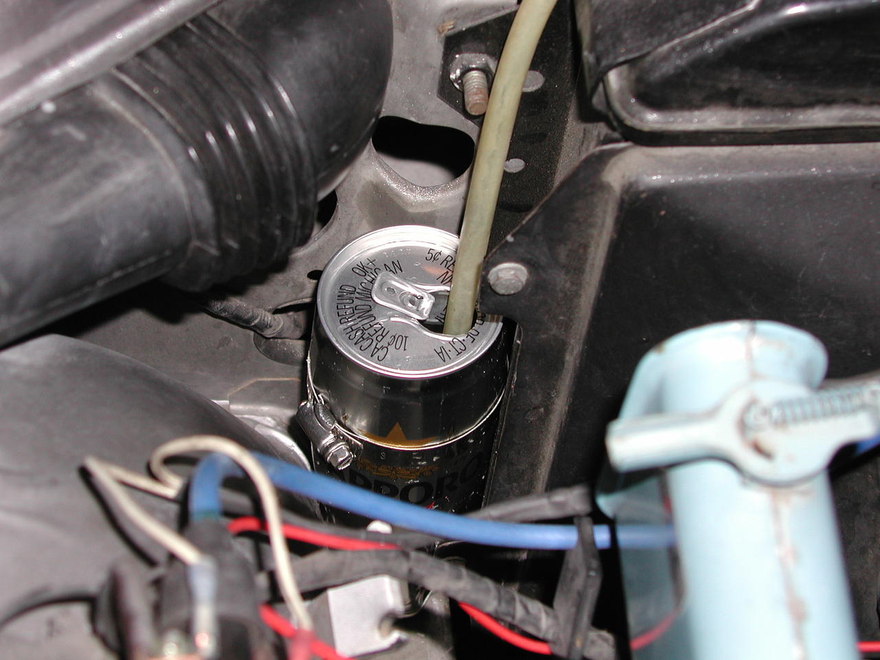

tlorber Posted July 21, 2014 Share #23 Posted July 21, 2014 As far as losing coolant, you might want to get yourself an OEM overflow tank: Link to comment Share on other sites More sharing options...

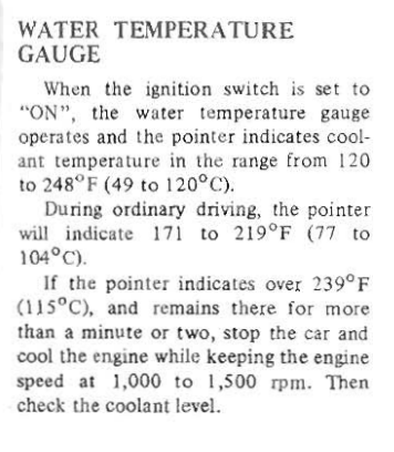

Zed Head Posted July 21, 2014 Share #24 Posted July 21, 2014 Pretty sure that Nissan knew the gauges aren't very accurate. That's why the "red zone" is just a tiny sliver at the very upper end of the range and the Owner's Manual describes essentially the whole sweep as normal. We should all probably have a better aftermarket gauge somewhere in the car, considering the damage overheating causes. Link to comment Share on other sites More sharing options...
