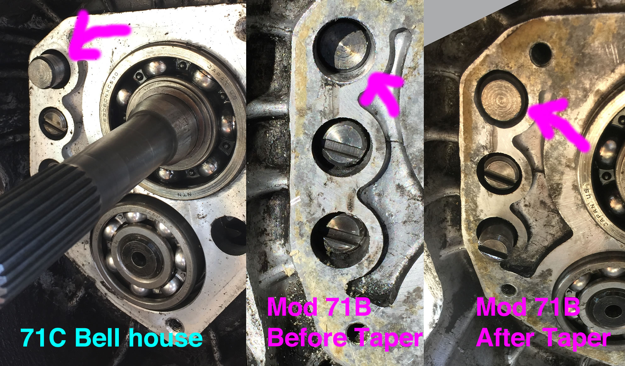

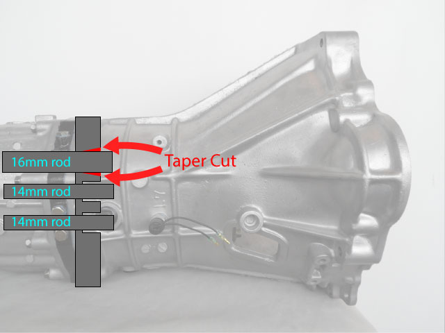

May 17, 20177 yr Author comment_521170 When I installed 71b Bell house, it was so tight to shift on 1st and 2nd gear. I compare with 71C and 71B bell house. Just enlarge to 16mm hole is too tight. I noticed there is some space for each rod. So, I taper cut the red section. It now easier to shift. Link to comment https://www.classiczcars.com/forums/topic/49659-90-240sx-fs5w71c-swap-into-75-280z/?&page=2#findComment-521170 Share on other sites More sharing options...

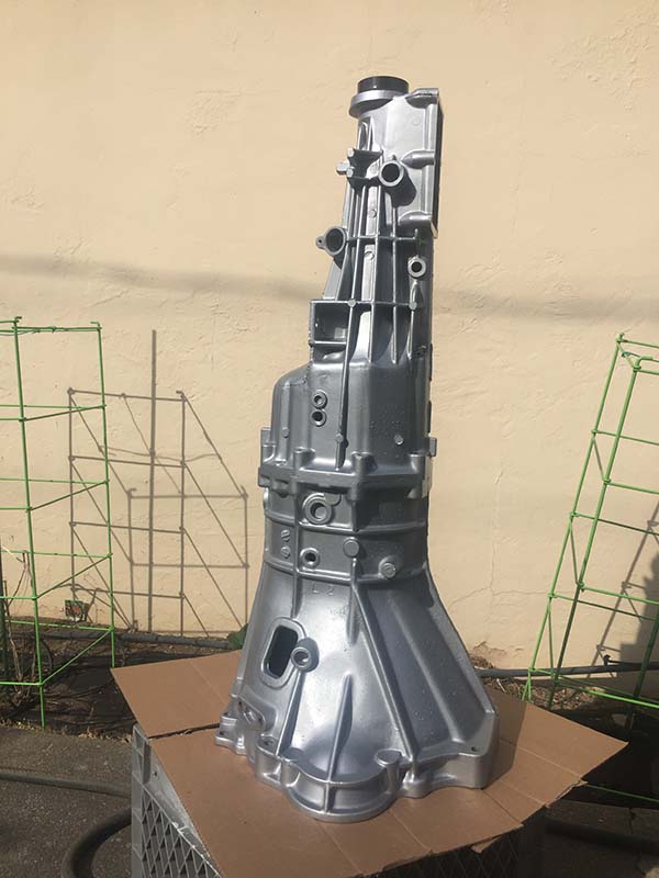

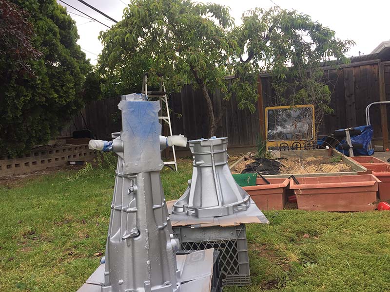

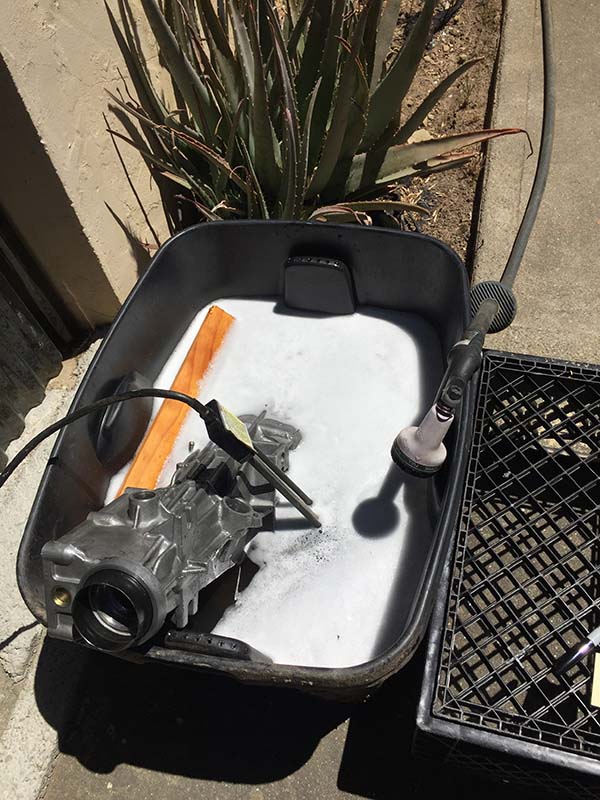

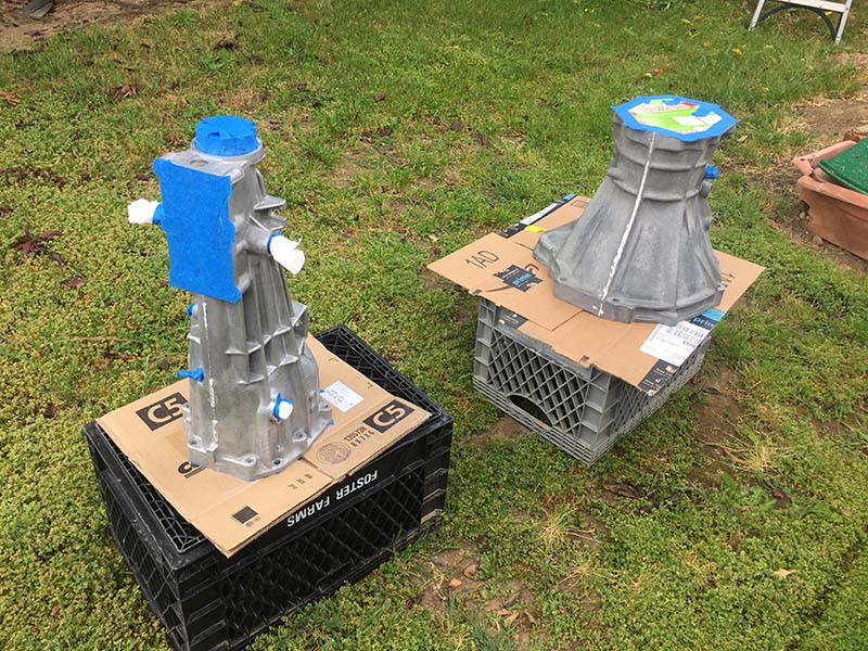

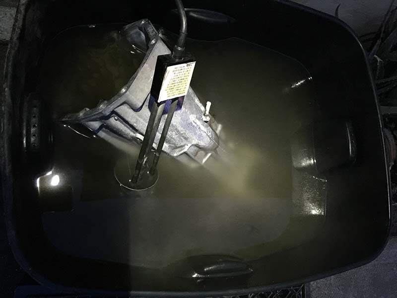

May 17, 20177 yr Author comment_521171 Now mechanical is OK. I started cleaning tranny case. Taking hot tub. over night. grind sharp edge Masking it. and paint it. I notice peach tree in my back yard grew up too much. Trim it while waiting for paint dry and finished. Link to comment https://www.classiczcars.com/forums/topic/49659-90-240sx-fs5w71c-swap-into-75-280z/?&page=2#findComment-521171 Share on other sites More sharing options...

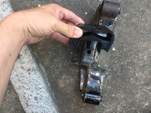

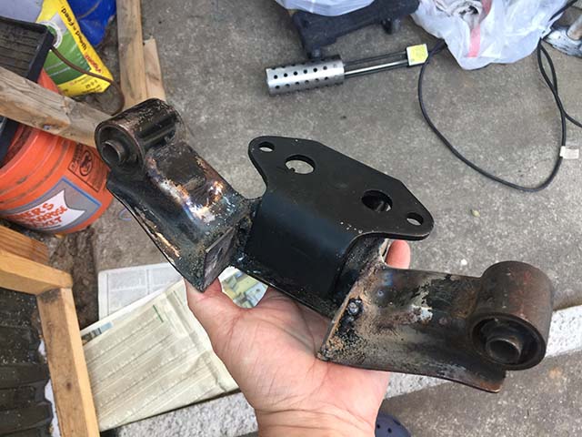

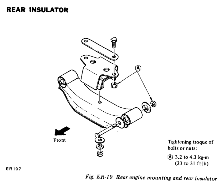

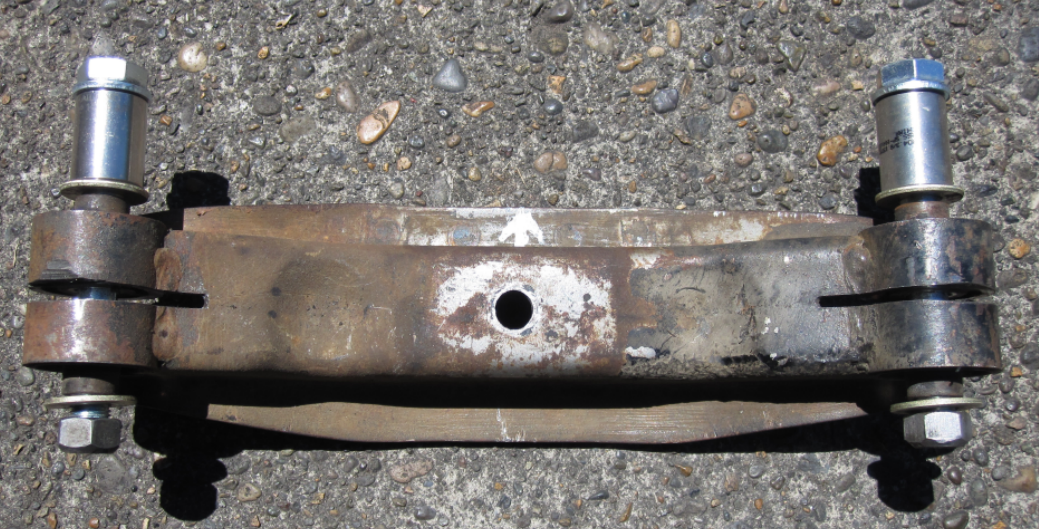

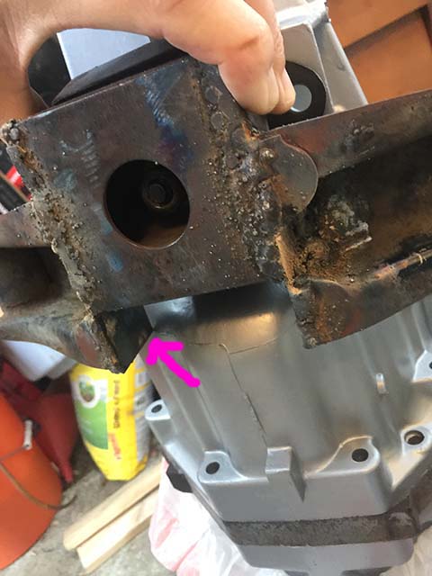

May 24, 20177 yr Author comment_521610 Finished Welding tranny mount. Fitting test. a bit touching with tranny. I need to grind the edge. by the way, which way is front? Link to comment https://www.classiczcars.com/forums/topic/49659-90-240sx-fs5w71c-swap-into-75-280z/?&page=2#findComment-521610 Share on other sites More sharing options...
May 24, 20177 yr comment_521611 Your top photo where it is facing towards the front has it in the right direction. It should be leaning forward at the top, if that makes sense. I can post a photo of mine later. I'm not sure why they made them like that. Maybe someone can explain why? Your bracket turned out nicely. Looks straight, and no distortion from the welding, which can happen easy on thin metal like this. Trim if up a bit and a coat of paint and it will look neat. Link to comment https://www.classiczcars.com/forums/topic/49659-90-240sx-fs5w71c-swap-into-75-280z/?&page=2#findComment-521611 Share on other sites More sharing options...
May 24, 20177 yr Author comment_521612 Thanks Chas for the info! Sent from my iPhone using Classic Zcar Club mobile Link to comment https://www.classiczcars.com/forums/topic/49659-90-240sx-fs5w71c-swap-into-75-280z/?&page=2#findComment-521612 Share on other sites More sharing options...
May 24, 20177 yr comment_521614 The sloping design might be to drive the tail of the transmission downward under braking or impact. Maybe. Hate to be my usual contrary self but I think the second picture might be the way. If I read the illustration correctly. Link to comment https://www.classiczcars.com/forums/topic/49659-90-240sx-fs5w71c-swap-into-75-280z/?&page=2#findComment-521614 Share on other sites More sharing options...
May 24, 20177 yr comment_521639 Mmm thats funny. Mine is backwards and the original, I replacdd as well. I can remember it binding a little when I tried it the other way around, so I checked the old one on some photo's and mounted it the same way. It's still a mystery to me why it's shaped like that. Link to comment https://www.classiczcars.com/forums/topic/49659-90-240sx-fs5w71c-swap-into-75-280z/?&page=2#findComment-521639 Share on other sites More sharing options...

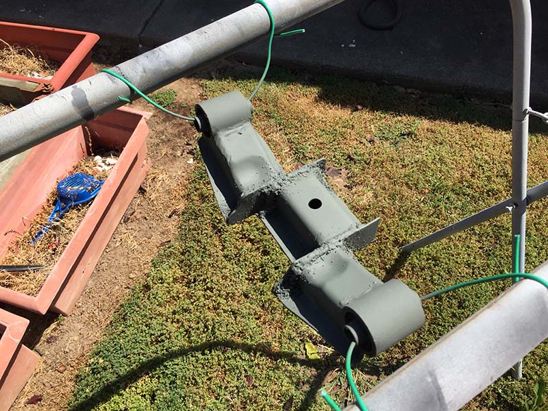

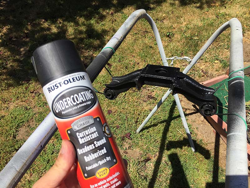

June 1, 20177 yr Author comment_522100 I grinned touching area and primed. and spray leftover undercoat. Tranny mount is completed. Link to comment https://www.classiczcars.com/forums/topic/49659-90-240sx-fs5w71c-swap-into-75-280z/?&page=2#findComment-522100 Share on other sites More sharing options...
June 1, 20177 yr comment_522132 Hard to tell for sure, but those welds don't look like they got much penetration.... Looks like you ran out of gas during the MIG welding. Hope they are good! Link to comment https://www.classiczcars.com/forums/topic/49659-90-240sx-fs5w71c-swap-into-75-280z/?&page=2#findComment-522132 Share on other sites More sharing options...
