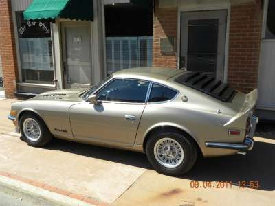

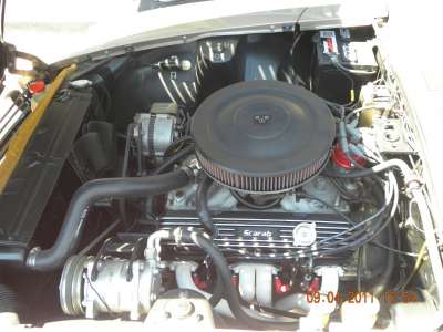

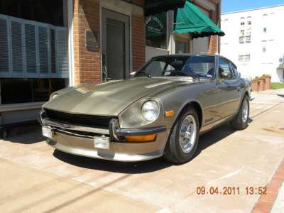

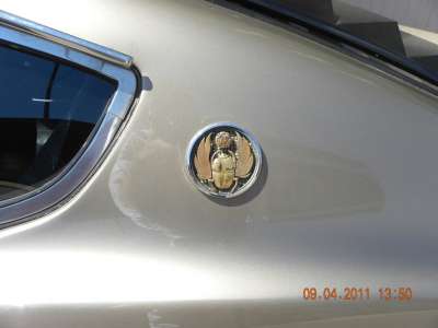

I guess you have forgotten or don't know about the Scarab. The earliest of V8 transplants. Today, Scarabs are worth very big bucks - in line with the finest of restored / original early cars. I don't think much of a V8 transplant, especially the more contemporary versions. Do an archive search for discussions about Scarabs.
I see the guy who built all the Scarabs in England at the VRG race events and I think Dan or someone should interview him.
I would like to hear from him as well.
I am aware of the Scarab Z's. I don't disparage V8's in our cars, but the Nissan 3.5's and 3.7's are no slouches. Besides keeping the Z's pure Nissan, there are several advantages to these engines/transmissions with modern fuel injection, tunable ECUs, and modern fuel compatibility.
