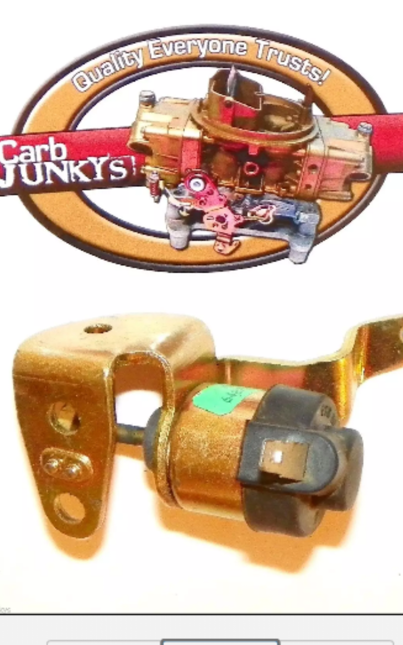

Why don't just buy something like this and make your own mounting bracket. The same power source for the AC compressor can power the solenoid.
http://www.ebay.com/itm/Idle-Stop-Solenoid-Rochester-Quadrajet-Carburetor-75-83-Buick-Chev-GMC-Pont-Olds-/331272717308
I suggested that same part to George way back in July. Same link. But George chooses not to listen to the advice given here and just continues to ask the same questions over and over again. He's now got three threads going on this, but refuses to take any initiative on his own. I'm done with offering him advice. Waste of time...

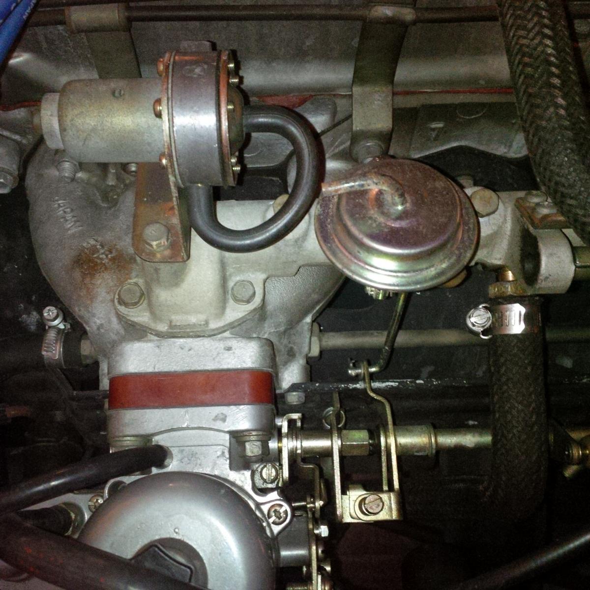

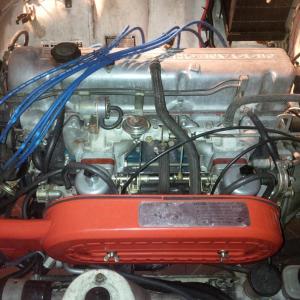

Just took a picture of what i have on top of my balance tube. If someone here has fabricated a base to mount a solenoid that can raise the idle without getting in the middle of the vacuum issues, i would like to follow said route!

I can see an easy spot right away. You have a vacuum pot that is connected to the carb linkage and that vacuum pot is not being used.
I would utilize the vacuum pot's mounting point as a base for the electric solenoid. Note that the linkage on there is  designed to pull up, so you either have to mount the solenoid upside down or change the direction on how the linkage operates.

1: You could mount the solenoid above the main throttle push-rod and have plunger contact the plastic end cap directly. Mount may be a bit difficult but you could bolt to Intake manifold. Properly designed ( with an anti-rotation lug ) a single stud on the Intake manifold would work.
2: Mount the solenoid so that it actuates the throttle at the Bell-crank on the Firewall
3: Mount the solenoid inside the car so that it actuates at the accelerator pedal linkage.
Use you imagination. Lots of possibilities. It doesn't have to be pretty at first. Just functional and strong. Now get your butt in gear and start thinking!. Just do it!!
