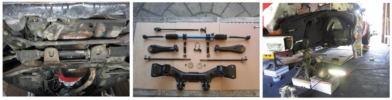

I have a related question. I am rebuilding the front suspension on one of my cars (78 280)- strut inserts, bushings, ball joints, tie rod ends, motor mounts, etc. Like a lot of our cars, mine has very little paint left and a bit of surface rust on the suspension pieces, crossmember, etc. My plan, therefore, is to have the suspension pieces powder coated while I do the project. I would like to avoid removing the engine but would like to have the crossmember powder coated as well. After reading this thread, I am contemplating doing the following.
1) Have a spare crossmember powder coated.
2) Remove everything from the front suspension- control arms, struts, tie rod ends, t/c rods, roll bars, steering shaft, everything.
3) Follow Chas' process above for removing the motor mounts but also swap crossmembers.
4) Proceed with balance of suspension rebuild.
Do you guys see any roadblocks in this plan?
Jon
Jon,
I did more or less the same thing you are planning to do.
I used a Z jack so it wouldn't take up too much room and rope from both strut towers stop the engine moving around.
Chas
