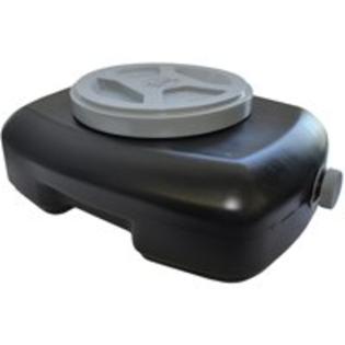

I bought one of those oil drain containers with the screw-on cover for the coolant, but the darn thing won't fit under the car! If I cut off the threaded neck, it would probably fit, but I'd still have to transfer the old oil to another jug.
