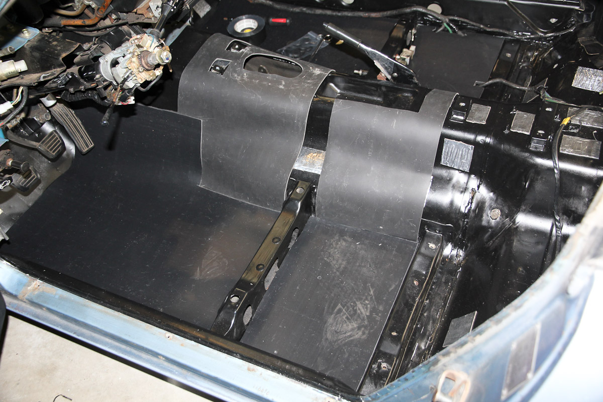

After 8 years of fits and starts restoring "Buttercup", a 7/70 build date 240Z (#7032) it has come down to the interior, which was completely stripped and the old tar mat removed.
While "Murdermat", "Fatmat", and the like are what are commonly used as upgrade/replacement--- I wanted the original deal--- as close to the factory fitment as possible. <snip>
That is practically artwork there.   When I start my projects I picture them looking like that but when done they rarely do.  Definitely some real skill and patience involved.
