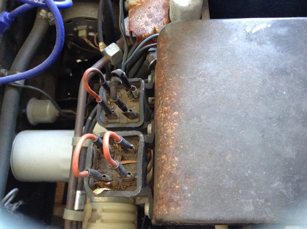

August 18, 201410 yr comment_453693 You probably installed the battery with the poles reversed. If you are lucky, you only fried the fusible links.Step 1: Buy new fusible links. (Remember there is a 5th link not in this shot.)Step 2: Replace the fusible links.Step 3: Use an ohmmeter to figure out which battery cable is the negative. It will be the one that has about 1 ohm resistance to the chassis ground.Step 4: Mark the negative cable so you remember which one it is. A stripe of colored electrical tape would work nicely for that.Step 5: While having a fire extinguisher close at hand, re-install the battery. Put the positive cable on the positive terminal of the battery. Put the negative cable on the negative terminal of the battery.Step 6: Figure out if you burned up anything else. Link to comment https://www.classiczcars.com/forums/topic/49873-installing-new-battery-turns-into-fryer-fire/#findComment-453693 Share on other sites More sharing options...

August 18, 201410 yr comment_453695 The big heavy cable running from the starter solenoid to the battery (held on with a nut)... is it on the battery terminal closest to the starter or the one under the inspection cover?It should go the the positive battery terminal.If you don't have the covers for the fusible links, I would invest in them, they are cheap. Link to comment https://www.classiczcars.com/forums/topic/49873-installing-new-battery-turns-into-fryer-fire/#findComment-453695 Share on other sites More sharing options...
