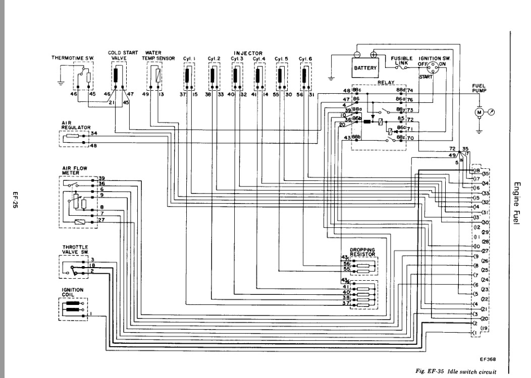

August 30, 201410 yr comment_454400 Make sure that there is 12 volts on each pin of the injector connectors, removed from the injector, with the key On. It will seem weird from an Electricity 101 perspective, but one side is power and the other side is the transistor circuit. Probably a pull-up circuit of some kind (unresolved in other threads). Both pins in each connector will show voltage if the ECU has power and things are correct.There's no pull ups on the injector outputs inside the ECU. However, unless you pull all the injector connectors off at the same time (at least all the ones that share the same transistor) you'll read 12 back feeding through the other injectors and their dropping resistors.In other words, for example... If you pull the connector off injector #2 and probe the contacts for voltage WRT ground:One side will read 12V because it's pulled up to Vbatt through it's dropping resistor.The other side will ALSO read 12 volts because it's pulled up through the solenoid coils of injectors #1 and #3 through THIER dropping resistors to Vbatt.If you pull all the injector connectors at the same time, you should be able to determine which side is hot and which side is pulled to ground by the ECU.Does that make sense? Did I say that right? :bulb: Link to comment https://www.classiczcars.com/forums/topic/49933-78-280z-no-injector-pulse/?&page=2#findComment-454400 Share on other sites More sharing options...

August 30, 201410 yr comment_454411 There's no pull ups on the injector outputs inside the ECU. However, unless you pull all the injector connectors off at the same time (at least all the ones that share the same transistor) you'll read 12 back feeding through the other injectors and their dropping resistors.In other words, for example... If you pull the connector off injector #2 and probe the contacts for voltage WRT ground: One side will read 12V because it's pulled up to Vbatt through it's dropping resistor. The other side will ALSO read 12 volts because it's pulled up through the solenoid coils of injectors #1 and #3 through THIER dropping resistors to Vbatt. If you pull all the injector connectors at the same time, you should be able to determine which side is hot and which side is pulled to ground by the ECU. Does that make sense? Did I say that right? :bulb: I can't say myself, because I generally describe the 12 volts on each side as "transistor weirdness". Not an authority. Sounds reasonable though, I think that you're saying the 12 volts is "backfeeding" through the transistor that controls those injectors. So it should be groups of three then. Added a diagram just for ambience. Of course, it doesn't show the transistor circuits but it does show how all injectors are powered and feed back the ECU. Added another diagram. I had a 78 that had the combined EFI/Fuel Pump relay, like 1976. Just for reference. Virto will probably not need to go that deep. Edited August 30, 201410 yr by Zed Head Link to comment https://www.classiczcars.com/forums/topic/49933-78-280z-no-injector-pulse/?&page=2#findComment-454411 Share on other sites More sharing options...
August 30, 201410 yr comment_454422 You don't backfeed through the transistor. You backfeed through the other injector(s). Maybe these sketches will help with the weirdness. Here's why you would see +12 on both sides of the injector connector if you pull just one: And here's why you should be able to determine which side is which if you pull all of them (or at least the ones that share a transistor): Link to comment https://www.classiczcars.com/forums/topic/49933-78-280z-no-injector-pulse/?&page=2#findComment-454422 Share on other sites More sharing options...
