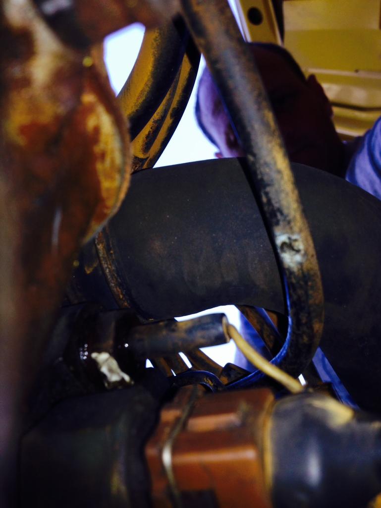

Probably the tube through the intake manifold. Coolant goes from BSPT hose barb in lower thermostat housing to BSPT hose barb at front of intake manifold, through the tube, to Hot=closed thermostat, to short hose, to metal tube at back of engine, to short reducer hose, to the tee on the right side of the block.
If it's the tube through the intake manifold, you can (maybe) buy a used manifold with good heater tube, or take it to a good machine shop. Otherwise plug the thermostat housing and cap the tee on the right side (rubber tapered plug and/or silicon cap). Those tubes get all corroded and beyond repair.
If it's the tube around the back of the engine, buy a new one (expensive), or use some good heater hose instead.

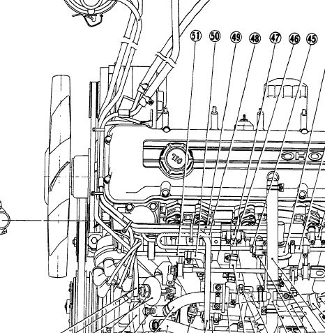

I don't know if I picked the right pipe, but your dealer might have better microfiche. You can't tell if it's really available until you place an order though.
I picked #56 - Datsun 280Z Cylinder Head, Rocker Cover & Thermostat L28E
PIPE WATER :: Nissan Parts, NISMO and Nissan Accessories - Courtesyparts.com
