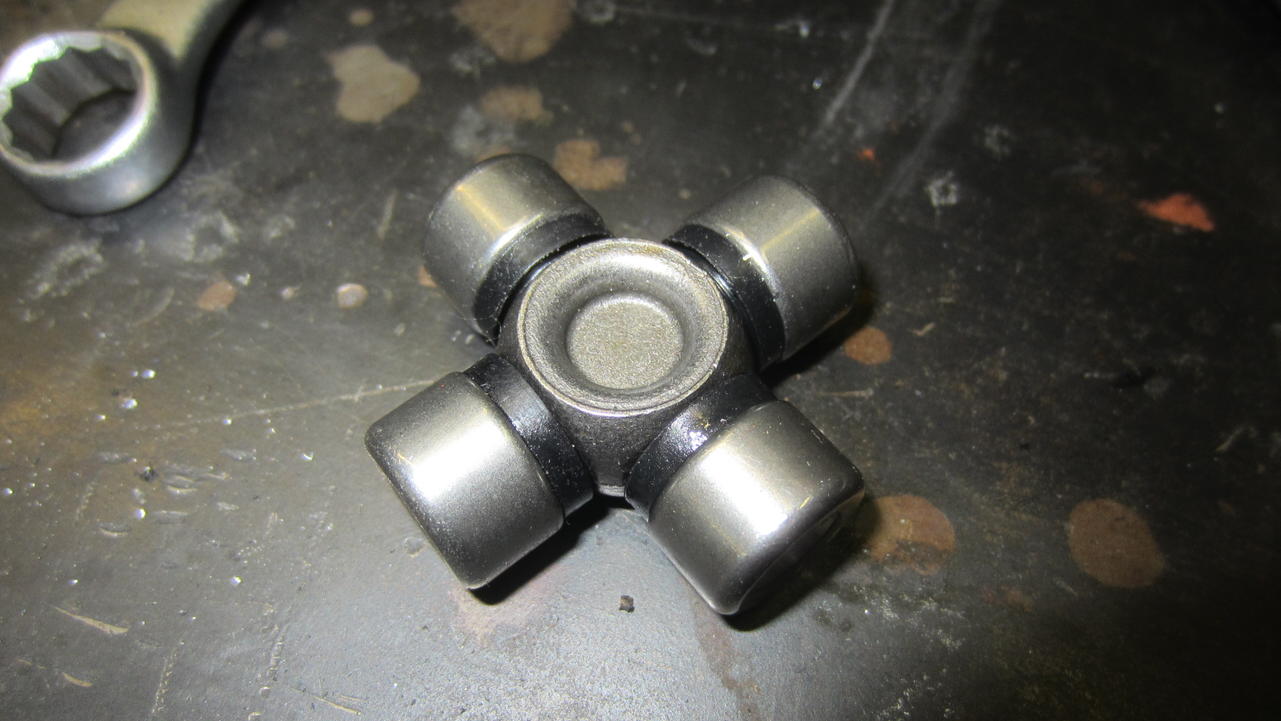

Something came in the mail yesterday. It's a lovely 15x40mm u-joint. I believe we have a staked u-joint replacement option. Way to find a good one CanTechZ!
I've confirmed the cap OD is nearly identical to the stockers.

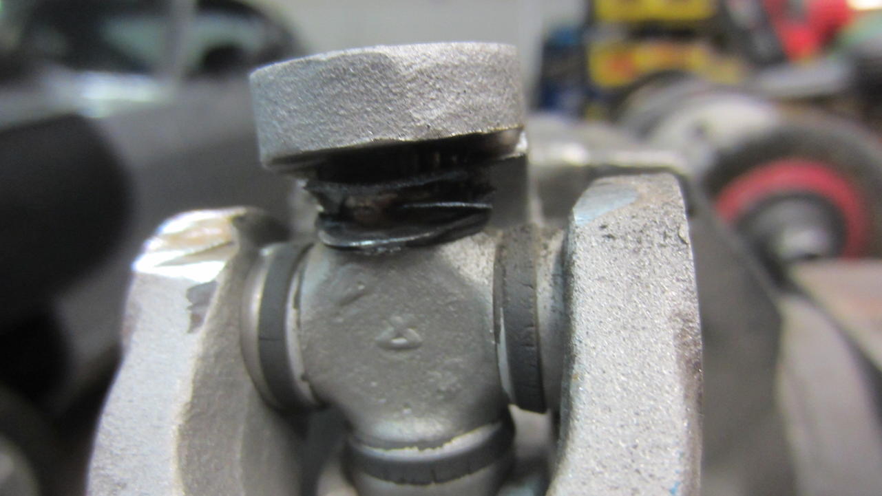

Truth #1. You cannot disassemble the yokes without distroying the u-joint. You can't drive the caps inward far enough to get press the opposite one out far enough to grab it to remove it.
Good thing there is enough room to cut right through the yoke legs with a 4 1/2" cut off wheel. Once the yoke center section is gone, just pound the caps through to the middle to remove them.

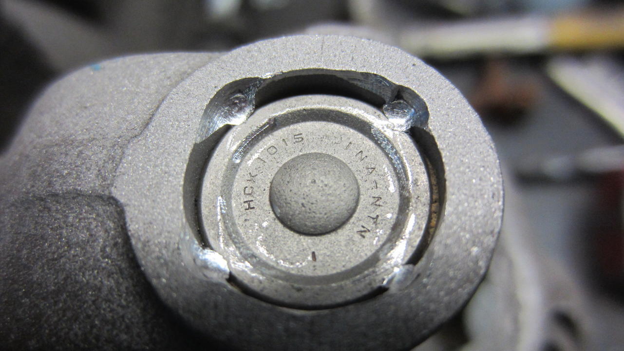

Begin by cleaning the cap area very well (sand blasted in the pictures) then dremeling off the little peened in ears with a small carbide rotary bit.
Remove the yoke by cutting through the legs with a cut off wheel.
Clean up the staked areas to ensure no protusion into the cap bore.
