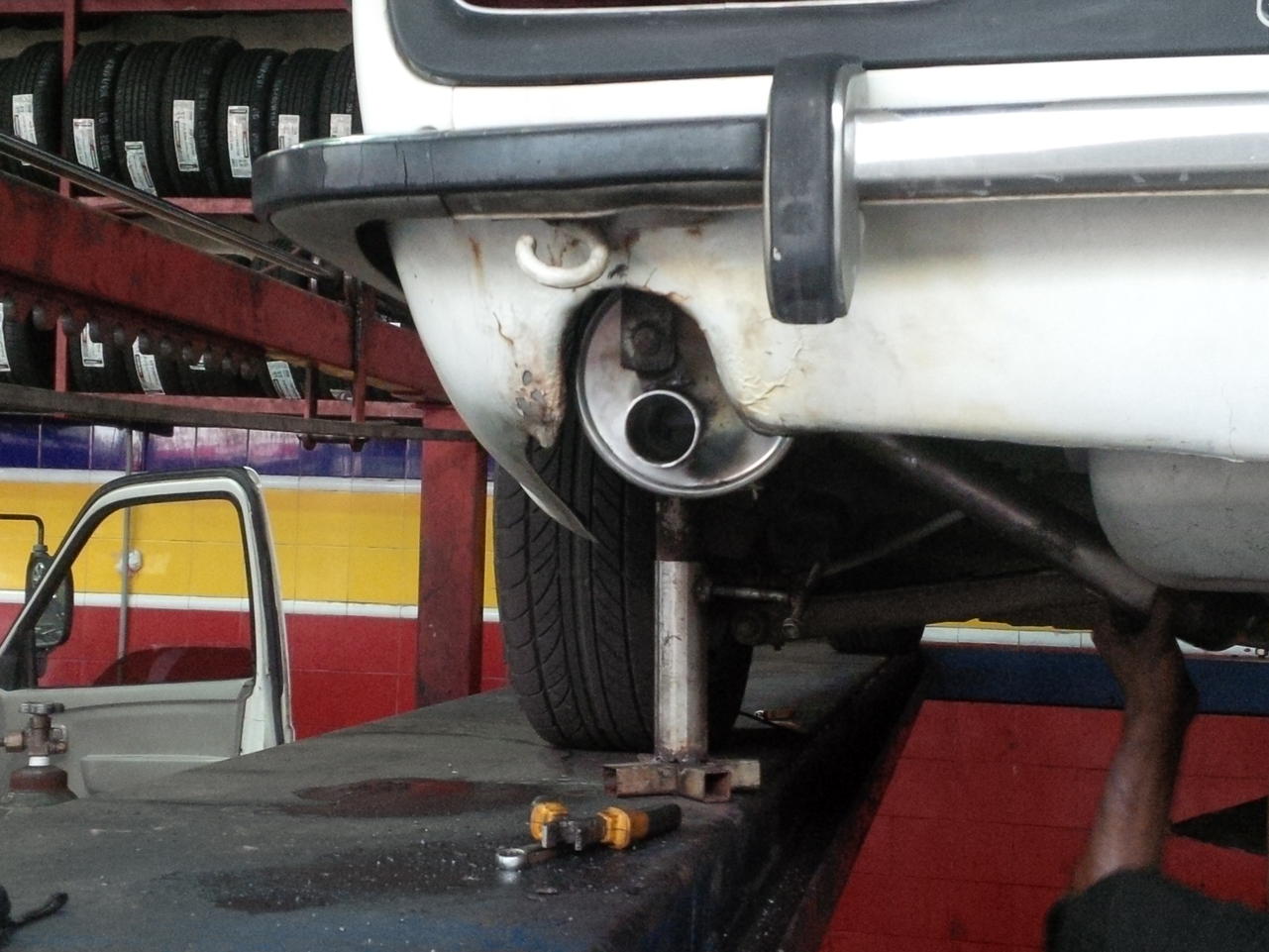

As per my previous post, last week i removed the following muffler which has 2" inlet and 2"outlet from my car due to its size and fitment besides the gas tank:post-29967-14150830065607_thumb.jpg

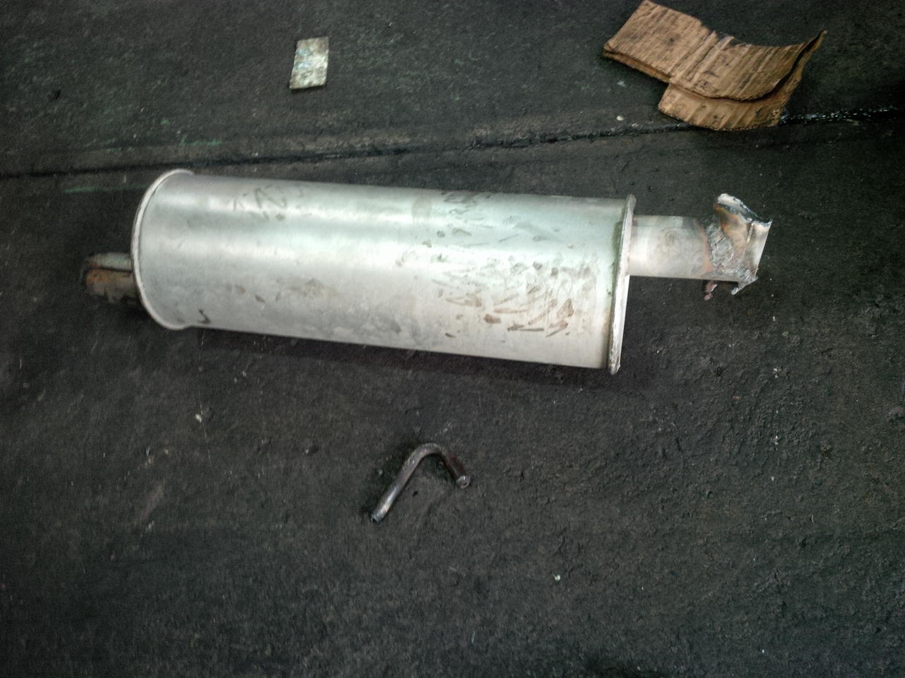

Anyway, i swap this muffler for a smaller 14" long muffler with 1 3/4 inlet and outlet 1 3/4:
When driving the car home i noticed the car had lost power and you could hear explosions under the car. I decided to park the car for a couple of days until i could take it to another shop where i found a Dynomax Super Turbo 2" inlet and 2" Outlet muffler. The car now gain strenght but according to my mechainic was running in 3 cylinders only with random explosion noise after shifting to 2nd gear.

1 3/4" inlet/outlet is pretty close to what the OEM muffler is - so unless there was something inside that second muffler that had collapsed.. or was shutting the exhaust flow off almost completely - - it is very doubtful anything would be harmed at the engine.

I would like to know more about the "internal explosions" taking place in the engine that you are talking about. Our engines by their very nature have internal explosions to run a they are internal combustion engines. I agree with Carl that unless there was an issue with the muffler itself you should not have any issues. I wonder if you mean "pinging" is what you heard by the internal explosions. If so, this would happen at higher RPMs and could be due to many factors such as incorrect timing, lack of fuel, or using low octane gas to name a few. Just looking at the pictures above, the 90 degree elbow at the inlet of the muffler was definitely hurting flow and performance but should not make an engine run on only 3 cylinders.

Rather than relying on the manufacturer's claims, unless you have personal knowledge, I would rely on my local muffler shop to choose a muffler that won't restrict flow, and won't be too loud. They should have plenty of experience as to how a particular muffler will sound, perform and fit. Also, there are some good threads on this site about specific muffler and exhaust pipe combinations, but what someone else thinks is perfect might be too loud for you (and your local PD).
I've heard to use 2 1/4' exhaust pipe for 240Z engine, 2 1/2" exhaust for 280Z. From your previous posts, you have a built engine with a cam that works better in a higher rpm range. That means if you're driving 30 mph in high gear, performance might not be great.
If you choke it off with a muffler or exhaust pipe that's too small, performance will be even worst. Your experiment may have confirmed that.
