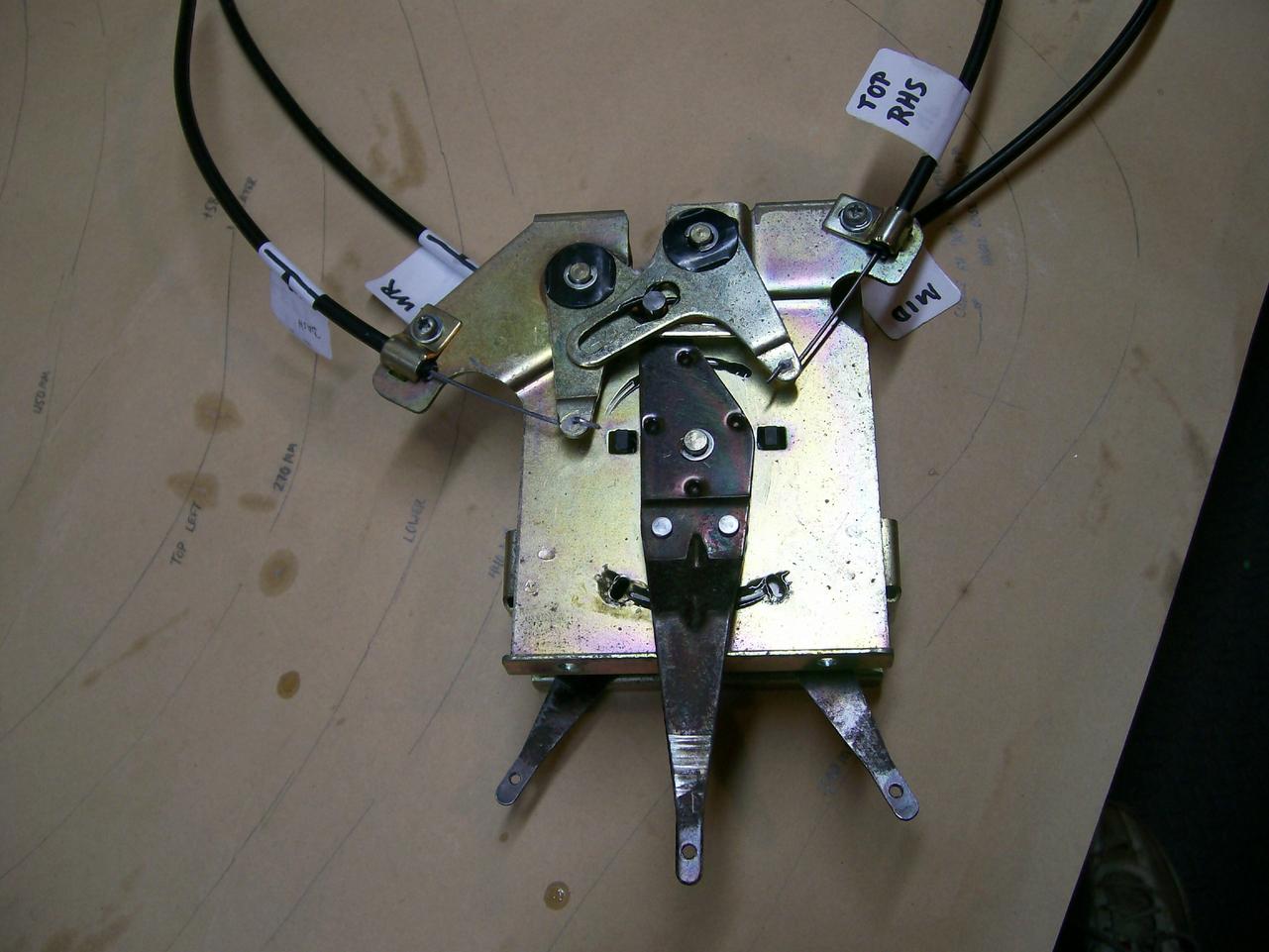

My car is a 8/70 build 240z. The control cables look like old aftermarket choke cables from an auto parts store. The outer sheathing is coiled metal, not plastic. I am missing 1 cable and another is bent up so I am thinking of replacing all 4 to regain smooth operation of everything. I am also missing a cable clamp. Can anyone verify if these are factory cables? I personally don't see any value in keeping them since their lack of function is limiting the overall function of the heating system.
post-21286-14150830070524_thumb.jpgYou're right. Those cables aren't OE. I re-built the cable/lever system for my '70 Z last winter, having had a very similar issue with a bent-up control cable (along with a few other problems). I also had parts on hand from a '72. Here's what I learned.
The control cables for the '70 are 1.0mm diameter. The cable ends (at the Heater Box) are straight. Cable sheaths are smooth black flexy-plastic, ~ 4.7mm OD and ~ 1.0mm wall thickness.
The control cables for the '72 are 1.3mm diameter. The cable ends (at the Heater Box) are looped. Cable sheaths are the same smooth black flexy-plastic, ~ 4.8mm OD and ~ 1.0mm wall thickness.
For the '70, the cable sheaths were in good shape, so I re-used them. For the cables, I bought a coil of 1.0mm tempered steel wire ('music wire') and put the 'dog-leg' bend in (for the lever end) by bending in my bench vise. I had to take the curl out the wire (comes in a tight coil) by pulling the cable back and forth over a length of round bar stock that I clamped in the vise.
Hope this helps. I've posted a few pictures of the '70 lever/cable assembly to illustrate.
