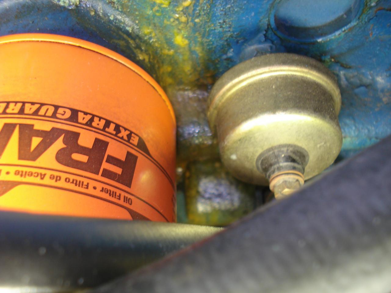

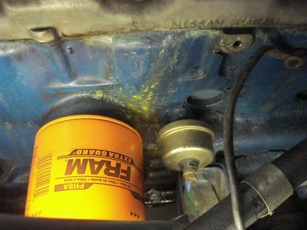

So after several months of running the alumaseal through the cooling system of my 77 280 I still have a coolant leak between the block and head.post-21454-14150830080467_thumb.jpg I have contemplated re torquing the head bolts but am a little nervous. The last time I had the head off was in 1997 or there abouts. So its been awhile. Has anyone attempted this and what were the results? I was thinking of just breaking them loose (just barely) and then re torquing, in proper sequence of course. Im nervous because I believe I could take a chance of cracking the head if my leak is caused from a warped head. Ideas, experiences, and suggestions are appreciated.

That's a bummer. I can't remember if you said the engine had ever overheated but you might consider having another head ready to swap on. Depending on how many miles are on the current head and the odds of warpage. My leaking head didn't show any signs of combustion chamber leakage but is about .007" bent. Bowed up in the middle, but it leaked on the end.
Retorquing won't crack the head, they're actually pretty flexible. The odds are probably against it fixing the leak though. I would just check the torque on each bolt to see if you had some loose ones that might explain the leak. Start with a low number and work up to spec. Good to know anyway, for future work. Maybe you had an older style gasket that was supposed to be retorqued after a few miles and wasn't, allowing a leak to develop.

Zed, no on the overheating. The current head has 197,000 miles but had a valve job 97,000 miles ago. I do recall retorquing the head after so many miles when I had the head rebuilt. It was resurfaced but the block was not because the machine shop said it was "good", IIRC.
