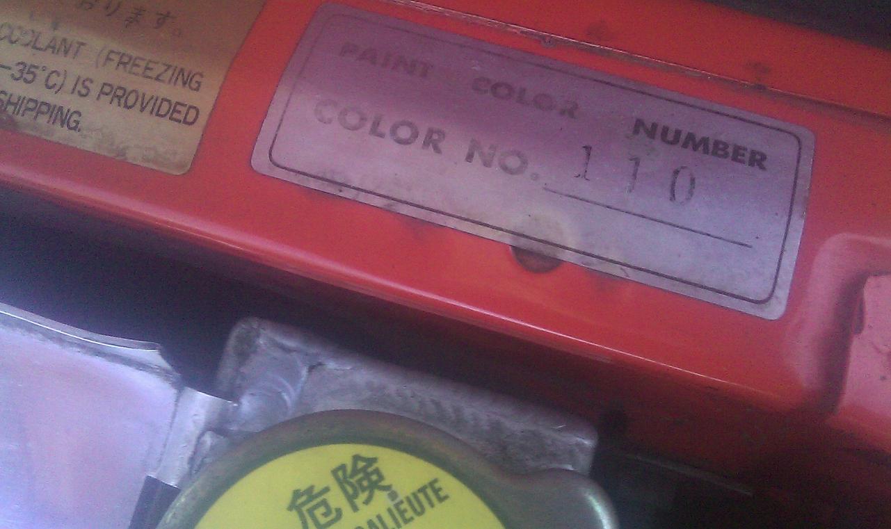

I have done some minor rock chip repair, sanding, POR15 on the front lower valance and bottom of the fenders.
My car is 110 red, which is really persimmon - orange, does anyone have experience with the color match from automotivetouchup.com?
For 1977, they do not show 110, but they do for the 72 & 73 240. I suppose I could call them.
