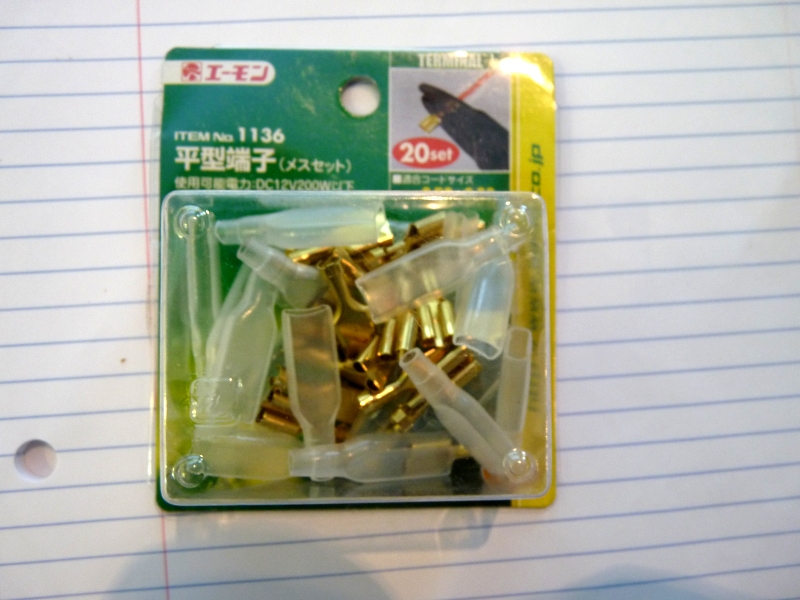

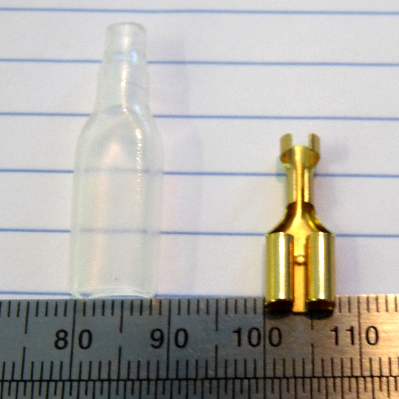

Hi Jeff
I picked these up at a shop like an Autozone in Japan last year.
If they will work send me your mailing address and how many you need and I will send.
They are rated 12V 200W (~16.7A DC)
I have some of the female terminals (same size as on the fusible links - I believe). I will send you some if you PM me your address. How many do you need, I'll see what I can do...
