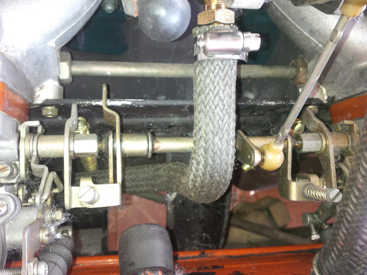

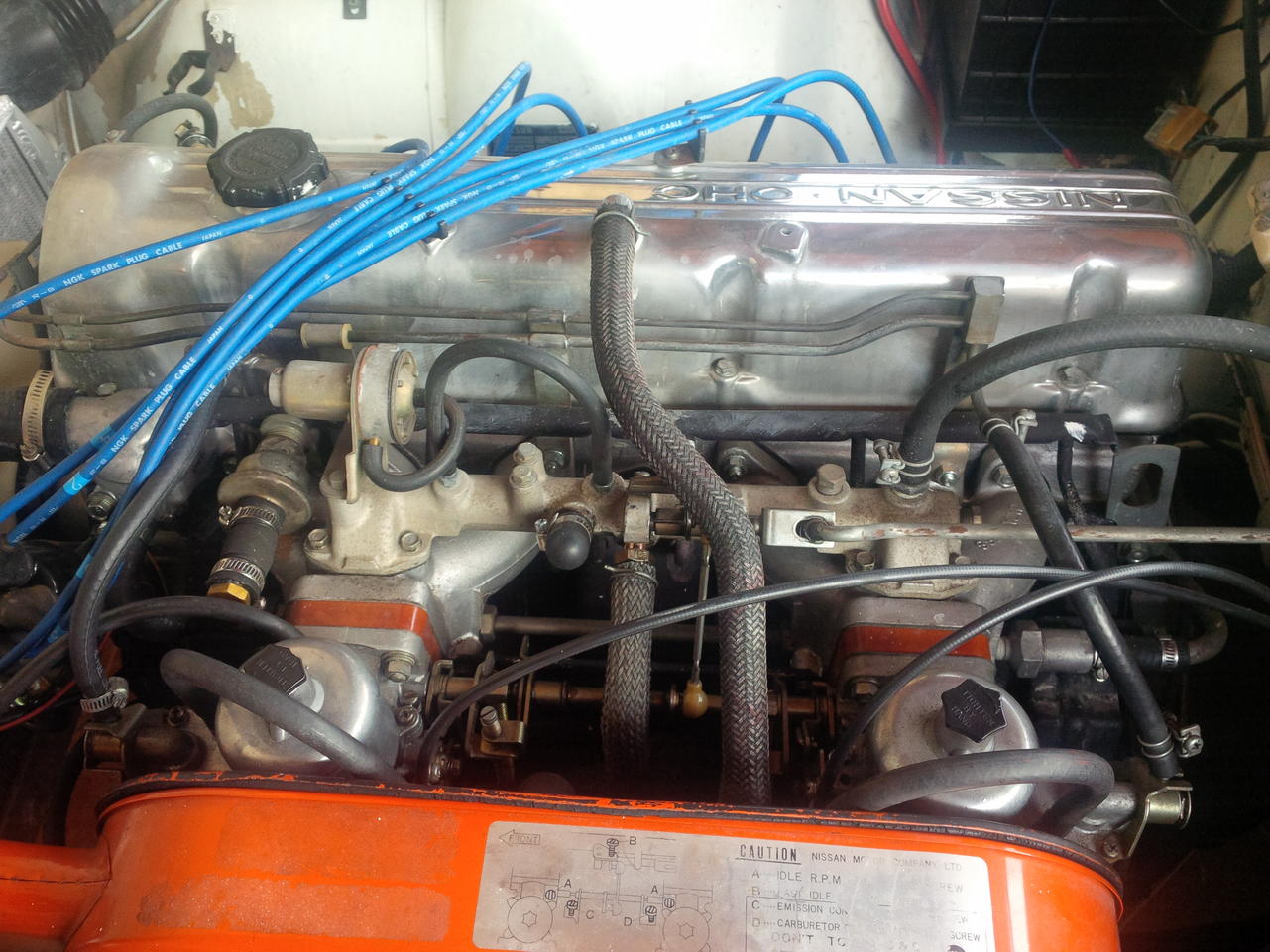

You might try raising the idle speed to keep it running, while you do more diagnostic work. The rusty screw next to the thing that had the wrong hose on it (Post #5) is the idle adjustment. Turn it out to let more air in and the idle speed will increase. Might be enough to let it idle. Then you can use the old trick of spraying carburetor cleaner (carbs!, yay) around the various spots where there could be a vacuum leak. Injector seals to the manifold, intake manifold/head interface, PCV hose, EGR fittings, etc. If idle speed changes while you spray the outside, that means there's a leak. Keep fixing them and things will get better.
Sounds like vacuum issues to me too. Of course when you did the headers, you had to at least unbolt (maybe not remove) the intake manifold. Did you re-gasket both? These engines are notorious for their rusty studs and leaks around the #6 and (to a lesser extent) #1 intake runners. In fact on my engine, my #6 exhaust was blowing right into the #6 intake -- sort of an enhanced local EGR thing going on. ;)
I'm guessing all your vacuum lines are a lot more raggedy than you think. It's a cheap and easy project to replace the whole, sorry mess with new lines. Go buy a bunch of hoses/tubing at your local auto parts store, and go to it! Follow the diagrams in the factory service manual (far, far, far better than Hayes or Chilton's), which you can download for free here:

I did change the idle screw and now it'll run for about 30 seconds, and a lot healthier, so it is getting better. I can hear what sounds like a vacuum hiss when the engine is running so now I guess I just need to track the hiss down. Sounds like it's coming somewhere over the #1 and #2 injectors
It does idle now for the most part. Still sounds rough and stumbles and stutters and dies sometimes when I give it gas. I used a new intake/exhaust manifold gasket for the install. I also just noticed I do not have any clutch pressure. I don't know if it's related but the clutch was working fine before this all happened.
Carb cleaner does work if there's a leak. Idle speed will change when you spray it on the leak.
The spraying of the carb cleaner is most effective on EFI systems. With carbs, you would spray at any connection points between the carbs and the head. The gasket surfaces and any vacuum hoses, like the big one for the brake booster.
Seems like the #1 and #2 manifold bolt wasn't tightened down enough. Tightened it up even more, played with the idle screw and timing a bit and now it runs. Ran for 10 minutes straight with no issues. I have some fine tuning to do, but for now I'm just glad it runs. Now I think I have to replace the clutch slave and lines, I think they deteriorated from not being used, but that should be pretty quick and easy.
