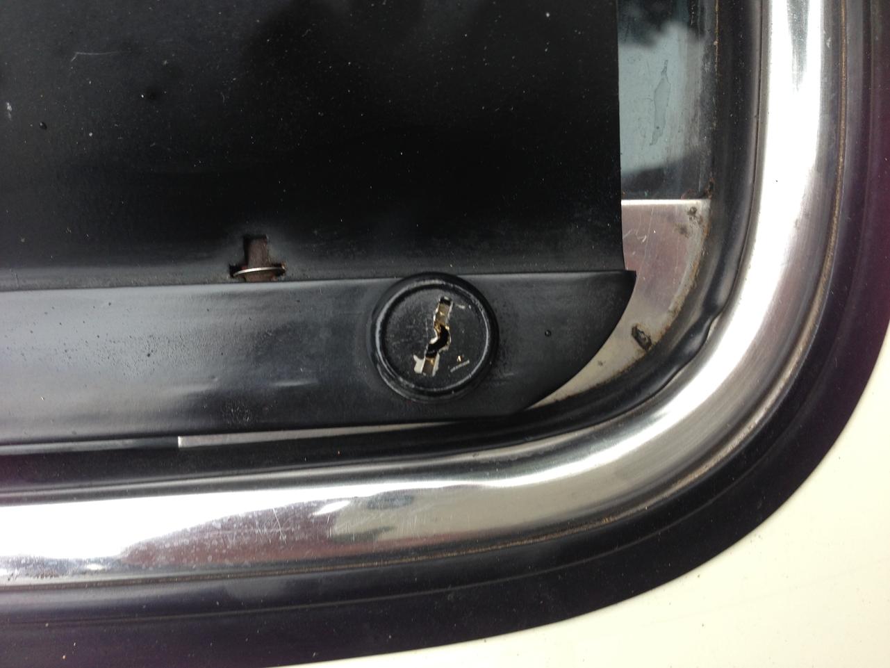

Posted October 13, 201410 yr comment_456935 Looking for a way to turn these louver locks. Edited October 13, 201410 yr by Burl Link to comment https://www.classiczcars.com/forums/topic/50208-interpart-louver-key/ Share on other sites More sharing options...
October 13, 201410 yr comment_456940 I had these same louvers on my 1st Z and that's the correct key. You should be able to make a key pretty easily. Link to comment https://www.classiczcars.com/forums/topic/50208-interpart-louver-key/#findComment-456940 Share on other sites More sharing options...
October 13, 201410 yr comment_456946 I made one out of a piece of radiator hose clamp with a sement ground off in a bench grinder so that two ears stick out. Hope that made sense. Link to comment https://www.classiczcars.com/forums/topic/50208-interpart-louver-key/#findComment-456946 Share on other sites More sharing options...

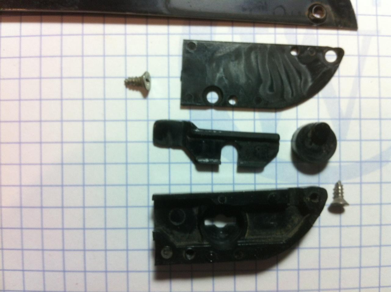

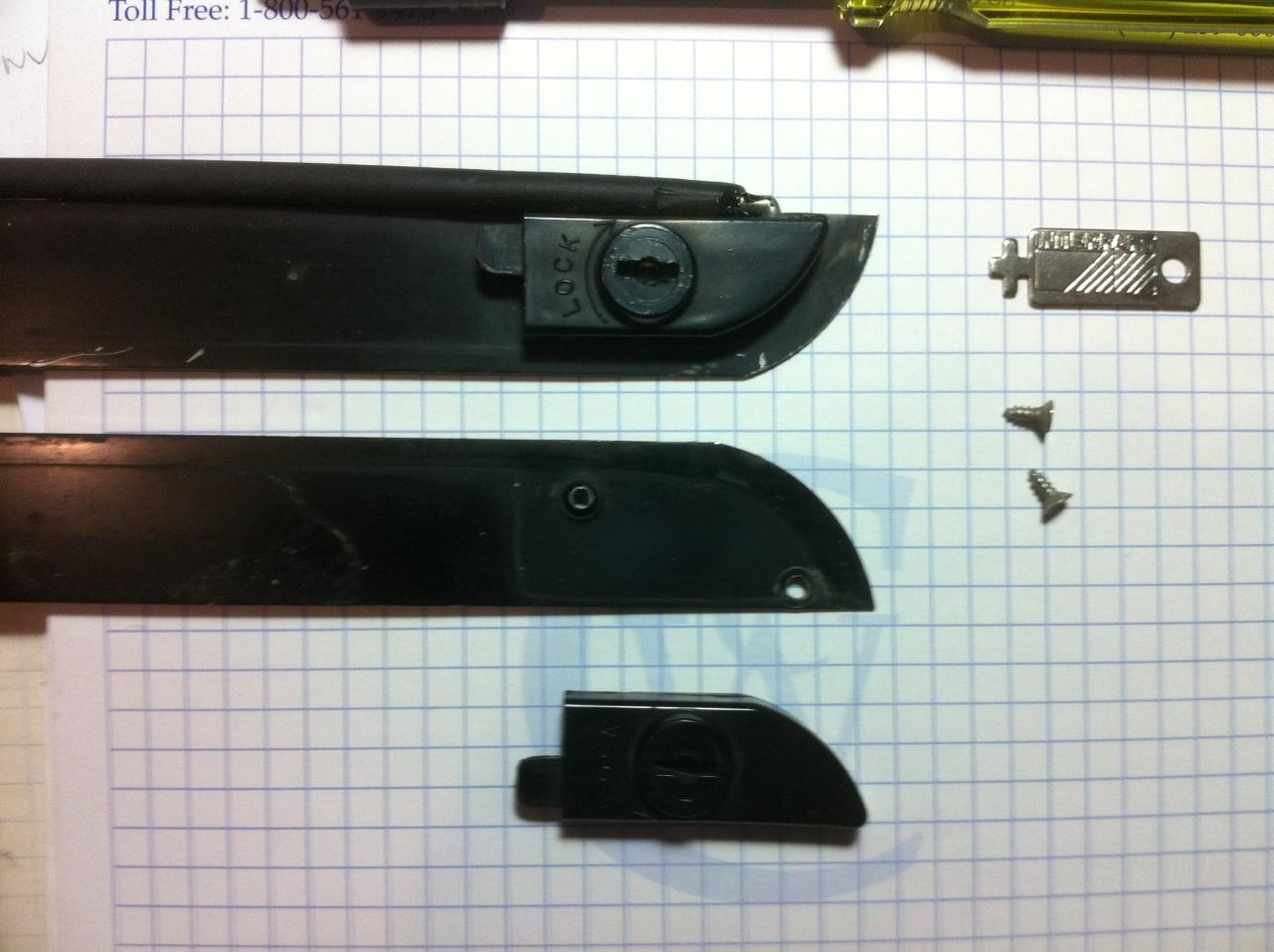

October 13, 201410 yr comment_456985 Here are couple of pics of the Interpart lock assembled and disassembled. I am currently learning how to use Solid Works and I'm getting tired of doing tutorials so if it would help to have a 3D cad model/drawing for any of the lock parts I don't mind doing it as a learning experience. Let me if this is of interest and which parts are broken on your locks. These are plastic parts so maybe they could be 3D printed if the resolution is high enough. Now that I have cleaned out the fine dirt from the locks it surprising how much better they function. Mike Link to comment https://www.classiczcars.com/forums/topic/50208-interpart-louver-key/#findComment-456985 Share on other sites More sharing options...
