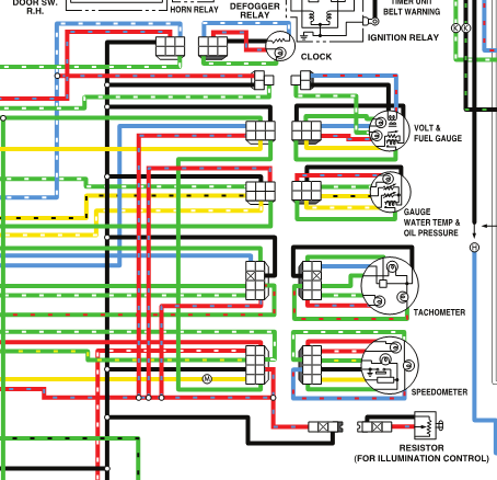

The potentiometer would just provide the final path to ground. Each bulb's resistance stops a dead short from happening when the pot. is at zero resistance. So the theory that there's a short in one of your gauge bulb plugs or one of the other bulbs controlled by the pot. seems to fit. It would be a different kind of short, not to ground as usual, but across the intended load. The pot. just completes the circuit.
It's odd though that you've had two potentiometers that are off-on instead of a gradual resistance. Hard to see how a short in the circuit before the pot. would cause that. Since you can remove the plug, a $3 Radio Shack potentiometer might show something. Maybe you got two bad potentiometers.
You didn't mention year of car. I added a 1976 picture, but the early cars had some odd wiring schemes.
Edit - may not change much, but the potentiometer may not actually go to zero resistance. The diagram shows a direct power feed to the pot. itself. So the final resistance in the circuit may be the pot. illumination light itself, if there is one. Or the diagram may be incorrect.
Edit 2 - the electrical guys already knew this but the above (italics) is wrong thinking, That extra red circuit is just the ground for all of the other lights like the AC.heater controls and cigarette lighter. There are a lot of lights on that potentiometer. Any one of them could be the short.
Edited by Zed Head
The pot doesn't go OFF-ON instead of gradual. He's got a very low resistance connection somewhere between the output of the pot and ground. That connection is sinking away most of the current through the pot and only a small amount goes through the illumination bulbs because their resistance is higher than whatever is shorted. (Think voltage or current divider between the short and everything else.)
So when the pot is cranked to full brightness, there's just enough current through the bulbs to get some light out of them even though the improper connection is sucking down most of it.
But when you start cranking the pot away from full brightness, the current drops and the bulbs go dim. Bulbs are still passing the same percentage of the total current, but it's not enough to glow the filaments.
Even with the pot turned a little off full bright there's still lots of current flowing through the pot (too much in fact), but not enough to glow the filaments or blow the fuse.
At least that's my read... Electrical troubleshooting is very hard from afar!
I'm glad the good Captain got me thinking. (The thinking part happens rarely.)
I'm used to diagnosing long distance. The most likely problem is a short around a bulb base in the dash lights. The next likely culprit is in the splices in the dash harness. You could also look at the connectors for the lights on the speedometer and tachometer since the positive and negative pins are next to each other. (Ref page BE-16 of the 260Z FSM)
Bruce hit it perfectly. The short is bypassing the load on one of the branches of the circuit.
