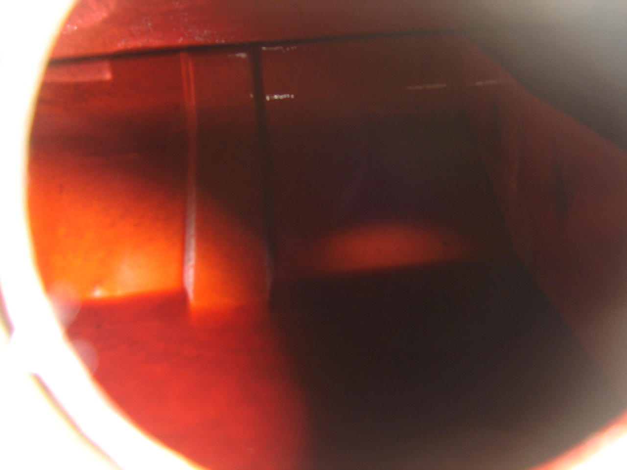

The PO cut the return line for some reason, as misguided as that might have been. It might be that the return line is blocked with rust. You might even have a bit of that issue with the supply line. You should investigate those possibilities. Also, is that some sort of red goo in the bottom of your tank? I'm not quite sure what I'm seeing in that photo. Red goo could be betty betty bad. Or maybe that's some sort of gas tank sealer? Is it gooey or hard? Is there rust and dirt in whatever you drained from the tank? Is there red goo?
That red goo looks like a half done Red Kote tank lining. Reads like the PO dropped the tank to seal it and saw what a PITA it is and slapped it all back on too quick. That stuff takes at least a week to cure. I don't think he waited and got in a hurry with the hoses too, maybe his daily driver?
I would check the fuel hardlines from the tank to the engine bay with an air gun to see if you have blockage there from the uncured Red Kote.
Here's a picture of mine after lining it, looks very similar in color.
