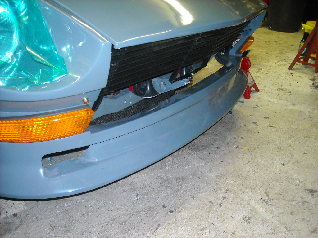

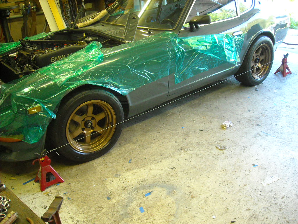

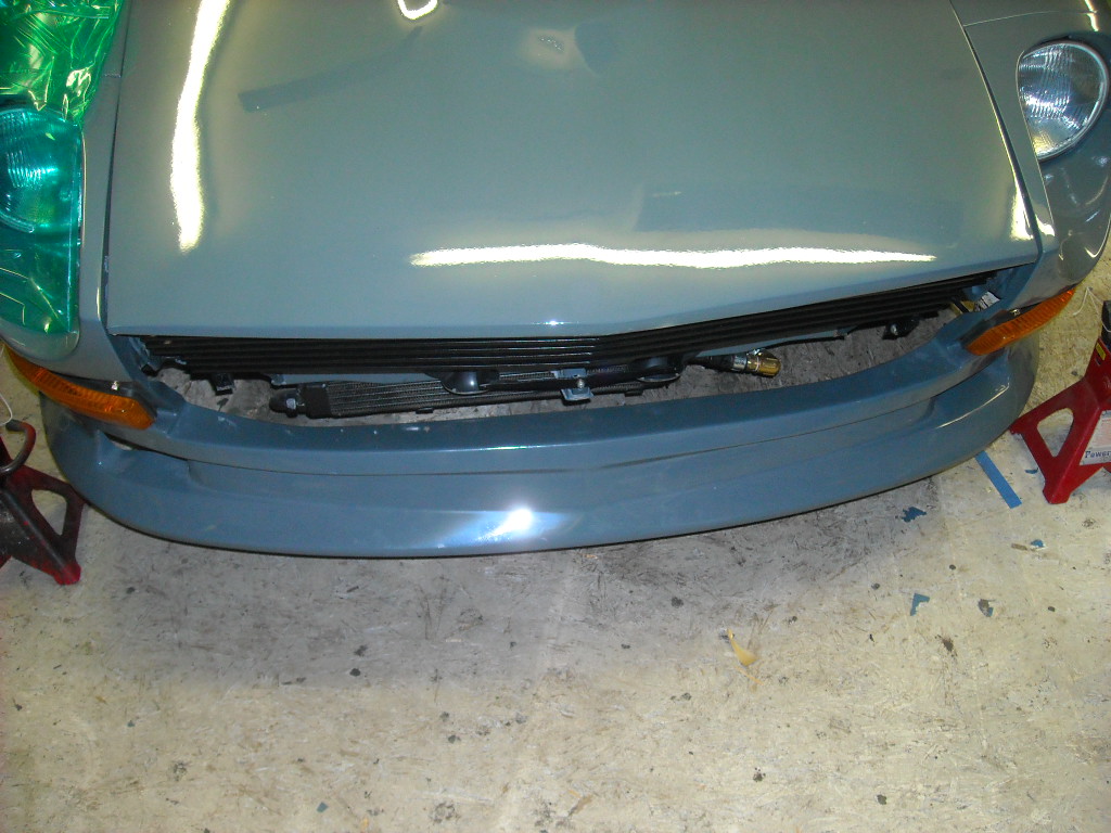

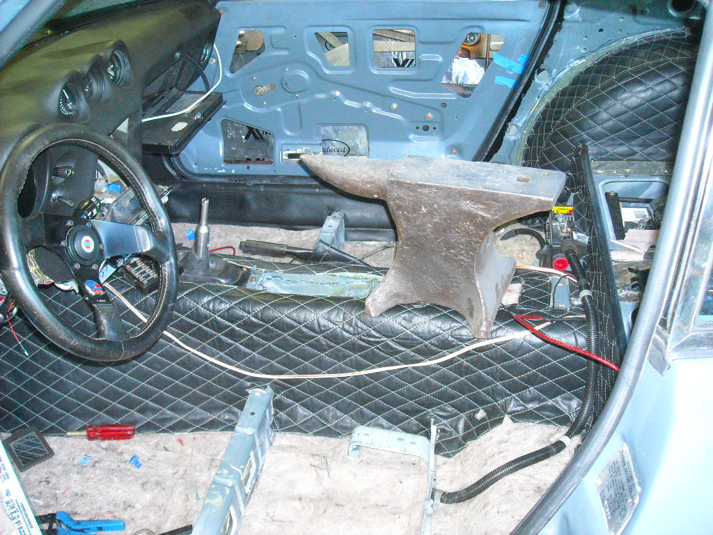

I loaded the anvil into the car to simulate all the stuff that still needs to be installed and got all the suspension bolts tightened up, the wheel alignment done, front sway bar in and the front air dam in, it still has that turned up nose look so I guess I will have to make up some kind of brace to give it a bit of a twist. It will need a brace anyway to keep high speed wind from bending it, not much strength to the urethane air dam.
So the D/S front wheel arch and both rear wheel arches measure at 25 7/8" the P/S front, because of the lean on the engine measures 25 5/8" I'm hoping that the weight of the driver will equal the front out a little more. That is with Illumina shocks, Eibach lowing springs AND 3/4" urethane spacers on the top of the rear springs. Something definitely off about Eibach rear springs.
That stitched leather looks really great!
Looking at all of the soundproofing you have in there, it's going to almost be as quiet as a modern car inside I bet.   Are you going with a molded carpet kit as well?
Love those mirrors too!
I made a centre support for mine, but made it so it could bend if the air dam touch one of our dutch traffic calming devices (speed bumps). Hazmatt made a nice set for his. Looked really neat and tidy.
Funny you mention that about the Ebach springs. I was talking to fellow Z guy here that had the same problem. I told him to buy a set of the 280Z tops. They will add 25mm to the height. I don't know what he did, haven't spoken to him since and his e-mail address doesn't work anymore.
