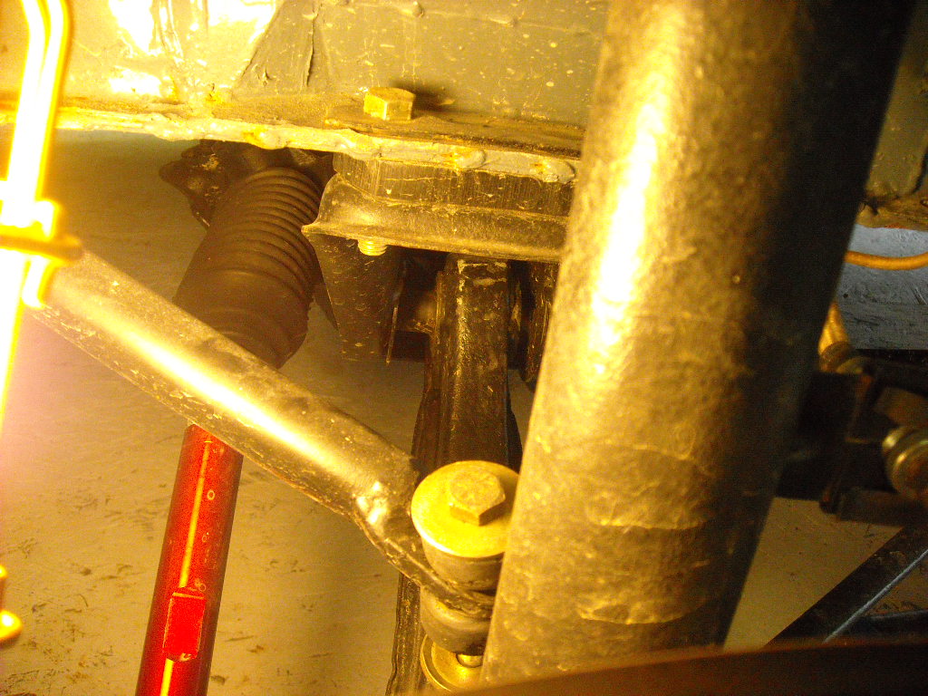

July 28, 20177 yr Author comment_526882 So how is this for a rookie move? No wonder the car is a little squirrely at high speed! Can't find anyone else to take the blame But driving with lower control arms reversed feels pretty normal up until about 60 mph then it just gets worst from there all the way up. I thought the problem was that I needed more downforce but it didn't help much when I added some, then I started looking at alignment again and was getting ready to install the g-force off set bushing kit when I noticed my rookie mistake. So I reversed the LCA's and installed the rear spoiler and now I can drive fast again and not smell the exhaust. Link to comment https://www.classiczcars.com/forums/topic/50240-thinking-about-installing-an-bmw-m6-engine-in-my-z/?&page=44#findComment-526882 Share on other sites More sharing options...
July 28, 20177 yr comment_526883 I love it. I make similar mistakes too! You passed the human test... Link to comment https://www.classiczcars.com/forums/topic/50240-thinking-about-installing-an-bmw-m6-engine-in-my-z/?&page=44#findComment-526883 Share on other sites More sharing options...
July 29, 20177 yr comment_526925 So they didn't pick up on that while on the alignment rack? You could probably adjust that out for toe, but everything else would be out of whack, right? Link to comment https://www.classiczcars.com/forums/topic/50240-thinking-about-installing-an-bmw-m6-engine-in-my-z/?&page=44#findComment-526925 Share on other sites More sharing options...
July 30, 20177 yr Author comment_526985 10 hours ago, Captain Obvious said: So they didn't pick up on that while on the alignment rack? You could probably adjust that out for toe, but everything else would be out of whack, right? I haven't put it on an alignment rack yet I just did the toe in with jack stands and string and measured out from the rim of the wheel. There is so little that is adjustable I didn't think I would need it, but I'll take it to a real shop now and get some numbers. Link to comment https://www.classiczcars.com/forums/topic/50240-thinking-about-installing-an-bmw-m6-engine-in-my-z/?&page=44#findComment-526985 Share on other sites More sharing options...
July 30, 20177 yr comment_527006 I agree (in that there is so little that's adjustable), that I did mine myself too. And I didn't even bother with string and jack stands. I had new tires and just measured the distance between treads at fore and aft of the front tires. Here's my thought process... I can easily adjust the toe to something close to correct, and then I can then fiddle with the toe settings same on both sides until I get the steering wheel straight. After that, the car should go straight and the steering wheel should be positioned correctly. If the car handles well (which mine does), and the tire wear is acceptable and even (which mine is), I'm claiming victory. What this method does NOT do is make you aware of any issues like what you had done with the bushings or issues with the rear wheels. Those issues would show themselves in handling issues (like your squirrely feeling), or badly worn uneven tires. And the problem with counting on tire wear to illustrate an issue is that by the time you know, it's too late. So, I got lucky... My car drives straight, handles well, and the tires are wearing slowly and evenly. I don't know (or need to know) what's going on with the more complicated facets of the alignment. I don't know if my camber or caster is the same between sides. I don't know if my rear toes are the same. Doesn't matter. Might matter if I was driving on the track at the limits of handling, but I'm not. Goes straight, handles well, tires wear even and at a reasonable rate. Done. Link to comment https://www.classiczcars.com/forums/topic/50240-thinking-about-installing-an-bmw-m6-engine-in-my-z/?&page=44#findComment-527006 Share on other sites More sharing options...
