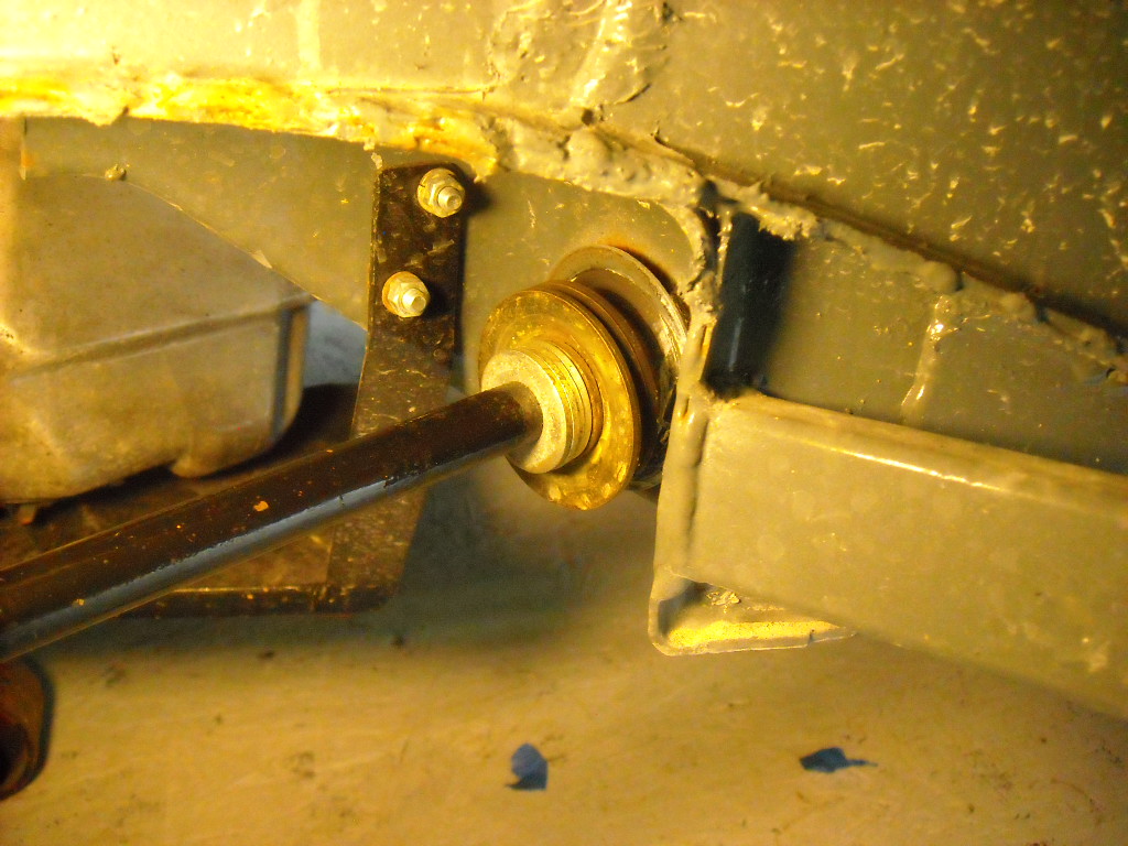

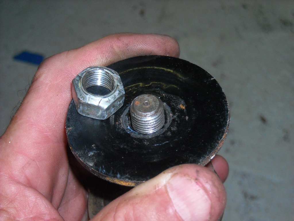

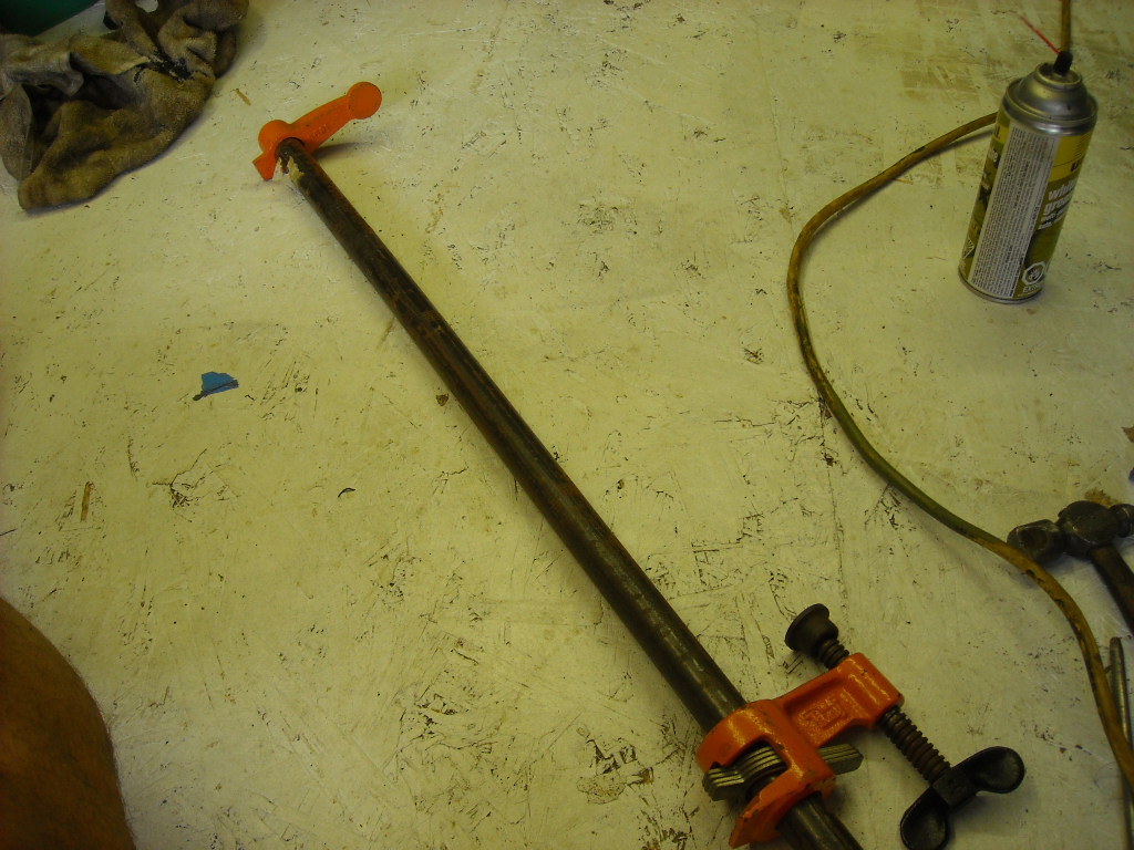

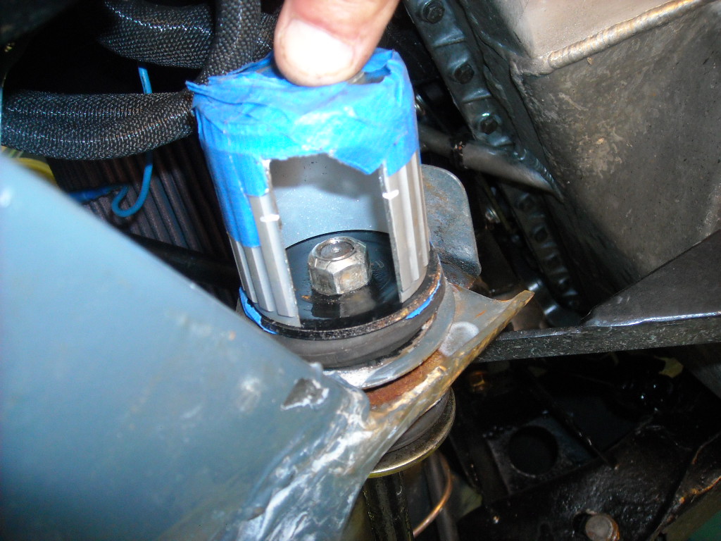

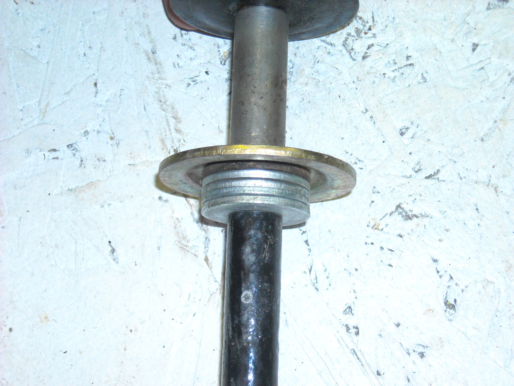

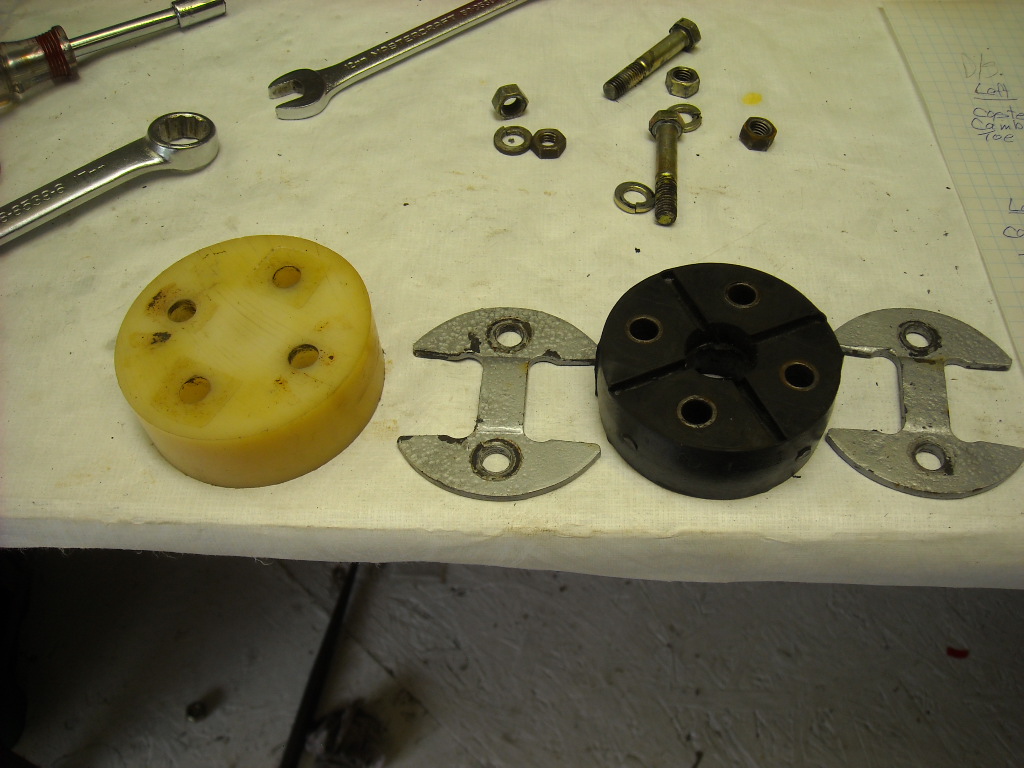

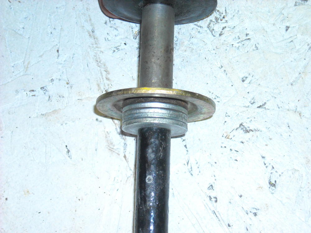

August 18, 20177 yr Author comment_528193 So here is .4" or 1 degree of washers on the T/C rod to move the left side strut out to about 3 degrees of caster, after installation the car handled well at high speed and felt predictable. Just enough thread left, Had to get creative to find enough room to get my fingers in there and start the nut down the threads, also had to get my biggest clamp out to squish the bushings enough. Thread locker was squirted on after the nut was torqued.Also changed out the original rubber steering joint for a solid nylon one, I'm ready for the track. Link to comment https://www.classiczcars.com/forums/topic/50240-thinking-about-installing-an-bmw-m6-engine-in-my-z/?&page=46#findComment-528193 Share on other sites More sharing options...

August 19, 20177 yr comment_528236 Agreed! Excellent! So was there a noticeable difference before and after the caster change? I know you have been hunting a couple gremlins. Did this take care of one of them? Link to comment https://www.classiczcars.com/forums/topic/50240-thinking-about-installing-an-bmw-m6-engine-in-my-z/?&page=46#findComment-528236 Share on other sites More sharing options...

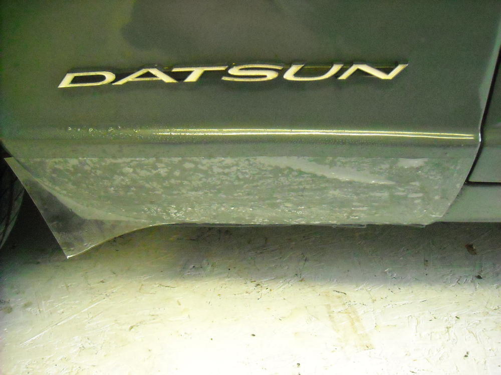

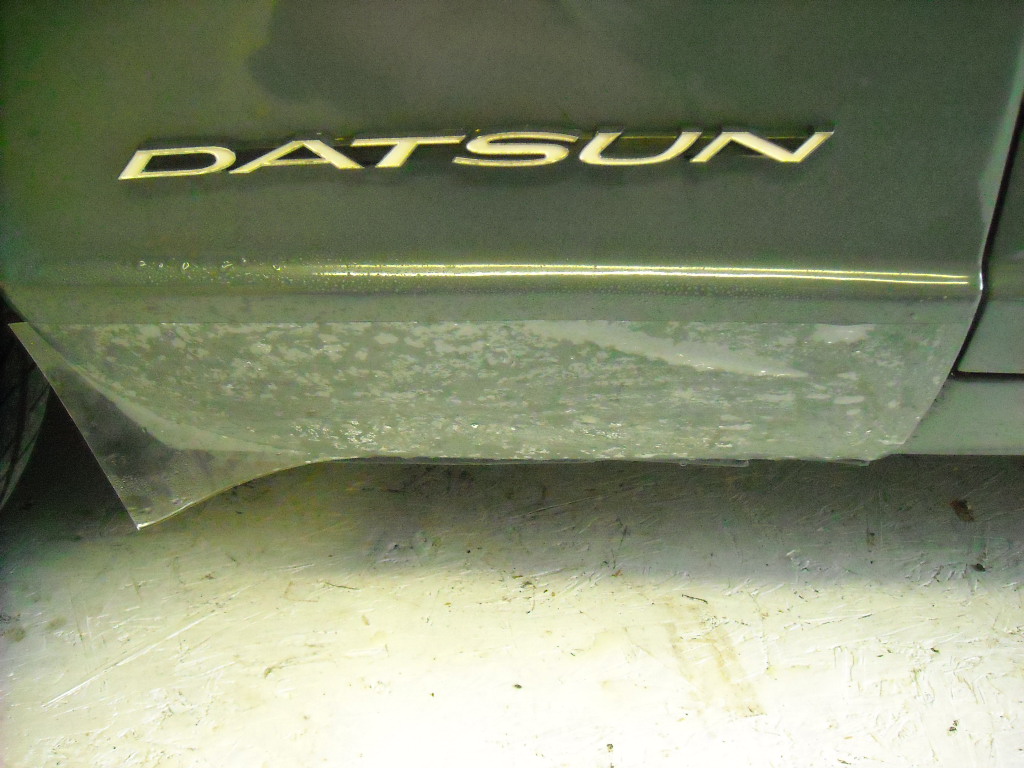

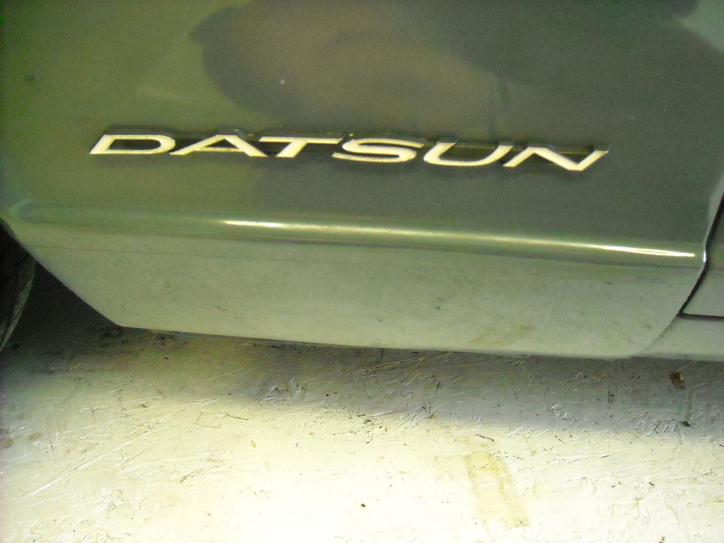

August 19, 20177 yr Author comment_528276 On 8/19/2017 at 2:11 PM, Captain Obvious said: Agreed! Excellent! So was there a noticeable difference before and after the caster change? I know you have been hunting a couple gremlins. Did this take care of one of them? There was a noticeable difference but I also did the nylon steering puck change at the same time as the caster change so when I did the next test drive all I could really perceive was "just a better feel." While I'm at the track tomorrow I'll try to find one of the older racers and see if he will take my car out for a lap or two and give me some feedback. Already have a few small scratches on the rockers from gravel being thrown up by the tires so applied some 3m protective film to the lower sections. Link to comment https://www.classiczcars.com/forums/topic/50240-thinking-about-installing-an-bmw-m6-engine-in-my-z/?&page=46#findComment-528276 Share on other sites More sharing options...
