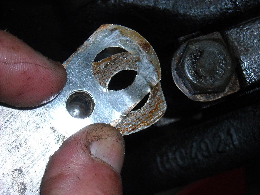

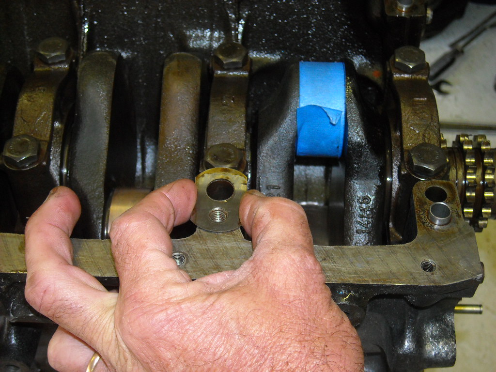

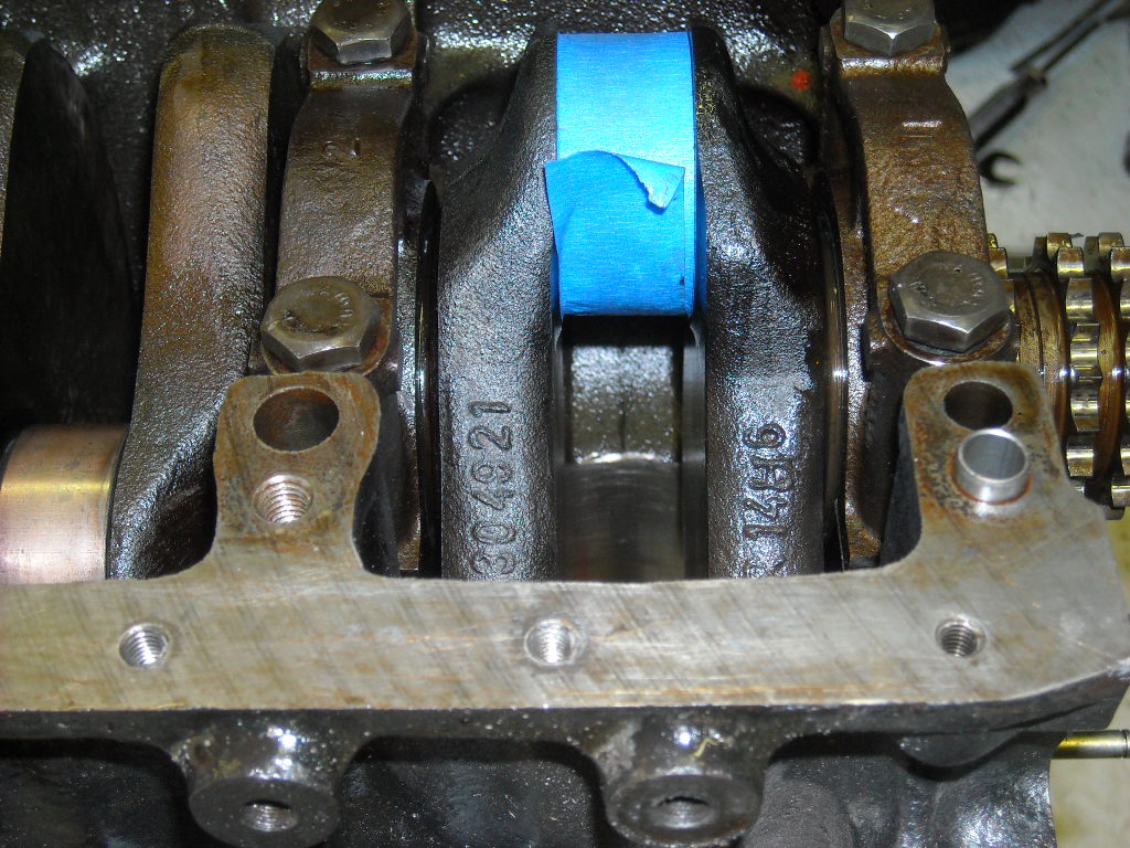

I figured out what was blocking the oil feeding the bearings, there is a thin metal shim/gasket that mounts between the block and the foot of the oil pump. The main oil feed flows through that foot, somehow the gasket shifted before being tightened down and blocked about half of the flow and even though the gauge showed good pressure there wasn't enough to protect the conrod bearings the way I was driving the car.  However there was enough oil to protect the cams, the valve guides and six of the seven main bearings. I hate when I have to say this but all the glory for this screw up falls completely on my shoulders, with the engine hanging from the the engine hoist I should have laid on my back to torque those bolts instead of on my knees with my head upside down, I just didn't notice it.

So that shim is supposed to just stay in place with no locator pin or pressed in boss or anything? Just pinched by the bolt nearby? I don't like it.
What's that shim's purpose? That's a gasket between the block and the oil pump?

The shims job is to adjust the the tension on the oil pump chain, new chain, new pump you only need one shim, a worn chain and pump you need to stack a few. Certainly not one of their best designs and I managed to find the worst possible position for it.
Got it. I did a little digging and found people on BMW forums talking about installing different thickness shims or multiples to adjust the tension. Really seems like an un-German "afterthought" design. Looks like they included a tensioning device in later years, but the early ones used shims?
And to design the system without interlocks or locating pins or something such that you can easily do exactly what you did. Just surprising. Could they at least have put the shims on other feet that don't have oil holes or do all the feet port oil? Certainly not poka-yoke. Haha! It's always easier to second-guess someone else's design decisions.
Anyway, glad you found a smoking gun. I would have never been comfortable with the engine ever again if I hadn't found something definitive. The guy with the Viper will be happy to see your rear again.   LOL
Cut the shim with two "ears" on the side and bend them over and you'll have a self-locating shim that will probably hold itself in place also.
Curious though, and just to be rigorous - are you sure that the mislocated shim reduced flow enough to cause the problem?  Often those big passages connect to smaller passages and can't flow that much anyway.  Probably doesn't matter since you're rebuilding, but sometimes the obvious thing isn't really what it seems.

I agree with you Capt.  ......if it were me, and I was going back with that shim, I'd super glue it down so it couldn't shift.....Creepy design.

Did you trace the oil passages to confirm the slipped shim could have put less oil in the from half of the motor vs the rear half and cause the burn pattern we see on the cylinder domes?
